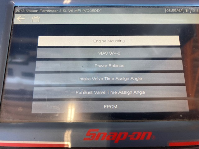

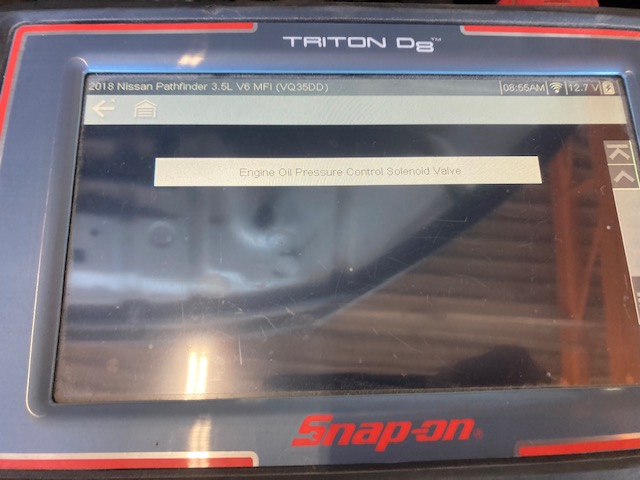

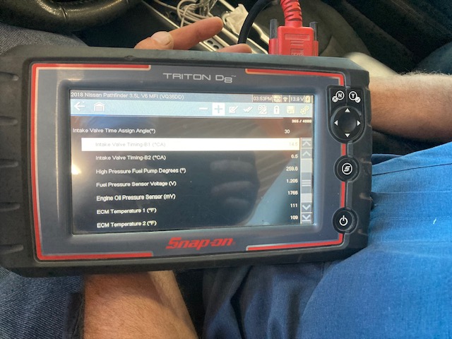

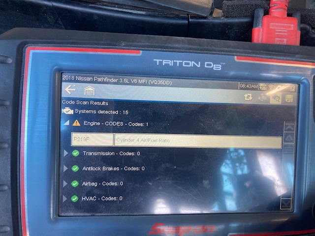

1 year 4 months ago #91944
by Peterpaul
Replied by Peterpaul on topic 2018 pathfinder with dtc p0021 &P219F
I added pictures
your right no crankshaft / cam shaft correlation.
Before I got started with the scanner data the only code that came back was:
P219F:cylinder 4 air/fuel /mixture ratio
I used the scanner and tried the following pids:
intake valve time assign angle 30
intake valve timing -B1 (degrees CA) 14.5
intake valve timing -B2 (degrees CA) 6.5
b2 degrees did not change
exhaust valve time assign angle
exhaust valve timing for B1 and b2 were the same.
I will get you degree numbers tomorrow.
Engine oil control solenoid on /off
commanded on and off with the KOEO
