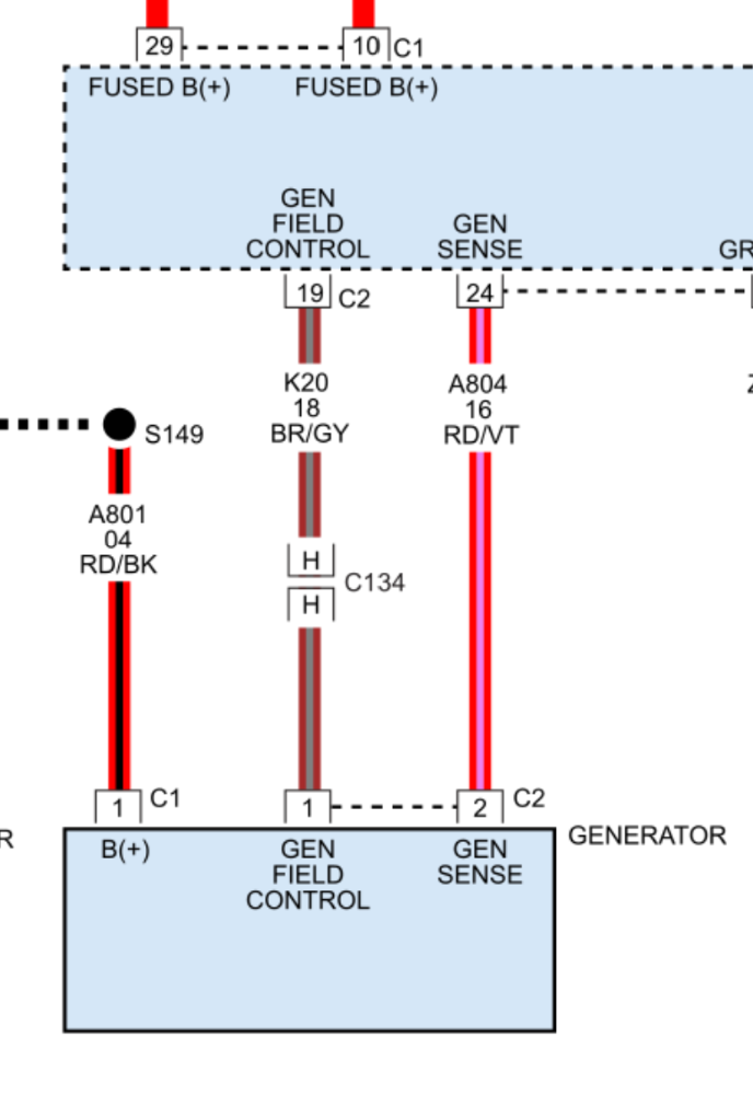

hey there,
So im having trouble with this van... and honestly im having serious doubts because i just ordered my bidirectional scan tool and it hasnt been delivered yet so everything so far has been done byway of fluke voltmeter and powerprobe. its a 2011 Chrysler town and country 3.6. customer called late stranded, her battery had run down, i went out had her towed, checked it that night and next morning and installed new battery and found that the alternator was not charging. so customer asked me to go ahead and just install the alternator because she needed the van...i installed as requested. still no charge. after brand new alternator and had them test prior to install and was good... after install of good alternator the alternator sense wire (red violet)wire is getting 9.34vdc but the battery side of alt is at 12.2vdc. and with test light on positive and i touch to the gen field control the (brown/grey)wire the test light illuminates constantly.... im so lost on this on... by all means this alternator should be full fielding.. so i took it down to my buddies shop with a snap on scanner and the pcm is ineed full fielding the alternator yet.. there is no charge at all. then today i foudn that if i unplug the alternator and test the voltage on the red/violet wire im getting 8.3VDC.... and when i test the same pin at the back of the alternator... i get no voltage drop.. its the same as the battery post and the battery positive of the alternator. but plug it back in and it goes back to the 8-9VDC. Can someone please explain to me how exactly this system should be tested  or what i may be missing. i have identifix... but it doesnt give me a good pinout diagram of the pcm. im just at a loss at this point. i would appreciate all input and help. thanks so much everyone!!!
Chris
1 year 4 months ago #91918 by Tyler
Sure! We can start out with the sense wire. This alternator setup uses what I've heard called a Kelvin sense circuit:
autoprollc.com/wp-content/uploads/2016/1...ulletin_July_web.pdf
It's counterintuitive, because the voltage on the sense wire will NEVER match B+. Even when the system is charging normally. So, when you're seeing 9.34V on the sense wire with B+ at 12.2V, that's (weirdly) normal. I wouldn't sweat the sense circuit for now.
Second, the field control circuit. Again, this setup is different from most, in that the field control circuit uses voltage supplied by the PCM to control field current. It's a power side switched driver, instead of ground side switched.
Testing the field control circuit with the test light connected to B+ unfortunately won't tell you much, other than the test light finding a ground through the field winding in the alternator. You need to switch up and connect your test light to B- and touch the field circuit to get an idea of what's going on. Have the engine idling and the system not charging while you do this.
Alternately, you could disconnect the alternator and jump B+ directly to the field control pin on the alternator. If you're now charging at 15+V, you can be confident that the alternator is capable of output. Obviously, take care not to short B+ to ground while doing this, and don't leave it full fielded forever. Just long enough to see charging voltage.

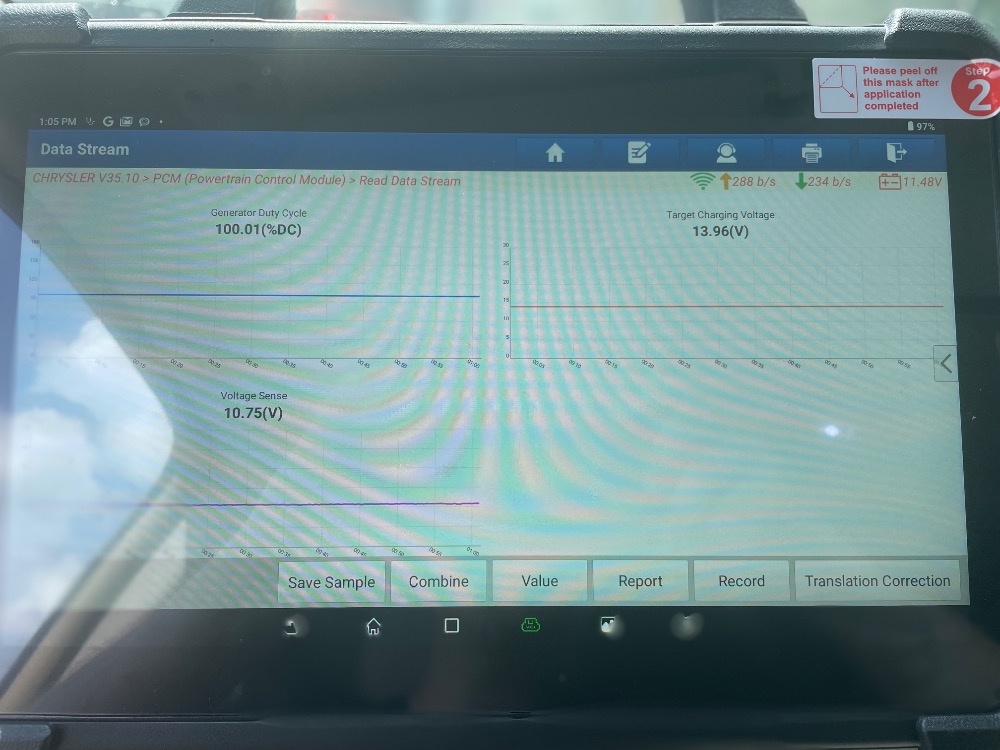

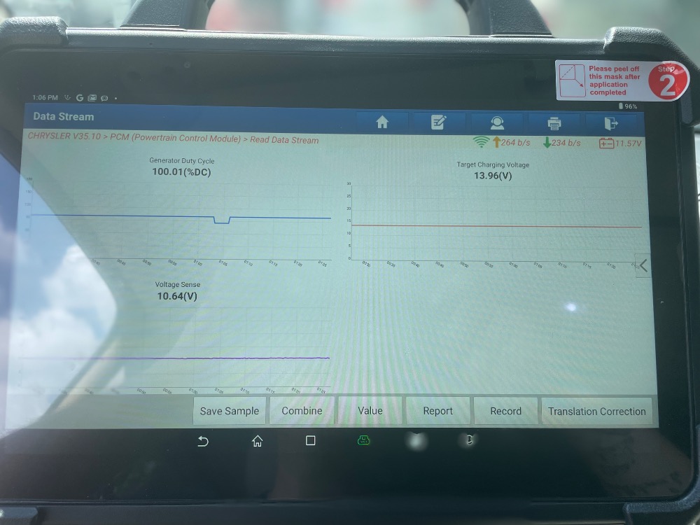

1 year 4 months ago - 1 year 4 months ago #91946 by hobbsautomotiverepair
Replied by hobbsautomotiverepair on topic 2011 Chrysler 3.6 alternator charging circuit
Ok so finally got my darned scan tool in and this is some live graphing from my scanner…will you please review and share with me your thoughts

1 year 4 months ago #91962 by Tyler
and heres my thoughts on this. My scan tool is reading desired voltage at 13.96vdc. and its reading generator field 100.1%. yet im still not charging. so by all means to me it looks as though the pcm is good... is it possible that its still not?
Absolutely, the PCM is still suspect.
The 100% field command PID shows that the PCM wants the alternator to charge. But that doesn't mean the PCM has the physical means to make it happen. Remember, the PCM must be able to supply current to the alternator on the field control circuit to get the alternator to charge. That field command PID will read 100% all day long even if the high side driver in the PCM is completely smoked.
That's why the test light test I suggested is important. Incandescent test light to B-, field command at 100%. The PCM should be able to light the bulb. If it can't, then either there's a wiring problem (which you've tested for), or there's a PCM problem.
