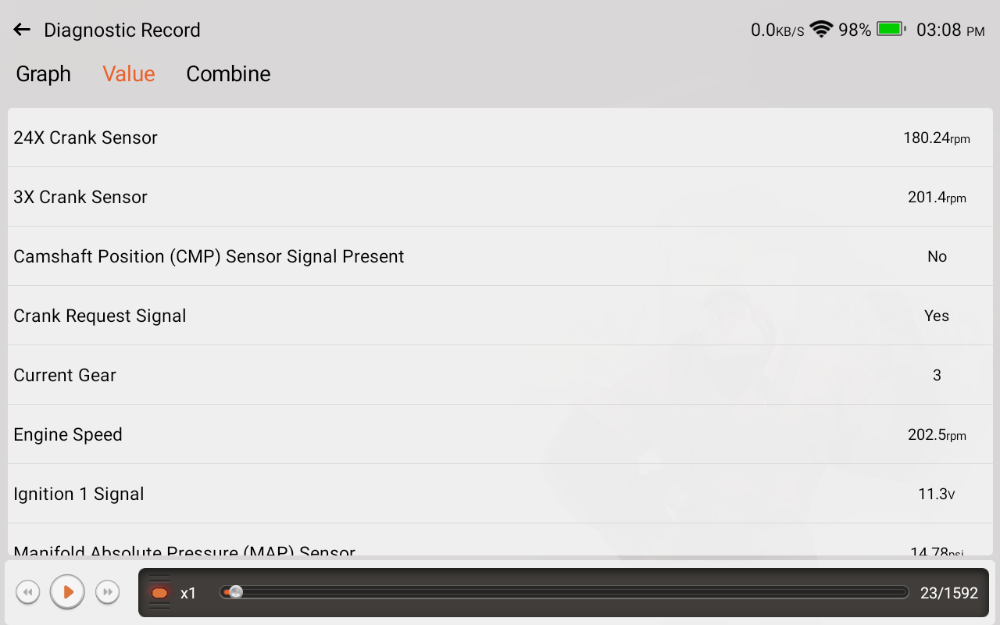

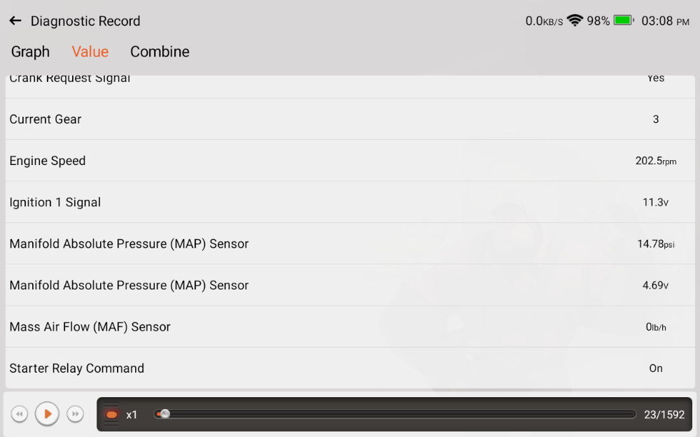

Going to start the thread with the scanner test that started me down this path.
Notice the Cam signal presence coming and going.
That's what started the journey.

This captured the one instant the cam signal was present and where I started.
More to follow if this loads..

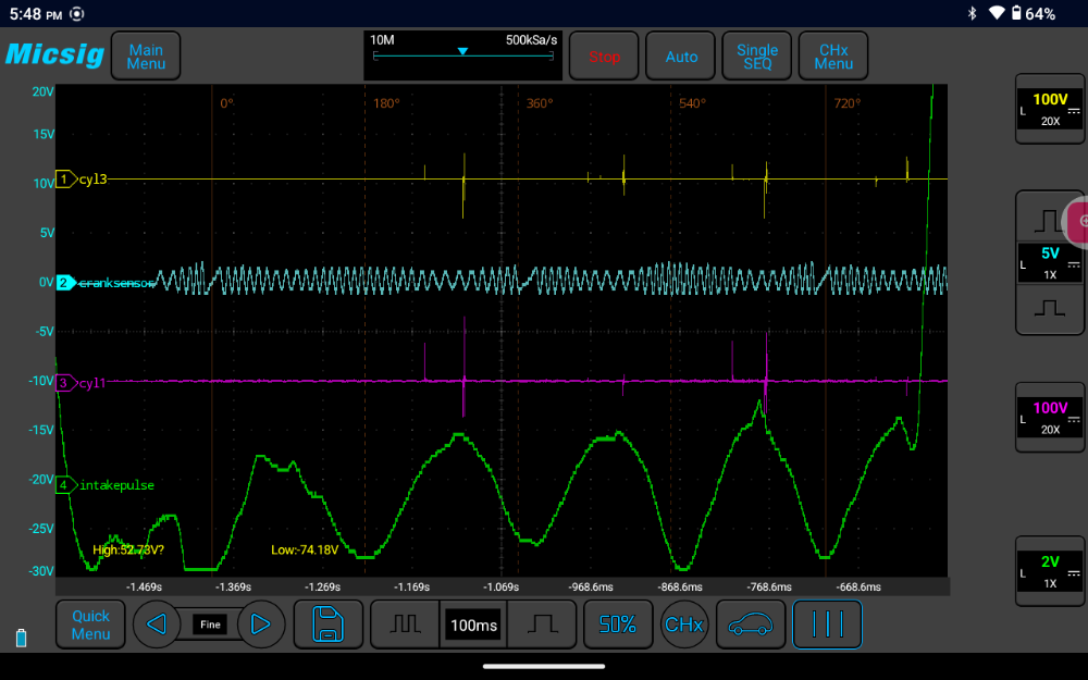

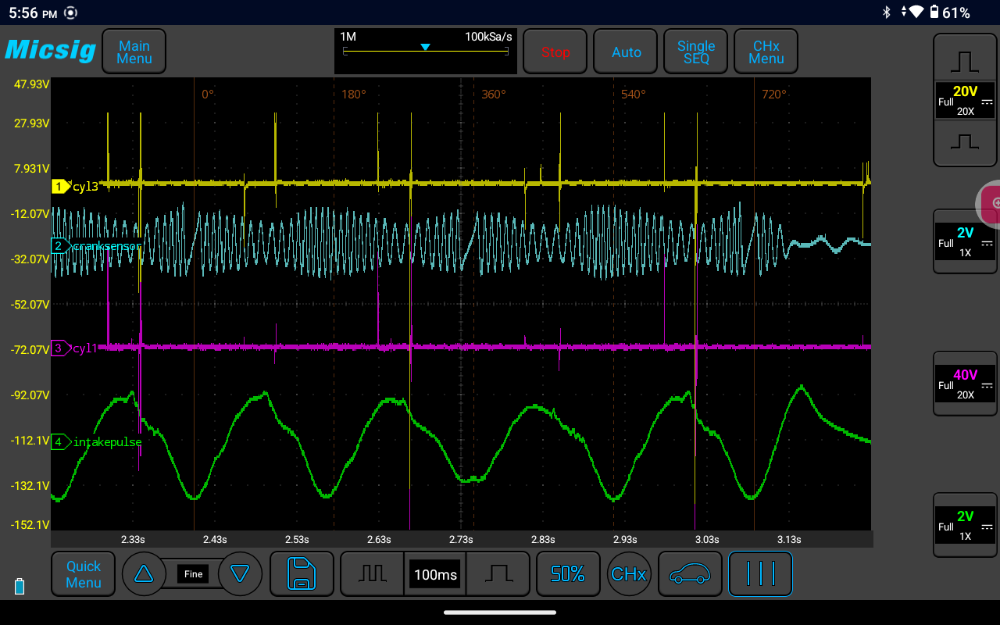

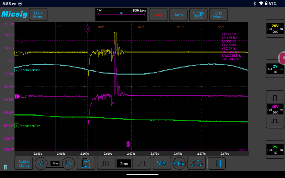

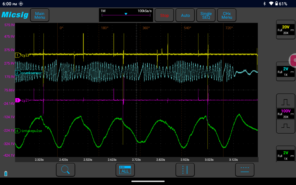

I took these in an effort to look at timing events and whether signal was present.
My main concern is the missing CMPSignal and whether the 3rd gear reading are somehow connected and preventing the ECU from completing the start condition needed.
Apologies for the strung out info. Getting info out of the 689 isn't that handy to navigate it seems.
Reports it generates.. yes, but data records not so much. Thus the screenshots of the timeline instead of the file itself.

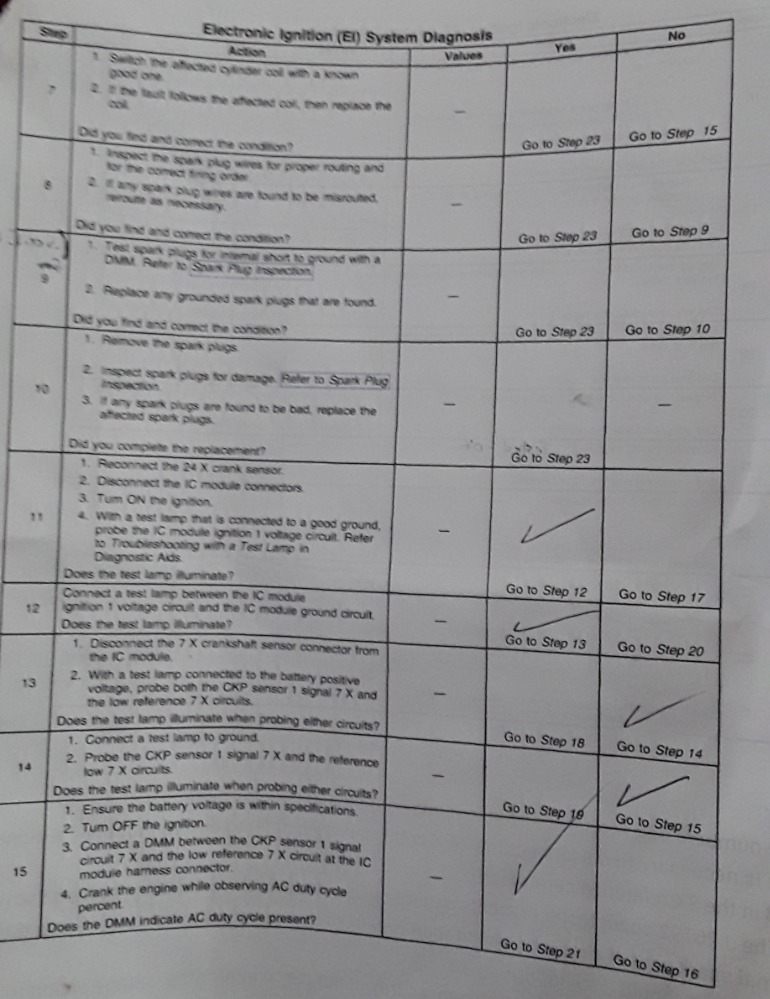

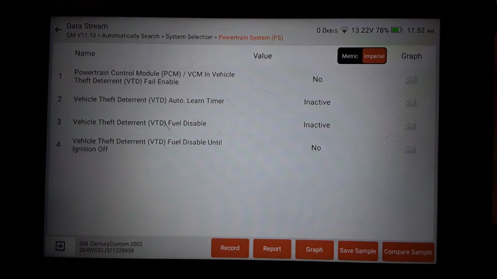

1 year 3 months ago #92006 by Tyler
Replied by Tyler on topic 2002 Buick Century 3.1 Cranks no start
That one start stall was the only true "start" its had and I did have a code for the theft fuel shut off but it was from having a fuse or relay removed. When replaced the codes went away.
Understood. Just to make certain, I'd suggest checking the 'VTD Fuel Disable' and/or 'PCM/VCM in VTD Fail Enable' PIDs in the PCM during the no start. They should show inactive.
I have more vids and even some PICO files available but rather than blindly loading them would prefer to respond to questions with them if applicable.
No worries, I actually have a couple questions about your captures. Where are you connected for your blue 'cranksensor' trace? I'm having trouble matching your capture against known goods. Everything I can find shows the 3.1L in the Century using a 24X hall effect and a 7X variable reluctance setup. Your crank signal doesn't match either.
I also only see four compression events in a complete engine cycle, going off the #3 ignition trace and (I think) two crank revolutions.

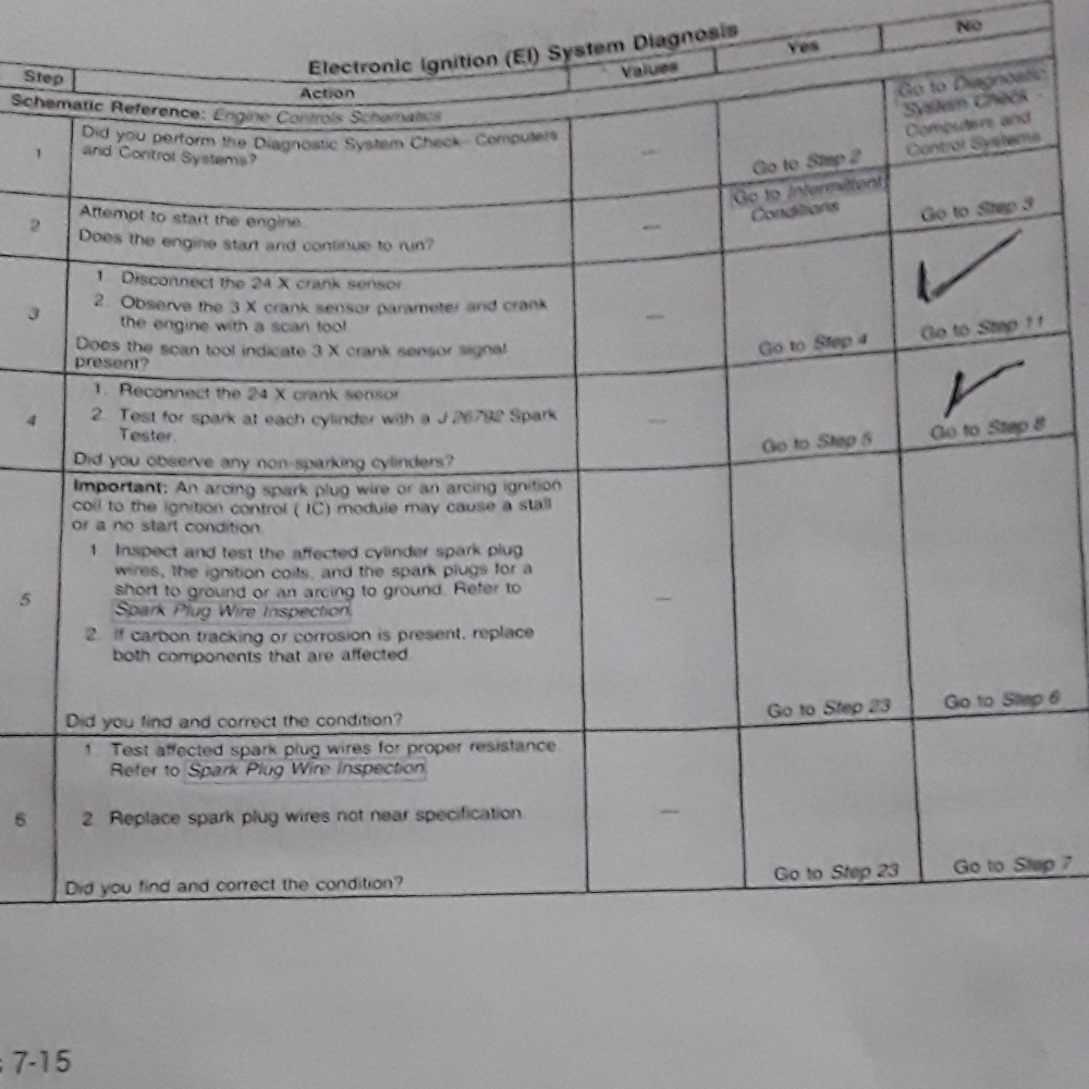

   More info...
AllDataDIY EI diagnostic test results were pretty much the same as the FSM diagnostic test.

" I actually have a couple questions about your captures. Where are you connected for your blue 'cranksensor' trace? I'm having trouble matching your capture against known goods. Everything I can find shows the 3.1L in the Century using a 24X hall effect and a 7X variable reluctance setup. Your crank signal doesn't match either."
On that capture I don't remember if I was on the sensors, connector or back pinning the ECU. I'm thinking the ECU.  I've tried them all at one point or another.
The 7x is converted to the 3x tho I'm not sure if it's by the ECU or the ICM.
The timing is the question.. at one point it sounded like there was water in the cylinder and cranking against it self.
It was awful sounding.
Since then new spark plugs were installed after it was compression tested. 195psi across the board.
The old plugs were fouled.

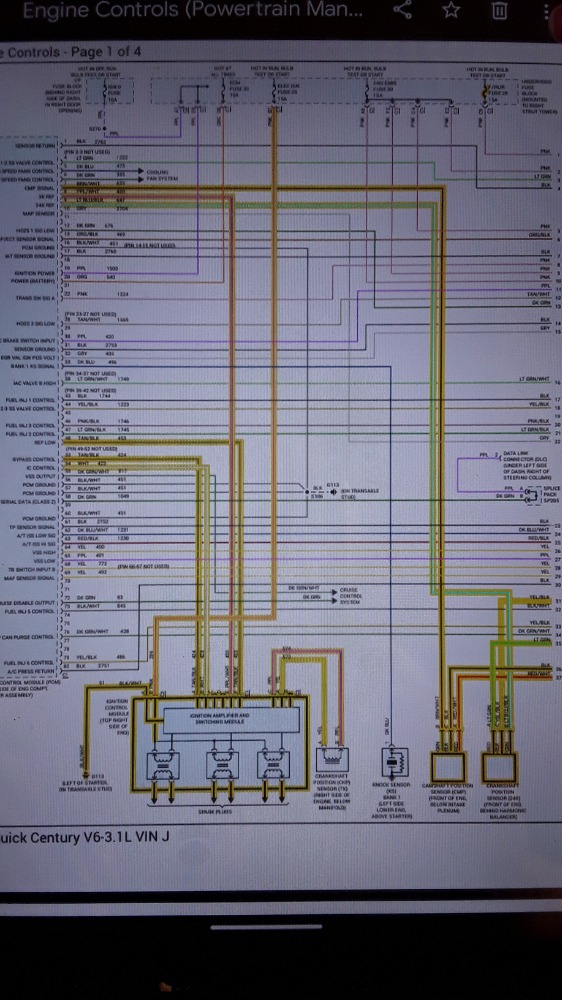

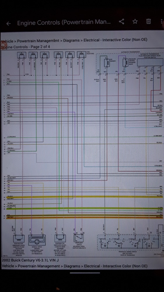

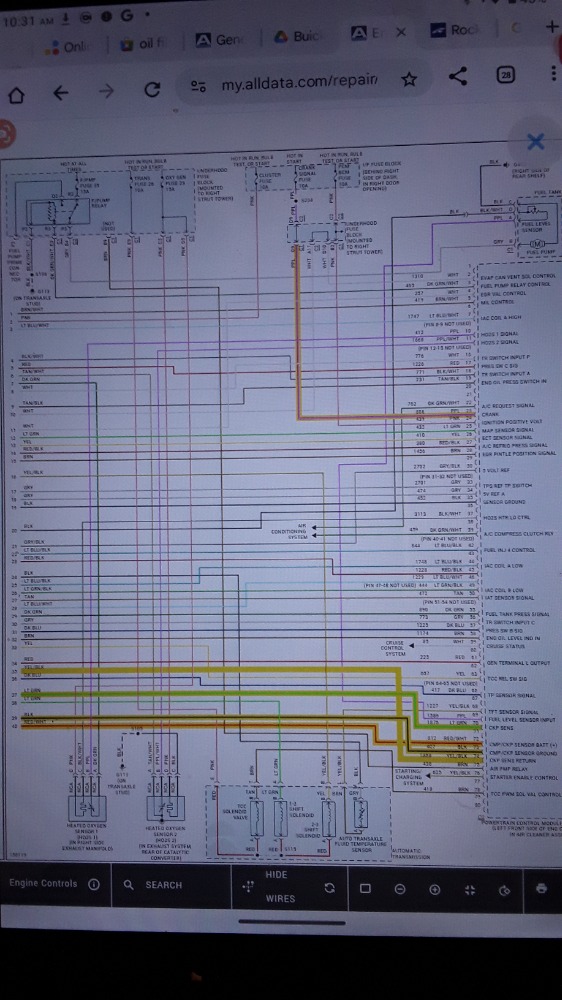

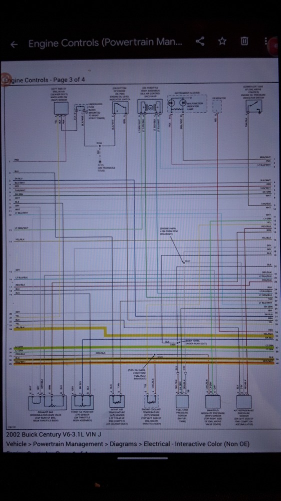

I'll work on getting the Schematics to refer to but the PDF isn't allowed for some reason and the photos are too blurry to read.
  • StepSide88
  • StepSide88's Avatar Topic Author
1 year 3 months ago #92009 by StepSide88
Replied by StepSide88 on topic 2002 Buick Century 3.1 Cranks no start
Schematics.
The VTD and PCM pids requested
If you were looking at the 360* lines I was just experimenting with the MicSig  at that point and more than anything else looking for signal verification on the circuit

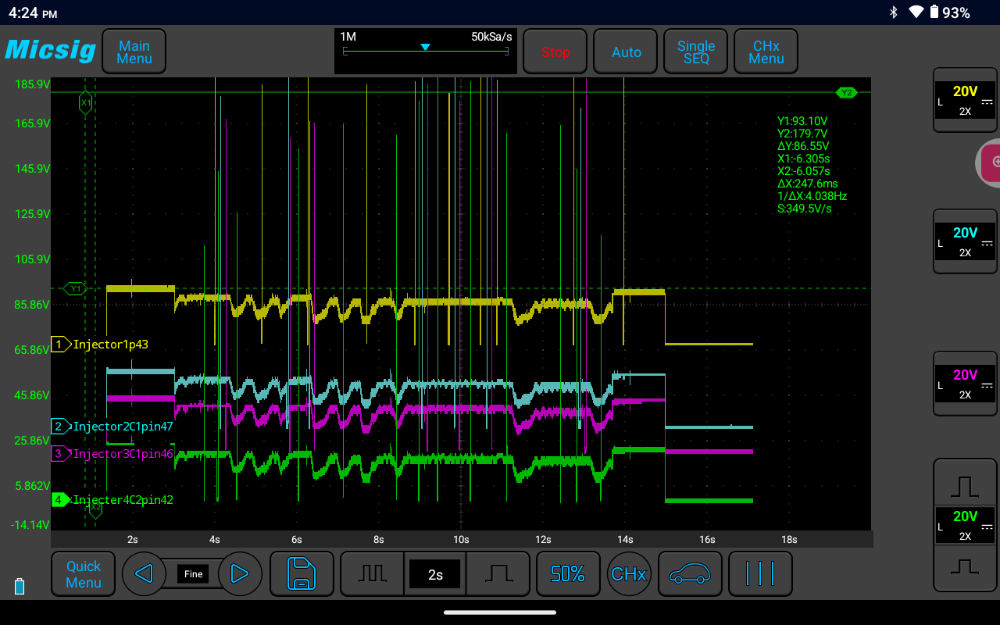

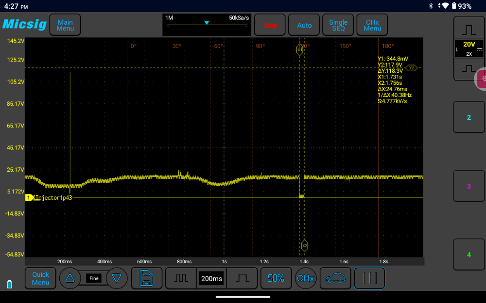

Ok here's how things sit
Still no codes.
Compression 195+/-
New fuel filter installed and most of the old gas in the tank drained while I was at it.
Fuel pressure 55psi when commanded on then drops to 50psi and holds after the 2 second run time

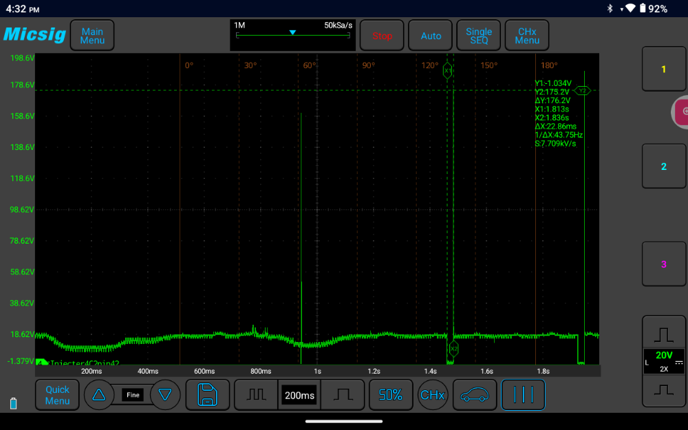

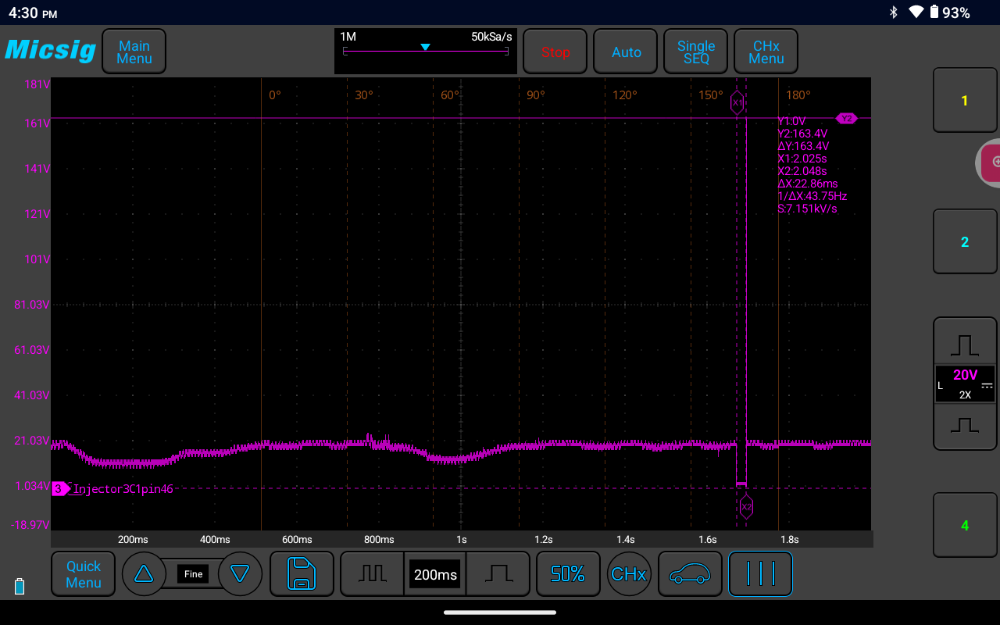

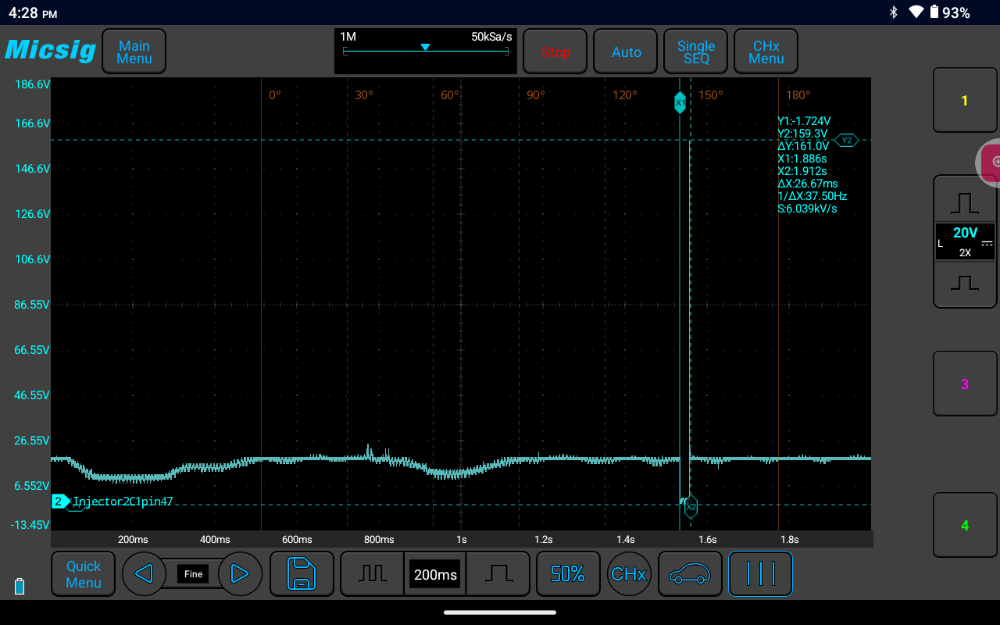

I pulled a plug and thought it looked dry so wanted to check the injectors but they are not* easy to access so went with back pins at the ECU.
I labeled the channels and took screenshots of the measurements of each channel isolated as well as including a combined shot catching the sequence
At different times during testing today the engine turned over and sounded perfectly normal except for not firing then other times it sounds like crap like timing or plug wires are all mixed up.. that is evident on one of the combined screenshots (if I get it sorted out and posted notice the color order is way messed up.)
Any suggestions for what else to check would be greatly appreciated

1 year 3 months ago #92046 by StepSide88
That was milling around my brain last night but I had the intake 3/4 of the way off in order to check the injectors for flow before I realized that the antifreeze needed to be drained and other assorted stuff removed first and called a halt to that for the day.
After thinking about it I decided that checking flow was unnecessary so this AM put it back together but after watching a Trained By Techs YT vid about rechecking the basics decided to rechecked the plug wires and coils and found the problem there.🤦
Fired right up.
