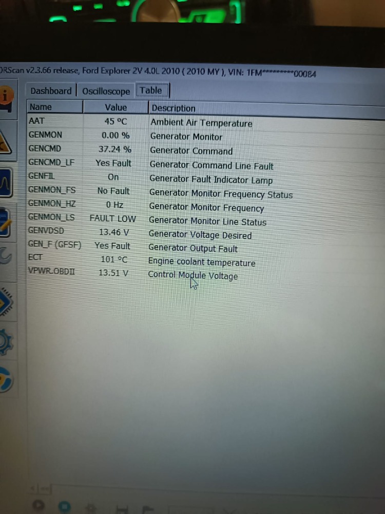

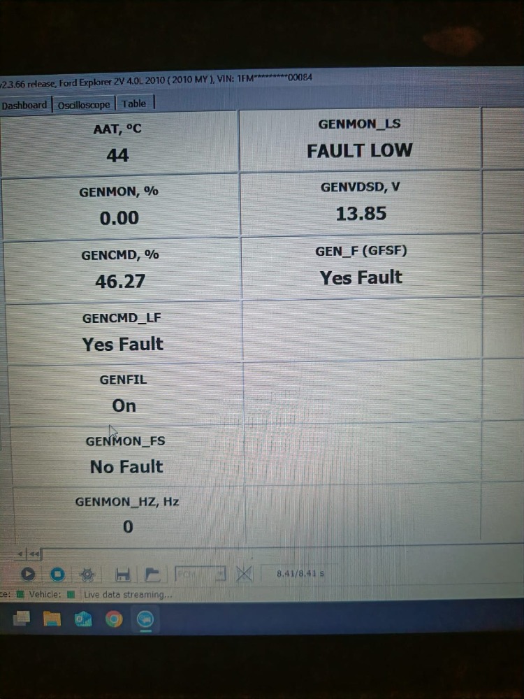

I would like your help in pinpointing exact issue for the charging system for my ford explorer 2010 4.0l with new battery,
the battery light comes on every 10 mins and sets off P0620 code.
attached is the PID for all alternator related PIDs.
New PCM, New Battery
Could this be a bad alternator regulator? or the wiring ?
Kindly help in this matter.

From your captures, it looks like GENMON is low all the time. That could be wiring, or an alternator. You'll need to do some pinpoint checks to tell.
Engine running, disconnect the alternator connector. There's three wires. Violet, blue/orange and red. What's the voltage on each? Report back and we can test further.

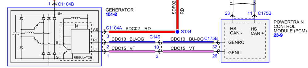

Perfect, thank you! I agree, I think the blue/orange (GENCOM) is shorted to voltage somewhere.
I'm also concerned about the violet (GENMON) for a different reason. GENMON isn't shorted to voltage, but also isn't getting pulsed to ground by the alternator. We can circle back around to that.

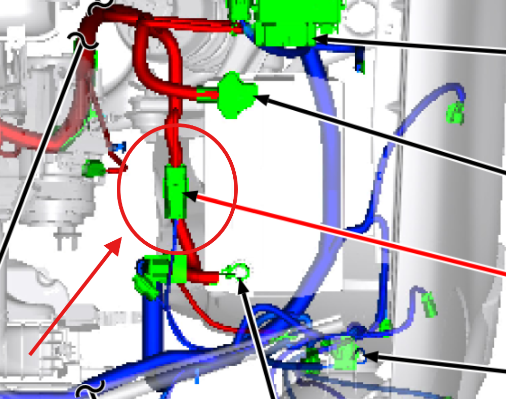

According to the diagram, there's one connector in between the PCM and the alternator. C146.
It's right in front of the battery on the drivers side:
Disconnect it and recheck voltages at the alternator connector. If blue/orange is now zero, the problem is on the PCM side of C146. If there's still B+, the problem is on the alternator side of C146.

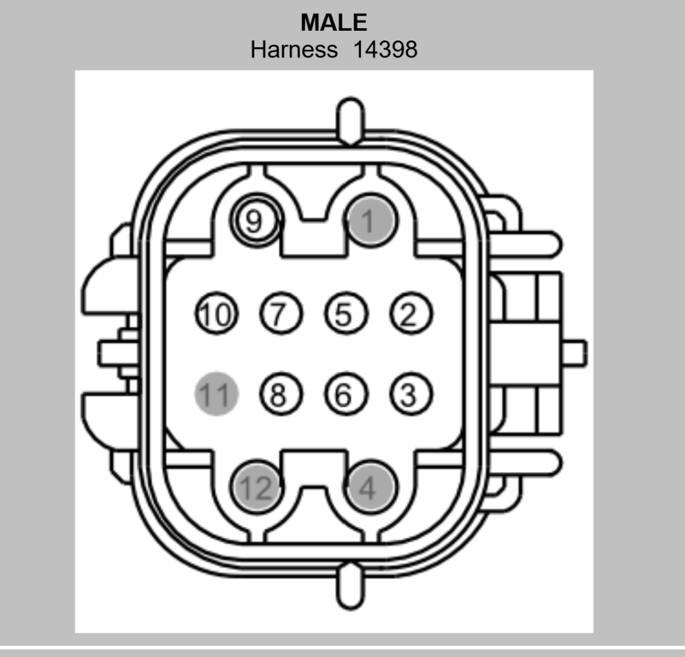

1 year 2 months ago #92082
I think I'm thinking of that right? Blue/orange should have less than 1.0V on both sides of C146, key on. This connector, pin #10, right?
