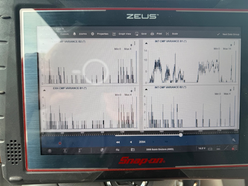

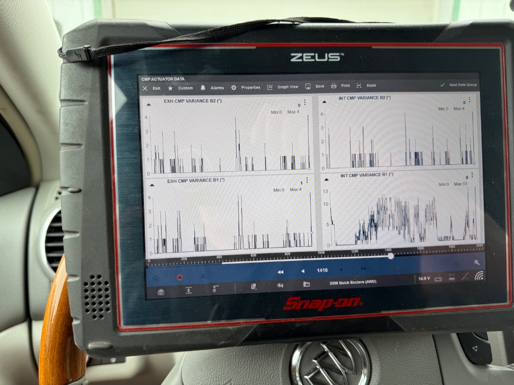

I put new cloyes timing chains on this 3.6 engine I had a p0019 and p0011 and c0561 before I did the job the variance was all over before I did job now only on the bank 1 intake cam as pictures show I am still getting the p0011 and the C0561 codes any help would be much appreciated

P0011 is a performance code. Make sure that the engine oil is clean and full. Make sure that your VVT solenoid screen is clean. Use your scan tool to command and monitor cam advancement. You should be able to command the cam to advance about 25°, (SI says 27°). Does the actual cam angle, promptly, move when commanded? If not, check the resistance of the solenoid. It should be somewhere in the range of 6-10Ω. Make sure that the solenoid has a ground and PWM 12V when being commanded. If you have an amp clamp, you can capture a current ramp of the solenoid to test for an open or short.

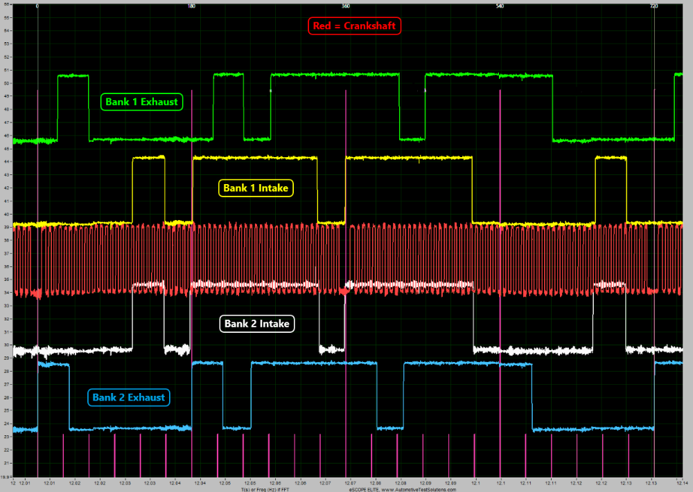

To ensure that the chains were installed correctly, disconnect the VVT solenoids and capture Cam/Crank correlation. Compare it to this known good.

The cam does advance it actually advances 3 degrees higher then the intake cam on bank 2 I did the bank 2 intake cam to compare the 2

Chad thank you I feel pretty stupid I relearned the crank/cam and that was my problem.
