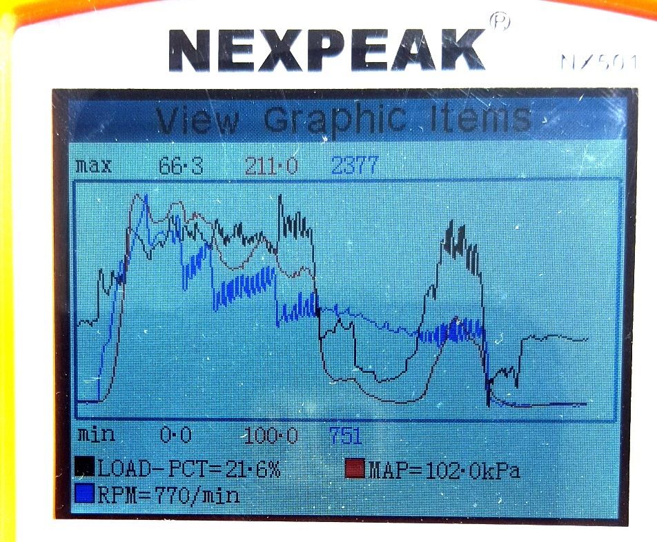

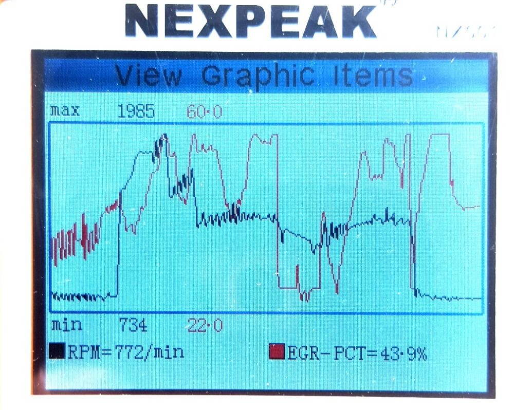

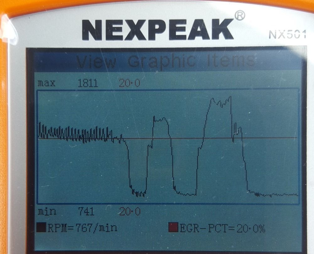

3.2l Ford ranger P5AT direct injection turbo engine.
At around 50km/hr and 70-80km/hr the revs bounce about twice per second , only about 100 rpm like from 1500-1600-1500-1600rpm.
This only happens under light load especially from 70km/hr to 80km/hr.
I watched the graphs for EGR and revs and saw they were similar and unplugged the EGR to make sure - but it still does it with no EGR
command so not caused by the EGR. I smoke tested the intake and there were no leaks.
Fuel rail pressure shows the same bumps as revs - I'm not sure if there should be such a response in rail pressure or if it is actually causing the
problem?

Thanks for the replies - this morning the transmission made a bit of a 'clunk' when I took off for a test drive so I took it in to the transmission shop and we went for a drive while he monitored live data - apparently the torque converter is slipping.
Regarding the fuel rail pressure - yesterday I monitored "desired" vs "actual" and it was spot on. What was interesting is that on my budget Nexpeak NX501 I could see the revs and fuel rail pressure pulsing in time with each other but the Snap-on Solus and Autel Maxisys both smooth them out.
Looks like this 3 year old vehicle needs another transmission (at 164000km)
