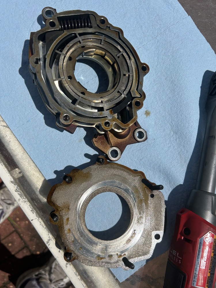

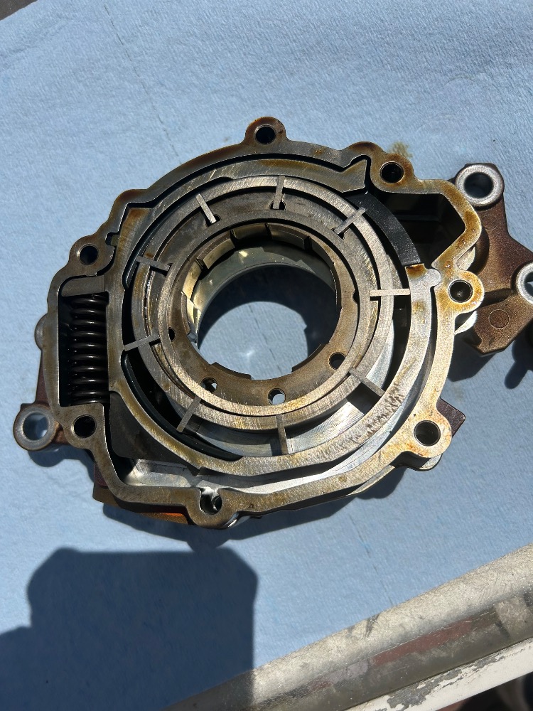

I have a 2008 Tahoe Hybrid with the 6.0L vortec LFA engine VIN code 5. It has about 130,000 miles on it and I am replacing the timing set. Since this is my wife’s vehicle, I’m also replacing many parts that commonly wear out while I have the front timing cover and oil pan removed. After removing the original oil pump and pick up tube, I disassembled the oil pump to check for wear and found, what I would consider, moderate wear (typical for 130,000 miles) and made the decision to replace it. The issue I have run into is finding a replacement oil pump or any kind of “work around” to use an oil pump from another application but after LOTS of research and looking I have found that this particular oil pump is no longer available from anyone and, as far as I can tell, there is no alternate oil pump that will work for my wife’s vehicle.
the GM part number is 12625823
It is a vane type, variable displacement oil pump that was designed and used with the hybrid vehicle and the “typical” gear displacement type of oil pump made for non-hybrid versions of that vehicle can not be used. The GM 12625823 oil pump was only used on the hybrid version for the year 2008. The 2009 hybrid version of the Tahoe uses a slightly different oil pump of the same design but cannot be interchanged with the 2008 part. Not to mention that oil pump is also not available. Starting in 2010 the hybrid Tahoe went to a solenoid controlled variable displacement oil pump which is much larger and has the solenoid built into the pump with a connector that goes through the timing cover so that’s not a viable alternative. I even contacted Melling to see if they have an aftermarket option for this oil pump and they do not. They have oil pumps for the 08 Tahoe but as soon as you specify that it’s the RPO code LFA engine / VIN engine code 5, they do not make anything that would work.

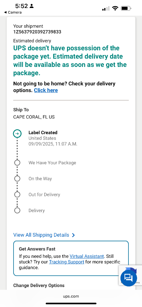

Well, I know I’m just expecting the worse given how things have gone with this oil pump, but I’m starting to get nervous. The tracking number has been active for two days now and so far it still says they have yet to receive the package. I really hope this one actually exists and will get to me but I’ll keep the post updated.

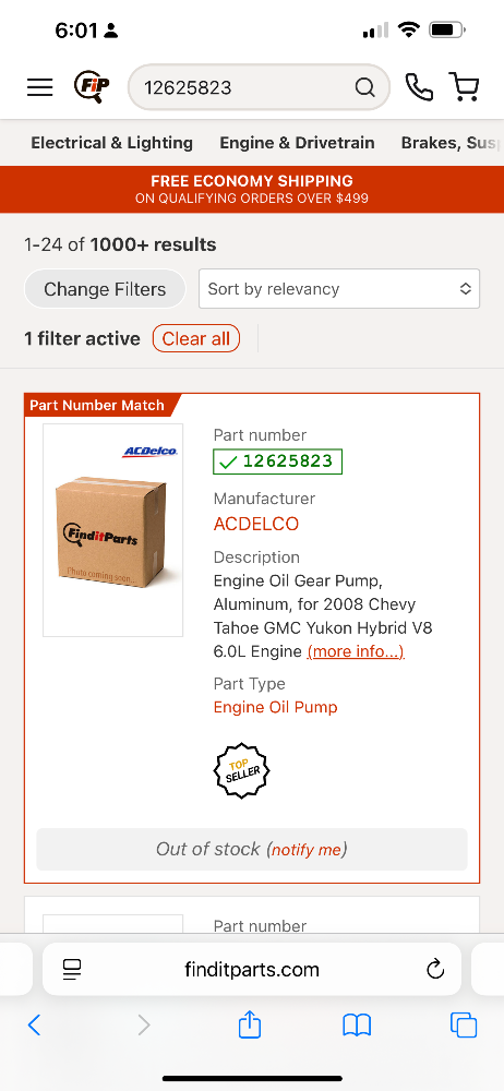

Damn, now when I search that sight for that part number, it says out of stock. I have a bad feeling that this is going to be another cancellation and refund.

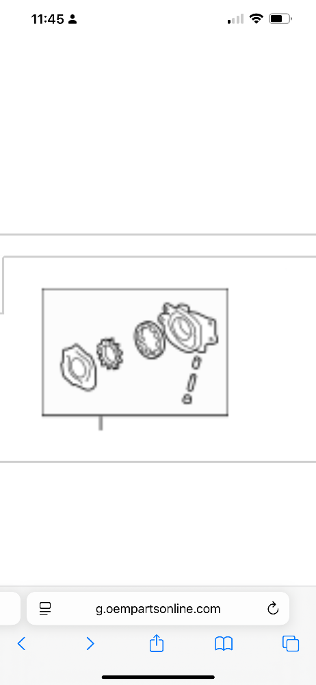

Well, it’s now Saturday and the tracking number still says that UPS is waiting to receive the package. The office for FinditParts is closed on the weekend so if the tracking information still hasn’t updated by Monday, I’ll call them again. I have a very strong feeling it’s going to be another canceled order. I have never tried to upload a video on this site but I have a short video showing the pump and its internal parts. I’m including a diagram from GM to show what the normal gear rotor displacement internals look like as opposed to what is inside my oil pump. Hope this works.

Never mind, it apparently won’t work because it’s an MOV file and I have no idea how to convert it. Sorry, I was hoping to show what my pump looks like inside for anyone interested. Here are some pictures instead.

Well, I’m glad that I didn’t tell my wife that I may have found an oil pump for her truck. It’s not final yet, they haven’t canceled the order and refunded my money yet but it’s just a matter of time. I received an email from FinditParts on Monday which said:
We’re now able to update the status of your order, number F105308027, with the following tracking number: 1Z5637920392739833. If you have any questions about the new status of your order, you can reply to this email or call (888) 312-8812, and refer to Case Number: 00901960
but when I checked the tracking number, it still says UPS hasn’t yet received the package the same as it has since last week. I contacted FinditParts again to check on it and was told they would look into it and email me with an update but nothing yet. Unfortunately, now when you check FinditParts website for the AC Delco 12625823, it no longer shows up at all.
If anyone knows someone on this forum or any other forum that might have a lead on, or better yet, one sitting on a shelf somewhere I would greatly appreciate it. It can be under GM part # 12625823 or AC Delco part # 12625823. If someone has a new one or has a line on a new one, I’ll be more than happy to pay for it plus any additional shipping to get it from wherever it is to me.
