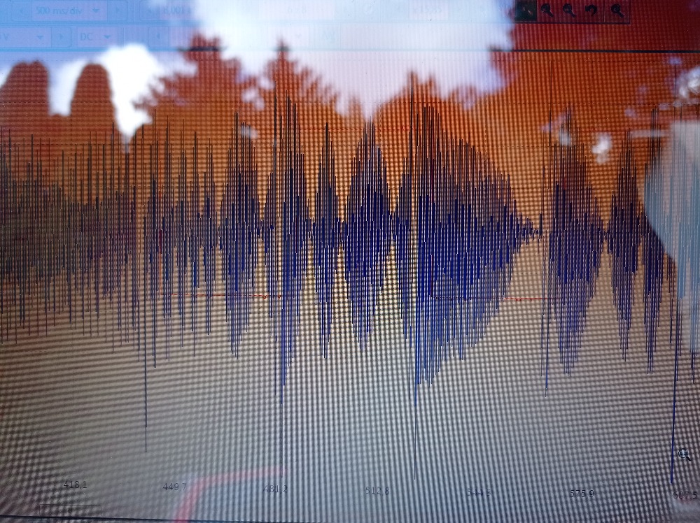

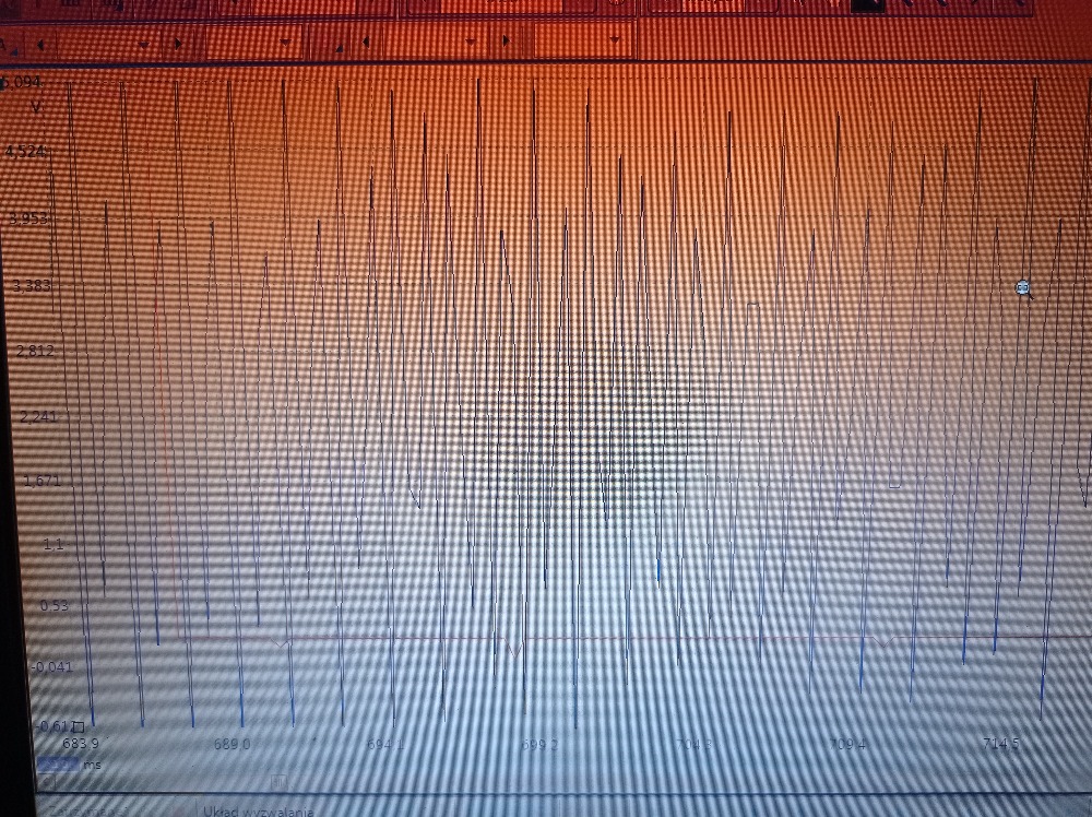

11 months 2 weeks ago - 11 months 2 weeks ago #92249
by Farseer
Replied by Farseer on topic Saab 93 1.8 backfire only on startup
Based on this waveform, I changed the VR type crank sensor.
Think that solves it?
Absolutely not.
The flywheel looked fine, but a flywheel problem would produce a similar effect all the time.
P.S. what would cause the VR sensor to sometimes produce a small "swing" as in the attached photo? I know zooming in on a picoscope can make you overanalyze things, but still. It looks as if it was struggling to produce V sometimes.
Unless those are the backfire events.

11 months 2 weeks ago #92251
Replied by Noah on topic Saab 93 1.8 backfire only on startup
Ouch! Don't love SAAB, always a headache for me... I may not v
Be much help on this one, but didn't want to leave you hanging.
What year is this thing? I read the whole post thinking it was a 1993, lol.
I think you covered most of the bases, popping through the intake is usually lean or timing. How's fuel quality?
Hard to see the scope set up, but changes in amplitude and frequency on a VR type sensor usually are the result of changing speed of the trigger wheel. Are these captures during the back fire?

11 months 2 weeks ago #92252
by Farseer
Ah, Noah, thank you for stopping by, This car is driving me insane, especially that it's a NA, no VVT, as simple as it gets engine.
It's from the early 2000s, I'd I'm not mistaken. I dislike working on Saabs as well!
Yes, the scope capture isn't the best, and Im actually certain those changes are caused by the backfiring... Which is why changing the sensor made no affect.
So timing or lean? Timing was verified, it's spot on and belt driven, so no slacking like with a hydraulic tensioner.
Fuel quality? I think it's fine, good idea, but it drives fine.
That leaves me with a lean condition... But I checked with a machine. Ill try spraying some carb cleaner and watching trims, but I don't expect to notice anything wrong.
Timing cannot change after having run good for 2s... Fuel isn't pooling in the intake, no lean (so no fuel being taken away or no vacuum leak), nothing in the cylinders after the night, I can crank the thing for a while without coils firing to verify fuel is getting to the injectors (if by any chance it wasn't, which it is) and also unstick a sticky valve if there was one...
Unless a valve might stick/open when the car has been running but that's really, really unlikely. I unfortunately don't have an in cylinder transducer.
Sticking a vacuum guage into the manifold won't help.
Perhaps a MAF? A bit desperate, unplugging it makes the car surge, so I'd need to source another for testing. I think the values hovered around 2g/s which is what I would suspect to be for a small engine like this.
At one point I forgot to bolt down the fuel rail, and I saw puffs of smoke getting past the injectors every time it backfired. That was an all cylinders, so it's something that affects everything... Like fuel, timing, air... Not one sticky valve...

11 months 2 weeks ago #92253
Replied by Chad on topic Saab 93 1.8 backfire only on startup
That crank signal looks crazy. Make sure that the trigger/reluctor wheel is not loose or floppy.
Add an ignition event on a second channel and sync it with the crank signal. Does the ignition timing act erratically at start up?
