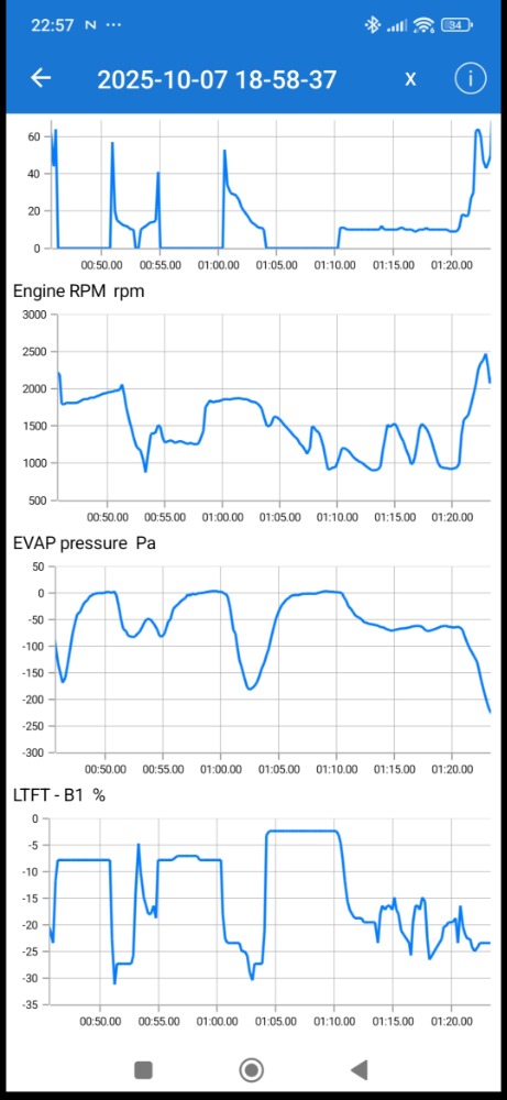

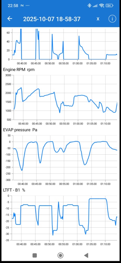

I need your support to understand what is wrong with my car. 1.4L Chevy Cruze II generation. Big fuel consuption, rich condition - LTFT 2% during iddle and apprx. - 25% acceleration. O2 tested and all okay (also was replaced with known good one). Injectors and GDI pump replaced ( oil also). Still reduced power and 14l per 100km in city.
In the attached screenshots in the top you can find purge valve command, rpm, tank pressure and LTFT.

I’m not sure about anyone else but your pictures for me are coming through as just black boxes

Sorry Tanriverdiyev, your screenshots didn't display correctly. I couldn't see that you uploaded or posted them incorrectly. Send them to me at wrenchturnsyou@gmail.com if you like and I can upload them again.
