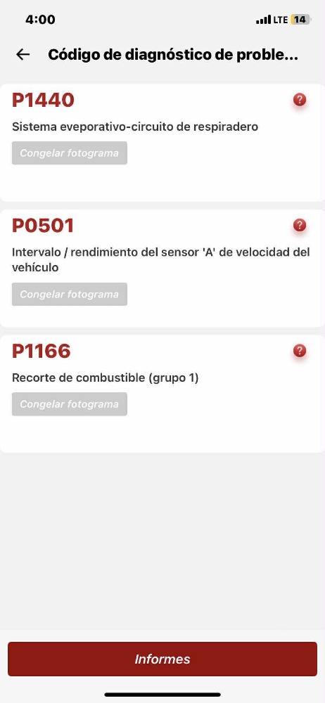

Hello colleagues, I wanted to share this case to see if anyone has experienced something similar:
Vehicle: Hyundai Elantra GLS 2001, 2.0L engine, returnless fuel system (no external return line, internal regulator in the tank).
Symptom: When the vehicle is quite hot, the engine runs poorly as if it’s starved of fuel, both at idle and under load.
After resting ~5 minutes, the issue does not reappear.

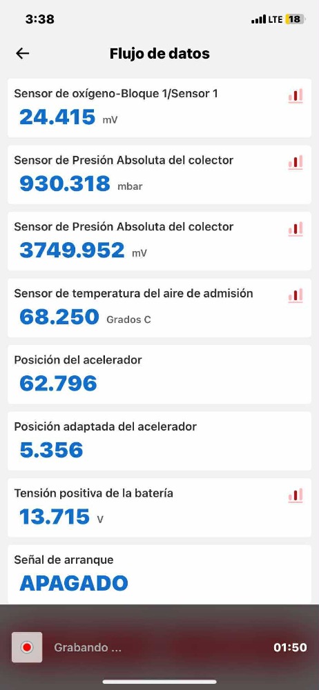

📊 Observed data
• O₂ sensors (upstream and downstream): voltage drops almost to 0 V during the failure (very lean).
• Injector pulse width: rises from ~3 ms to ~18 ms (ECU is trying to enrich).
• Fuel pump voltage: 14 V with proper ground reaches the connector.
• MAP sensor: shows increased manifold pressure.
• Throttle sensor: working correctly (mechanical throttle with sensor).
• DTCs: during one occurrence, codes appeared, mainly related to the link.

To answer your question, I don't think I have seen a Hyundai with a pump that fails only when the engine is hot.
A failing injector will induce a single cylinder misfire, so if there's one cylinder that's not contributing while it's running lean, you may be on to something there. I would compare the upstream and downstream 02s and verify they are both lean. This will prove if there's an issue with the upstream measurement.
I would also check fuel pressure if you have a gauge and kit you can T into the rail with, and if you suspect an injector, I would check the injector cold and hot with an injector timer tool while the fuel gauge is in the system.

Thanks again! Yep, I already monitored both O₂ sensors, and they both drop to almost 0 mV during the failure, so that part is clear.
One thing I want to check next is the current going to the injectors, just to see if it might be affected by the fuse box getting hot, as the customer suspects… though honestly, I don’t put too much faith in that idea 😅.
We tried reproducing the failure yesterday for about 20 minutes, but it didn’t happen, and when I opened the hood, of course, the car behaved perfectly. It’s kind of sad — imagine driving two hours with the failure, then spending time in the shop… and it disappears just because you lifted the hood!
