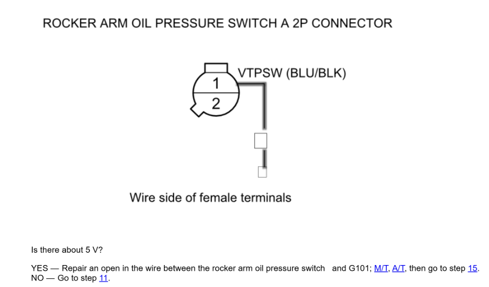

Diagnosing a car and looking at info for the circuit involved is giving me conflicting information. Specifically voltage for circuit one says 5 volts another says 12 volts. I read 12 volts key on engine off connector at switch disconnected. However it won't light a test light (regular incandescent style). I have tested ground and it supports a headlight bulbs current. But power feed from ECM wont light anything but a led light. I have not tested the harness feed side wiring just yet I just need to know what it should be for voltage and if its a current limited circuit.
 most appreciated
alex
10 months 2 weeks ago #92319 by Tyler
You're talking about the VTEC solenoid, or pressure switch? SI says the pressure switch should have "about 5V":
For the solenoid, I couldn't find anything in SI that says one way or the other what's supposed to be on the control circuit. They just have you doing resistance testing a substituting a known good PCM if all else fails. A 'soft' 12V like what you're seeing sure sounds like a bias voltage to me.
You've seen TSB 13-021? Oil level full?

Switch and circuit tested and all good. So swapped out vtec solenoid and body with another new one and all good..... For now...
