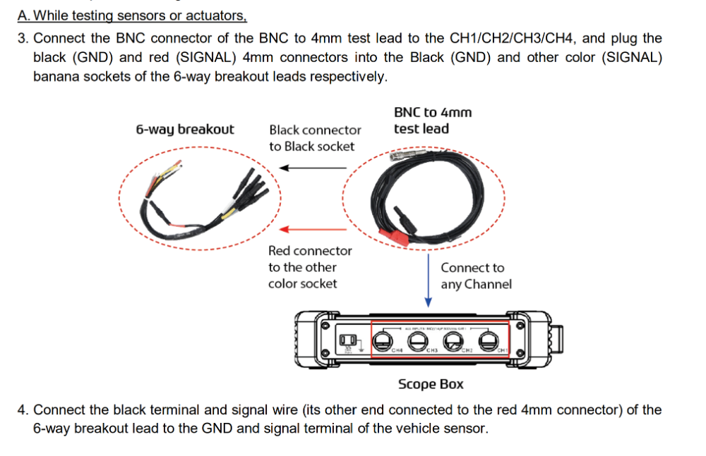

Hey, good morning all, after a very frustrating evening that i would've hoped to have been a very quick and easy diagnosis after i got in my own personal truck to go home this evening and turned the key only to find out... of course crank...crank, no start.  here's what i know. I finally have purchased my launch pad 7 elite which in this case makes no difference however i've had a fluke labscope that when i bought i was unaware i was buying from a seller that had sold it because it didn't work. now i have the launch o2-2 scope. pretty sure its just like the "hantek" but any advice upon setting up the primary initial BNC connectors and to which wires, i don't need detailed circuits just a general ideal i've taken the class. i guess i just want reassurance that i'm not going to ruin my new scope. My goal. i want to see if i'm getting crank signal and id like to match that up on the scope accordingly. My next inquiry is with the fuel pump. with this being a 95 f 150 5.8, i believe the crank signal must be seen by the pcm ignition control module for the spout and fuel pump to stay running? i may be completely wrong on this.  but otherwise the regulator drains the unused fuel back to the tanks. your guys wisdom is much appreciated! thank you so very much. I am getting spark, previous to this truck was losing power  right after a no start conditon, i had just replaced both front and rear fuel tanks and distributor, this was literally 4 weeks ago.

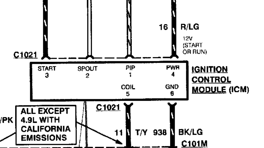

If you're going after the crank signal, I'd probably start at the Ignition Control Module. Charm.li has the OEM diagrams for reference:
charm.li/Ford/1995/F%20150%202WD%20Picku...m/Wiring%20Diagrams/
I'd start with two channels. One for the PIP at pin #1 at the ICM, the other for SPOUT at pin #2. Use the included backprobes. Scope ground to the B- post.

just as a verification to my first questions here... im really making sure that i understand this circuit and also of course my tool. so in this case i will not need attenuation as there are not high voltage, my probes are nice because the ones that were supplied came with red and black leads per channel. in the instructions it discusses grounding the whole scope itself which in and of itself is where all of my second guessing came from. but your saying its ok to simply connect red lead to the wire im testing and just ground the other wire? thanks in advance. im humbling myself here because i know this sounds silly but sure is different now not having guys in the bay next to you to go to for advise and your the only one in the shop running things:) Appreciate your and everyones knowledge and time.

i am getting pulse signal at injectors and i have pulse sigal at coil secondary wire.
Good! The presence of injector pulse would tend to suggest that the PCM is getting the engine speed signal, so you likely don't need to scope PIP and SPOUT.
Yeah, the manual is a little bit vague about making connections. This is the part you're referring to, right?
I wouldn't hesitate to go red lead to what you're measuring and black to B-. You can always try it on a known value first, just to get comfortable. A 12V battery, or a 5V sensor for example.
