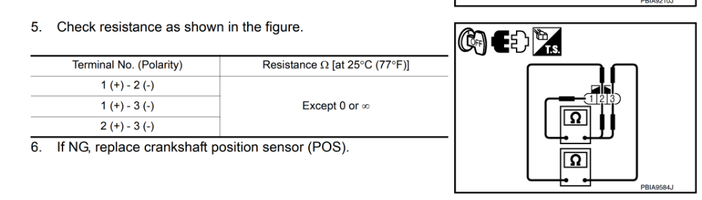

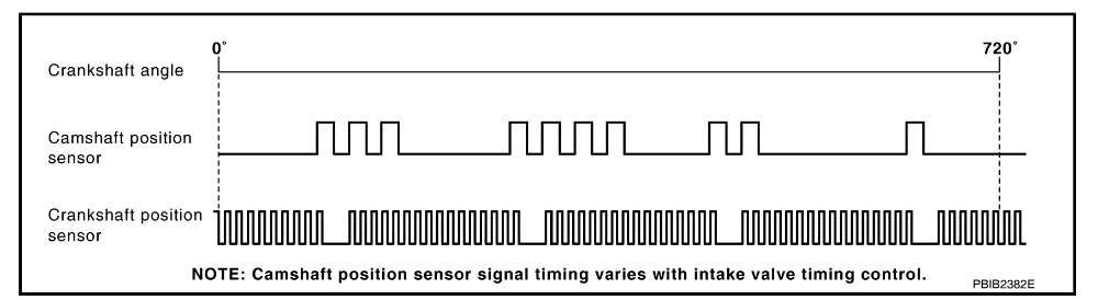

Hi guys, the code P0335 on a Nissan tiida 2008 1.8 in Mexico, a Nissan Versa in the U.S.A., if I am not mistaken. Is what I have problems with. I replaced the camshaft sprocket (INT) and the vehicle starts ok and runs for 20 or 25 minutes with no problem, but after that begins shaking badly and dies. I already tried 2 crank sensors from AutoZone and a third one from the dealer without any good results. To my experience, I checked the wires, and they looked ok. I want to know what the crank resistance is for this type of sensor. I haven't compared the correlation of the crank and cam signals because I need to get a copy of how they look alike. Any help from you guys will be appreciated. This is my second time using this service. Thank you. Lromeroe#$

Nissan service info provides a resistance spec for the crank sensor:
charm.li/Nissan-Datsun/2008/Versa%20L4-1...Code%20Charts/P0335/
So, anywhere between dead short or open circuit.
The problem is that the Versa crank sensor is a Hall-effect, and resistance testing (unfortunately) doesn't tell you much about possible problems in the sensor.
Nissan is kind enough to provide a known good cam/crank, too:

Good morning, Tyler, I was checking the resistance of the crank sensors.
The one from the dealer gave 1 and 2 = 1.2 Ohms, 1 and 3 = 3.75 Ohms, and 2 and 3 = 1.11.
The one from AutoZone: 1 and 2 = 3.29 Ohms, 1 and 3 = 7.93 Ohms, and 2 and 3 = 1.11 Ohms.
These are the results, which I believe are ok. Let me know if I am wrong. Thank you.
