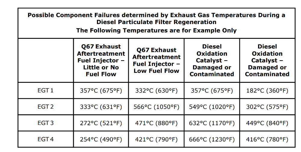

11 months 3 weeks ago #92399
Replied by Tyler on topic 2013 GMC Sierra LML Regen issues
I'm honestly kinda surprised! Normally replacing the indirect injector on these is a slam dunk, in my experience. I've replaced a few and it always got the EGT's cooking afterward. How did you confirm spray pattern/volume?
Only other suggestion I'd have is to let the truck cold soak overnight and make sure all EGT's agree within a few degrees.
I did find an interesting chart in service info, talking about IDing a failed DOC using the EGT values during a regen:

11 months 2 weeks ago #92408
by 00Jake00
Replied by 00Jake00 on topic 2013 GMC Sierra LML Regen issues
Hey Thanks guys for the responses. I have confirmed the temp sensors are reading fairly close to one another (within a few degrees).
As for the hydro carbon injector I removed it and had it in a glass vase and had a coworker engage my injector buzz tester while the engine was running. we compared the old injector to a new one and it was night and day difference in the pattern and I believe it was 15ml or whatever the book called for I know it was right there where it should be anyways. So far we have been driving this around for the last week and so far haven't been able to duplicate the issue. Like I figured they didn't like the qoute and to me sounds like they're gonna pick the truck up and see what happens. Only other thing I can see is maybe the exhaust system is totally clean and instead of building heat it just flows right through??? If that makes sense, kinda goes along with why the thing smokes so bad, we were joking we were gonna get the fire dept. called with how much smoke this thing barks out the back lol.
