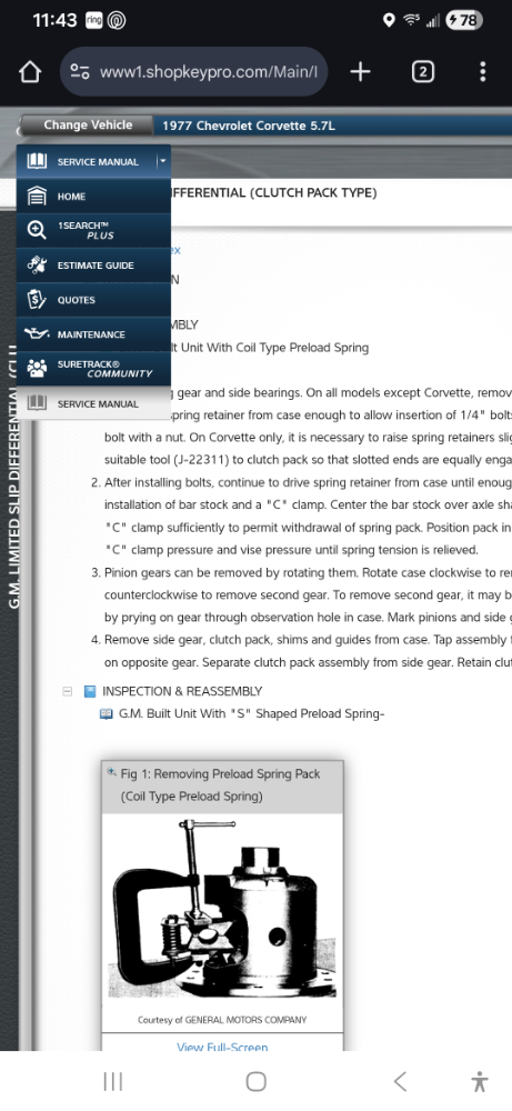

Do ya’ll know of any online resources/websites for classic cars? I’m looking for torque specs/rebuild information on a 1977 stingray rear end. Mitchell isn’t helpful with old cars like this. Thanks 😄

I find that when Mitchell fails, chosing "service manual" from the drop down menu instead of using "one search plus" will generally let me flush out the information I need. Of course, with older cars like your stingray, information is available on a case by case basis. All Data may or may not have what you're looking for if you continue to strike out with Mitchell. Don't immediately discount Corvette specific forums. While I generally dislike single make forums, there are a few nuggets of valuable information to be had, even if you have to wade through a swamp of bad information to find them.
