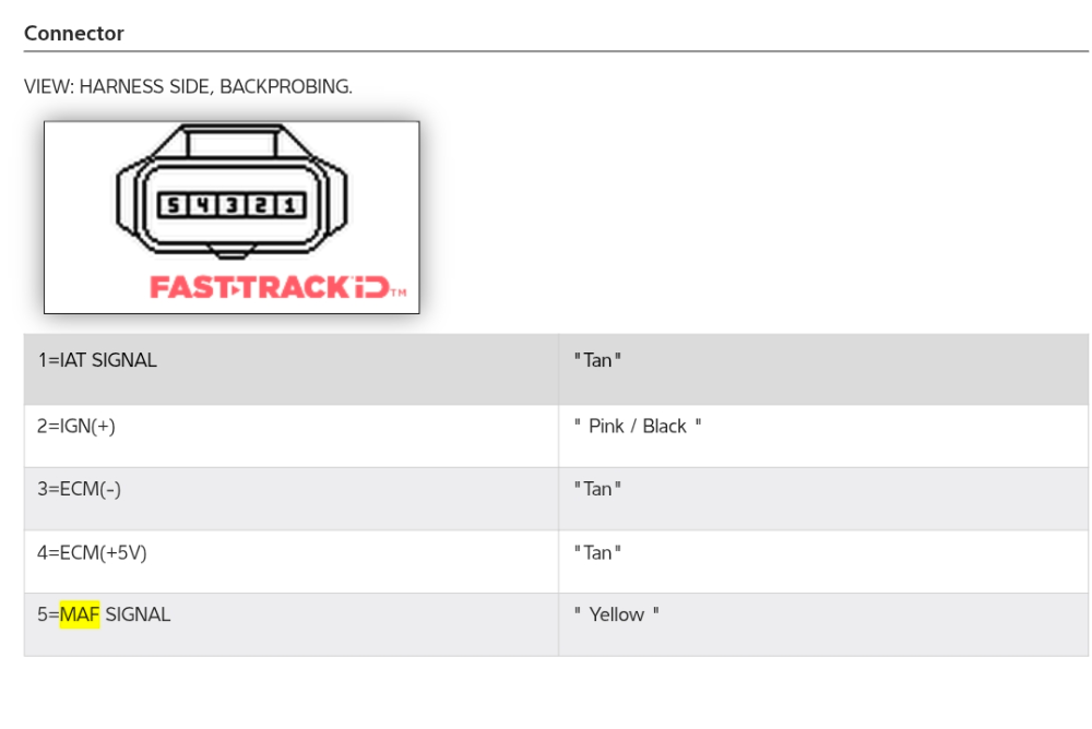

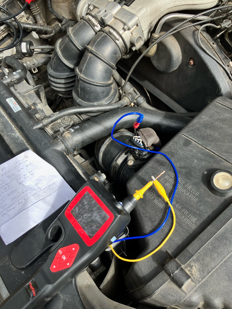

The car is running ok but there are wiring problems on the mass air flow sensor (MAF) and I am trying to verify the wiring integrity but need:
Pin-out for connector 1 (C1) at the Powertrain Control Module (PCM).  I need the circuit for pin 39 at this connector.  I also need to verify that MAF Pin 4 (labeled low reference on a wiring diagram I saw) is normally at 5 volts as I am measuring, and not supposed to be at ground voltage on this tan wire.
In 2022 I was on this forum and got this car running but I had to cut (near the PCM) the tan wire to C1, Pin 26 and ground it to the engine block in order for the car to start.  I want to fix the problems with the ground to the MAF and figure out the circuit for the tan wire I cut.

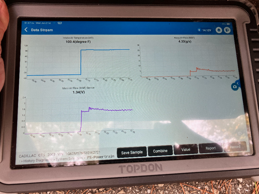

Attachments:  The second image shows the MAF/IAT sensor first unplugged (low readings), then plugged in and reads just over 4 g/s of air into the engine

I measure 5 v on the tan wire at MAF pin4 and get Diag code P0103 high voltage on the MAF signal line. Do I try short to ground ( short to tan pin 3) on pin 4 MAF to see if the code changes to low voltage?
9 months 1 week ago #92578 by Chad
I am assuming that you are checking the voltage with the MAF Sensor connected.
Disconnect the sensor and recheck the voltage. Do you still have 5 volts? If not, I would look for an open in the low ref wire between the sensor connector and the PCM.
Once you verify that pin 4 is not shorted to power, it would be safe to short pin 3 to pin 4.

MAF Pin 4 shows 5V with it plugged in or not. I get 5V when I place the auxiliary ground from the Hook tool on any of the other ground, or low reference lines, or on the chasis ground or battery ground. Always shows 5V when the Key is on, or engine on. When key is off it shows a high resistance to battery ground, about 600ohms
9 months 1 week ago - 9 months 1 week ago #92582 by Chad
If your tool is saying that you have 5 volts on the Negative Battery post, your tool is faulty.

My tool is a TopDiag P200, similar to the smart hook. It reads battery negative when I touch the tip to the battery negative. It has an aux ground which is used for resistance measurements.
Can you show the PCM connector C1 pinout? I want to trace the low reference lines to C1.

Second, I found on the MAF, Pin 4, tan line is always at 5V, either with MAF plugged in or out. That tan line goes to pin 51 on the PCM which is labeled low reference (measures 5 v at the PCM pin 51). I discovered that it has continuity with a grey line at the splice 102 in the fuse box near the battery. KOEO I measure 5 v at this grey line that somehow has continuity with the MAF pin 4 tan line.  See the pic below and the filled in grey line on SP102 is the particular grey line with continuity on the tan line Pin 4 MAF.
  • Marti
  • Marti's Avatar Topic Author
9 months 1 week ago #92590 by Marti

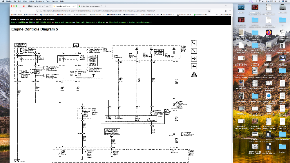

Apparently, the MAF Pin 4, labeled low reference, is a 5 volt ref line at ECM C1, pin 51 as seen in the skematic below from the Charm website.
Therefore I suspect my main issue is to fix the S111 line that connects the MAF Pin 3, and the ECT and CMP tan low ref lines to the ECM pin 26 (I cut that line to get the engine to start. The incoming line to the ECM which was cut was then grounded to a bolt on the ECM housing) I suspect a bad S111.....

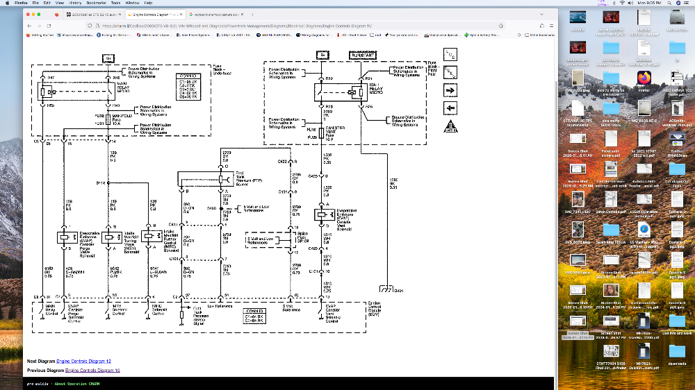

9 months 1 week ago - 9 months 6 days ago #92591 by Marti
I found the circuit that shows the splice pack 102, gy line that had continuity with my ground line on the MAF pin 4 line. The gy line is a 5 volt ref line at ECM C2, pin 63. The circuit is below for that gy line.  I guess this makes sense if the 5 v ref circuits all have continuity through the EC--therefore the MAF Pin 4 line being a 5 v ref line (labeled low ref for some reason) has continuity with another 5 v ref line like the gy line from the other connector C2 on the ECM.  Note the gy line feeds 5 v to the fuel pressure sensor.

8 months 3 weeks ago #92640 by Marti
There is a discrepancy between wiring diagrams from the Charm.Li website and the one I paid for on Portal=diagnostic.com (Automotive Electricians Portal). It shows a 5 v reference on MAF pin 4 on the Charm site (PowerManagement/Diagrams/Electrical Diagrams/Engine Diagram5 ). On the Portal-Diagnostic.com site it shows Pin 4 as a Low Reference on C1, Pin 51 of the ECU. Which is correct? I read 5 volts on this pin when the key is on... I copied the Portal-Diagnostic diagram above, and the Charm diagram is also copied above...

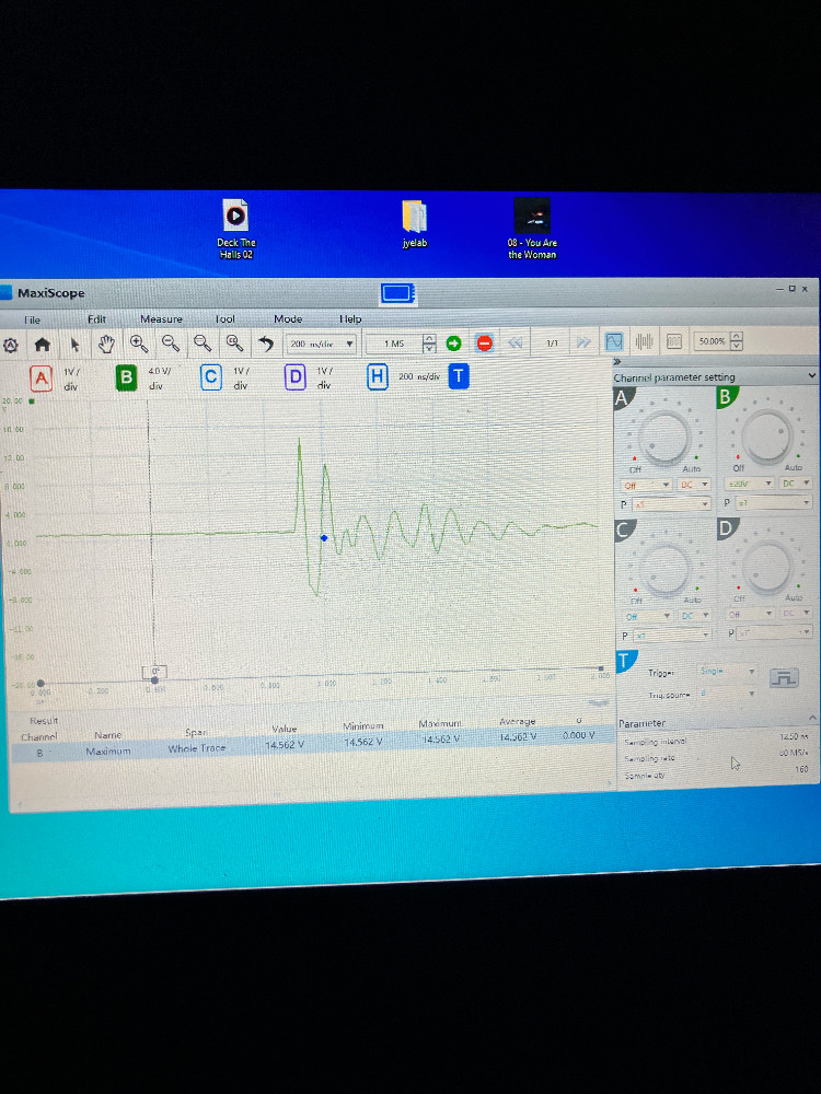

8 months 3 weeks ago #92653 by Marti
I have two images. First is scanner values with the MAF in various modes, key on, engine off·KOEO, and unplugged, and engine on. Next I used an oscilloscope and measured the MAF sensor line, pin 5.
8 months 3 weeks ago #92657 by Noah
I am also seeing, according to shop key, that pin 4 is 5v.
I don't think this is a frequency generating MAF based on your scope capture and the description of the MAF in shop key as well.

Are you sure that MAF Pin 4 is not an ECM provided ground or low reference?
No, but I am sure that this pin out labels pin 4 as 5v reference, but I have been burned by Snap-On & Shop Key before.
As a matter of fact, if you follow the simplified Mitchell diagram, it shows pin 4 as low ref.
Again, been burned by Snap-On & Shop Key before...
I would say that as long as you only have one pin of the MAF that measures 5v, then that's the 5v reference. If you had multiple pins that measure 5v, then we would have some detective work to do.
There are definitely some discrepancies which understandably complicate the matter.
