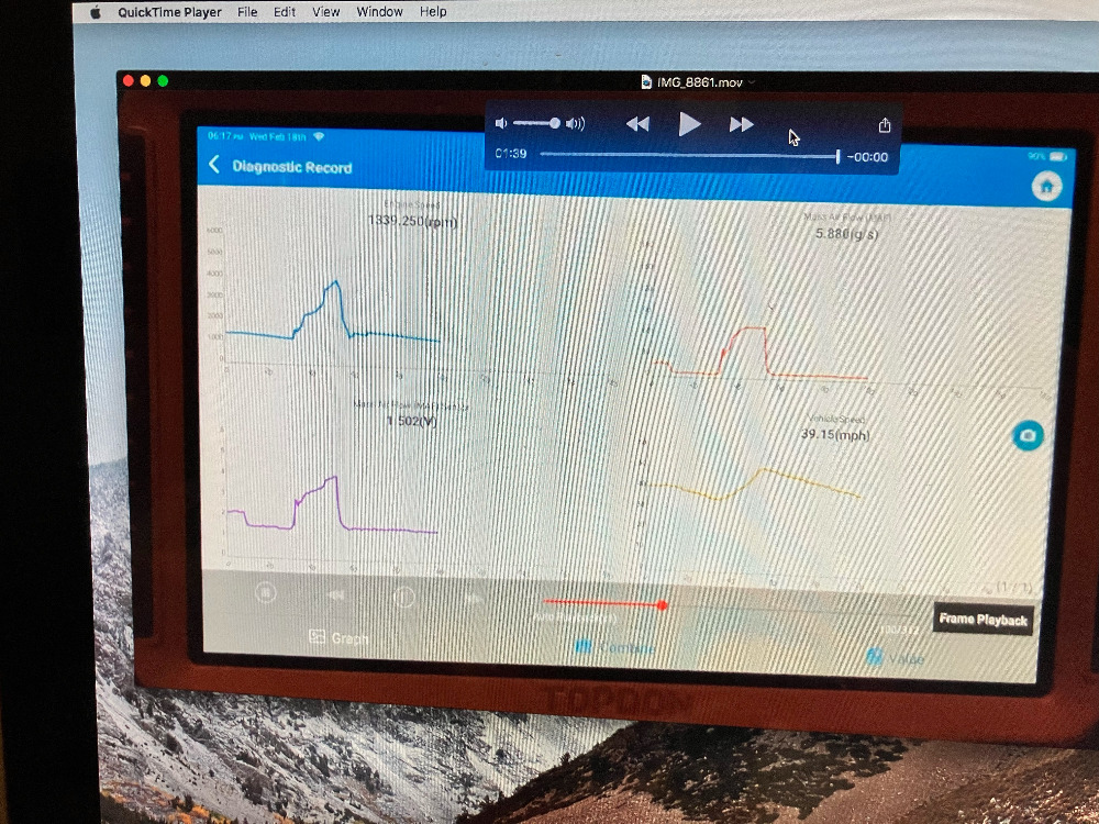

I took a video showing a drive and the scanner PIDs, including MAF sensor values in gr/s, and also V.  The communication to the OBD port would cut out sometimes, and then work other times.
I don't know how to attach a 29 MB quick time video so I just posted the picture below.  From left to right it shows RPM,  grams/second    and then the bottom is MAF volts, and MPH.

8 months 2 weeks ago #92707 by Noah
The best way to post a video is to upload to an external server like you tube or something and then post the link here.
Is the loss of comm a symptom or do you think it is a scan tool issue?
