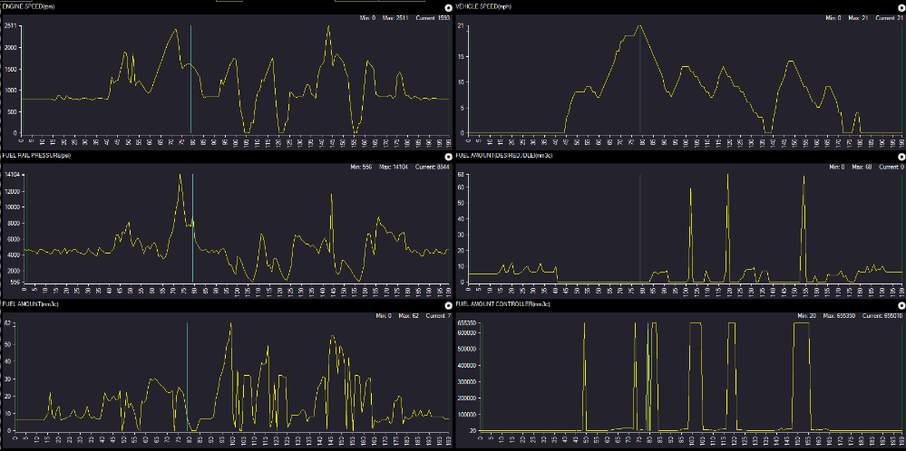

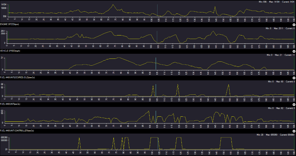

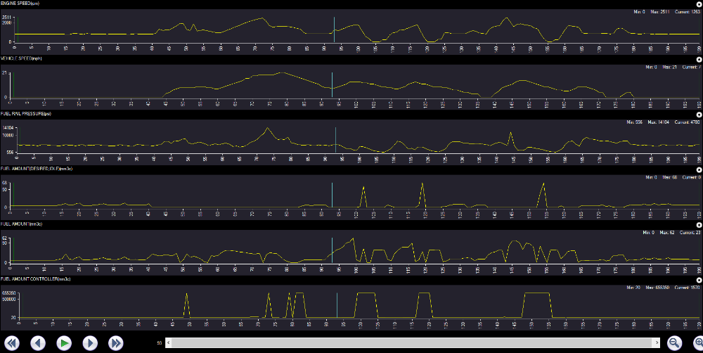

Been a while but I subscribed again in the hope the extra info I have and the PIDs that I have captured might shed dome light.
We got the Injectors tested and all good, we load tested all of the injector wiring and it was all good, hence we took the injectors for testing. we still had the issue so sent the ECU off for testing/repair.
The ECU repair company bench tested it but said that they could find any fault, however someone had been inside before and not done a very good job. We asked them to refurb the ECU, which included replacement of the injector drivers, and they said they would tidy up the previous 'poor' work.
We got the ECU back and fitted it, starts EVERYTIME, no random stalls followed by No start like we had before..... all good so far, as it did not have a current MOT test we couldn't test drive it.
We booked the MOT test (a yearly UK test to confirm road worthyness), pulled away to drive to the test centre, only to change into second and at 2400 rpm, it stalled!!! started up again no issue, pulled away in first, changed to second, 2400 rpm and it stalled again!!
See the Image of the PIDs below and I have attached the saved file if anyone wants to download and view it in shop stream, I have added a screen grab of the same data in a couple of different views.
We no longer get Injector codes, always fuel pressure codes, I don'e seem to be able to view freeze frame data from when the code triggered on my Verus Pro.
Anyone got any clues of which direction to go next....... or is it some petrol and a match?

That's super frustrating, it seemed like you had it fixed there. Since it was all good after reinstalling the engine computer, I might investigate a pin fitment issue at the PCM connectors and maybe use a contact promotion agent like stabilant.
I'm just going to put this out there, not that it applies directly to you, but there's this industry wide misconception about dielectric grease. It is an insulator and will cause more harm than good applied to connector pins.
It's hard to see your captures, it appears as though RPM is dropping off to 0. This must be when the engine is stalling?

Yes, the engine stalls and RPM drops to Zero, turn the key and it starts right up again. The engine is solid!, idle constant with not a single fluctuation at all.
Its really frustrating!! The PID's are a lot easier to read if you open them in Snap-on's Shop Stream application.
If feels like fuel starvation, we have since removes the tank and flushed it out with brake cleaner, pumped cleaner through the pickup line, the priming bulb and all the way to the high pressure pump too.
The strange thing is that the van drove great before sending the ecu away, with the exception of the random stalls and no starts , this makes me believe its not the high pressure pump.
Could there be air in the system that's just sitting there at idle and only causing an issue when there is a high demand for fuel and getting pulled into the injectors causing the stall, I don't think so as that would probably give Injector Codes rather than Pressure codes. its potentially causing pressure issues in the common fuel rail.
Whats the best way to test the pressure sensor?
