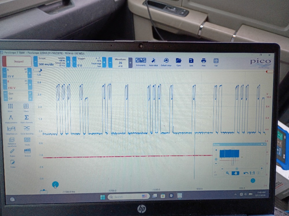

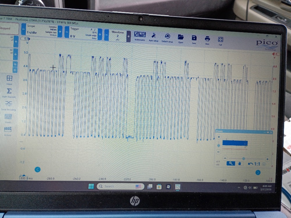

Need some direction, just took my first waveforms! 2011 ram 4.7l 1500 p0344 intermittent Cam signal. I took a scope of the crank and cam on my pico 2204a and not sure what I'm exactly looking at. I have 5v ref on both when checking harness unplugged but neither seem to pull fully to it. Both the cam and crank seem to have this issue on the waveforms. I'm leaning towards two sensors, is this correct in my thinking?

Well that looks interesting, are these cranking or running patterns? Can you also probe the 5v ref and signal return to the sensors at the same time to verify it remains steady?

It looks to me like the CMP and CKP signal wires are resistively shorted to each other.
I've seen this once before. The ECT sensor likes to leak coolant into the connector, which wicks up the ECT wires and into the PCM connector. It just so happens that the ECT, CKP and CMP all share the same PCM connector (C2).

You hit the nail on the head. I scoped the 5v ref during signal and it was dropping up to .7v
Ect had wicked all the way up had corrosion on cam/crank signal pins as well as a 5v ref pin.
