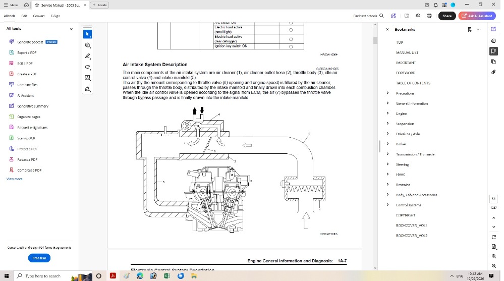

Hi folks. My grandson has the above car here in Australia. It has an intermittent rough idling issue. I'm new to electronics but have done some testing and replaced some parts (mea culpa, mea maxima culpa) without fixing or changing it, but my latest efforts in diagnosing the cause has pin-pointed the Idle Air Control Valve. I had the engine running with the front half on the airbox off after replacing the spark plugs. This was fortuitous as it allowed me to hear the change in air intake sound when the engine was idling fine then misfiring. It was obvious that the Idle Air Control valve was activating and deactivating, causing a distinctly different sound. I put a scope on the middle wire on the IAC plug and saw it spike when misfiring and relatively stable when not. If the revs are held at about 1500, all is well. the first link below is if the change in air intake sound, the other is of the small scope I connected to the middle wire of the IAC valve.
I should add that this rough idling is very intermittent. On a half hour stop/start drive say, it may happen more often than not when stopped, another time it may happen just a couple of times. The engine has only stalled twice at a stop and restarts immediately. The car runs perfectly under all conditions except for this intermittent idle issue.

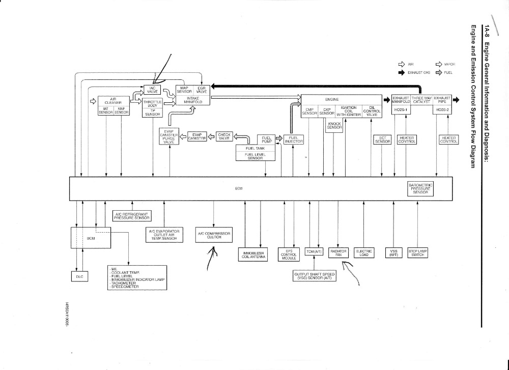

You can hear the rad fan/air con coming on and off repeatedly at idle in the second clip, but at 1500-2000rpm it behaves normally - which seems to suggest that it's getting a wrong message too. What do you make of the scope spike and on/off fan-air con noise?
Where to from here? TIA.

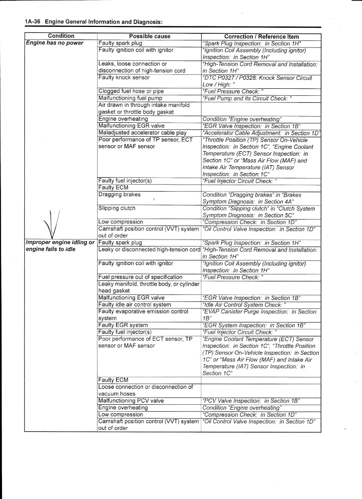

Here's a page from the FSM. Is the ECU at fault???

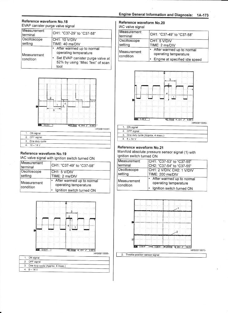

This page shows what the waveform of the IAC should look like at No.19 but I don't yet know how to correctly set the scope to read properly.
When I can get back to the car I'll do the 10 step test - which says the ECU could be the cause, as a last resort.
