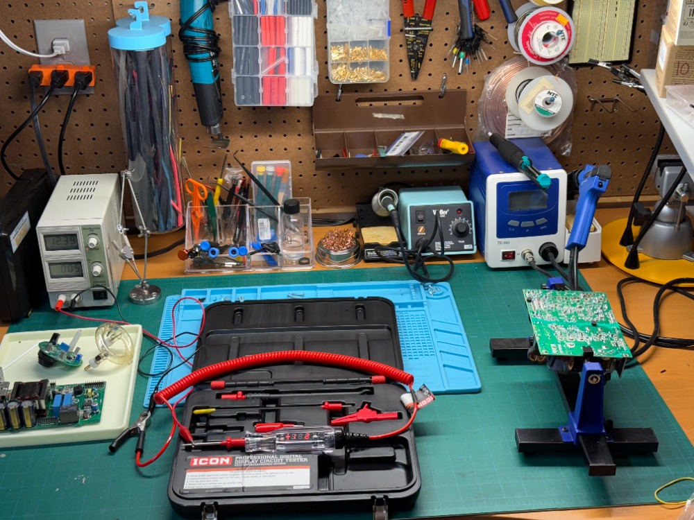

I've been tinkering with electronic projects for over 20 years but I never had the opportunity to learn proper automotive electrical diagnostics. I've never used a test light, just a multi-meter. However, I had a chance to get an Icon digital test light/circuit tester (in picture) for a steal and I couldn't pass it up. I'm hoping you guys could walk me through this diag, and maybe put the new test light to use. How would you pros go about this? TIA!
8 months 1 week ago - 8 months 1 week ago #92746 by Tyler
Congrats on the test light!

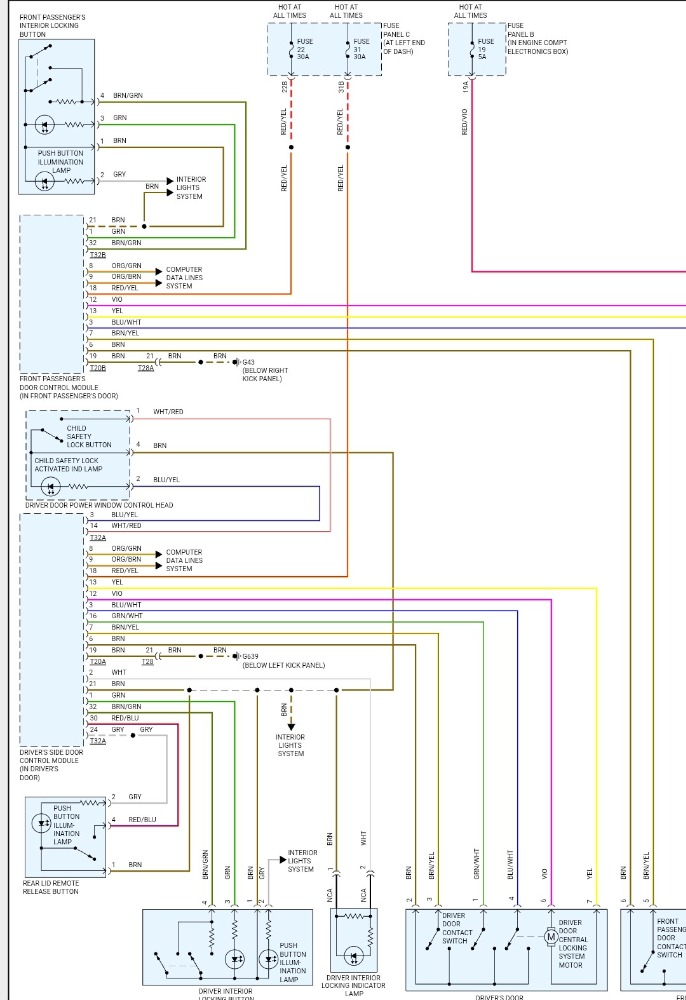

The only non-invasive test option you have is to find fuse #31 (30A) in Fuse Panel C and measure current across the fuse while hitting the door lock button. If you saw an increase of several amps across the fuse after hitting the lock button, I'd be confident in a binding actuator and go for replacement. If you saw no current change, you're back to pulling the panel.

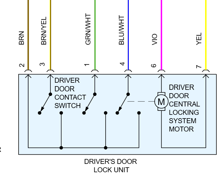

With the panel removed, find pin #12 violet and #13 yellow. Those go to the door lock motor. Hit the lock button while probing each wire with your test light connected to B-. Then probe each wire connected to B+. One wire should light on B-, the other on B+. You're checking for power and ground coming out of the DDM. If they're there, it's actuator time. If one or both is missing, stop and tell us so we can go down another path.

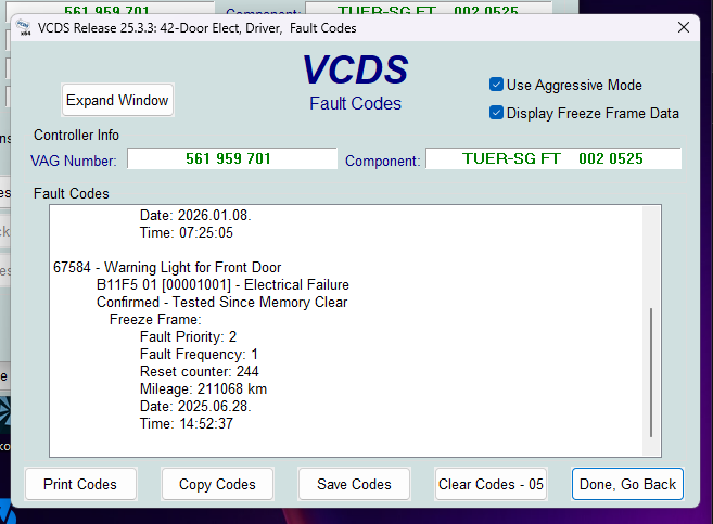

VCDS is perfect for this.   After you get the interface hooked up, do an Auto Scan . It'll take a minute to complete, but you'll get a text report at the end of it. See what the DDM has stored.

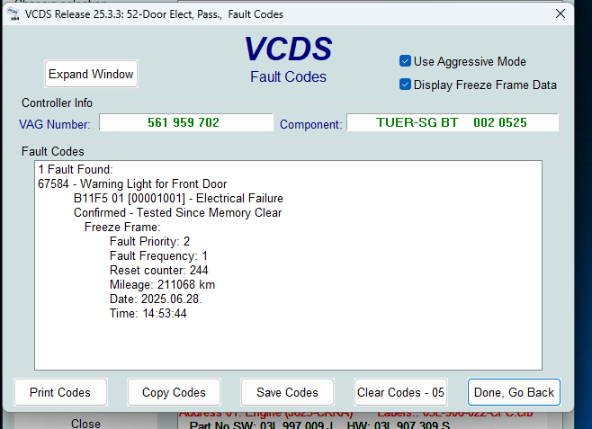

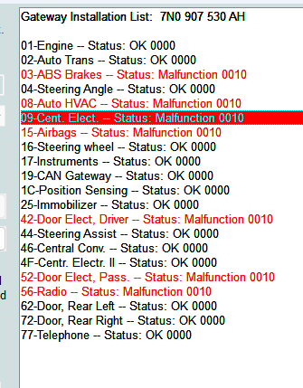

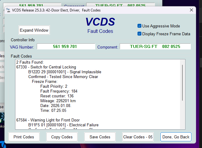

I did an auto scan and found a central locking error. The passenger door also had the same warning light error but I'm not sure if that's related. I also tried clicking on 09-Cent. Elec. but it wouldn't work. It tried connecting a few times then just went back to the gateway list.
7 months 1 week ago #92836 by Tyler
Perfect! 67330/B122D is the one you want to follow. I'd ignore 67548 for now.
Because of how VW does its service information, there's no specific code set criteria for 67330. But on a guess, I'd say the Drivers Door Module isn't seeing the door lock motor switch (pin #4) change state when it commands the door lock motor off and on.
If pulling the door panel is NBD, then I'd do the pinpoint testing at the door lock motor connector with your test light. Or you could get a current clamp around one of the door lock motor wires, if you have one.
