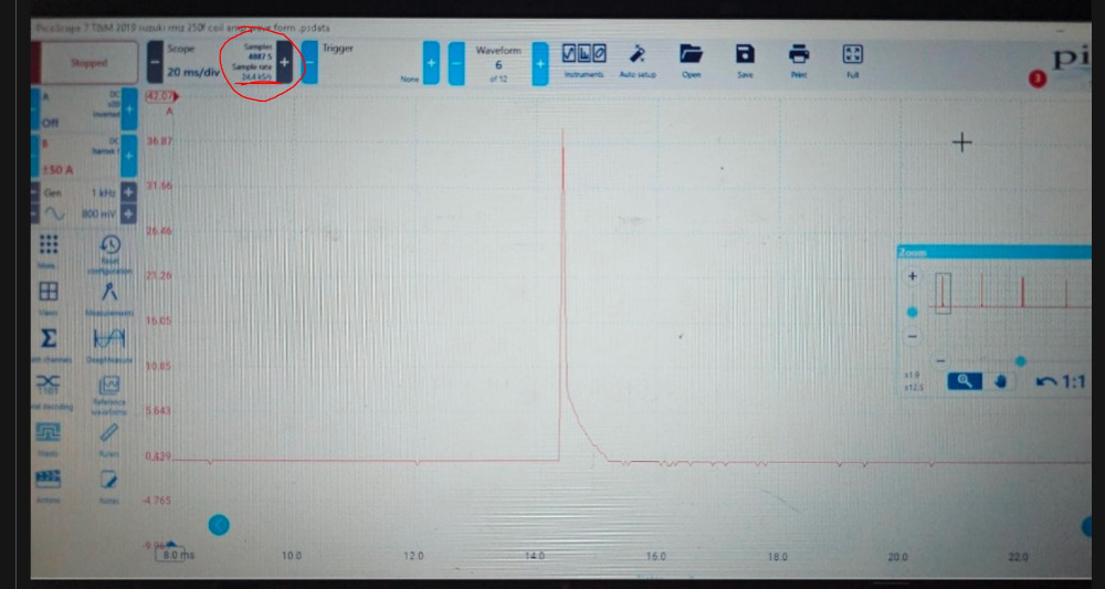

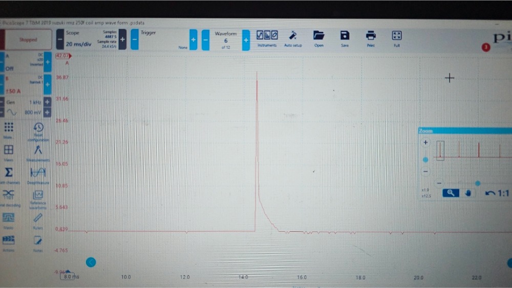

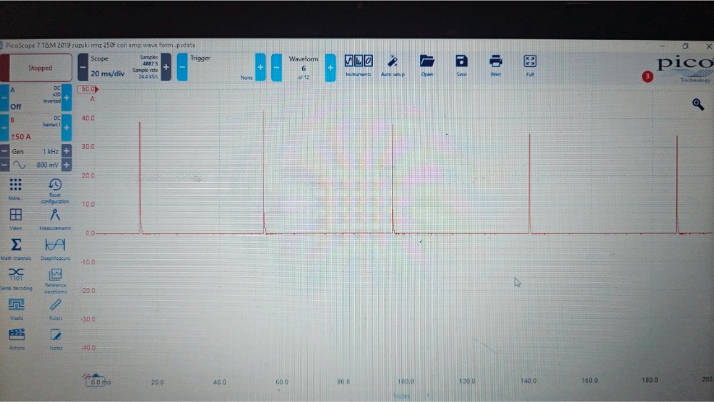

Hi to all, please someone explain to me why the ignition coil amp ramp looks like in the pictures

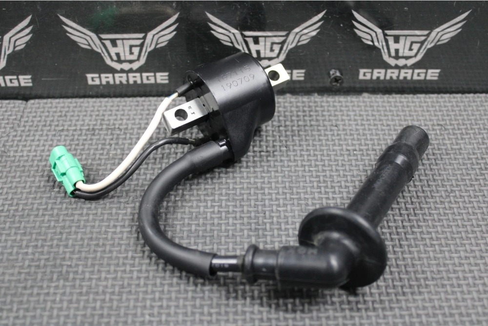

2019 suzuki rmz 250 motorcycle
1 cylinder engine, 4 stroke, 2 pin ignition coil
motorcycle runs and drives perfectly, no complaints at all, i was playing with my picoscope and I tried to see the ignition coil amp waveform, this is the first time I see a waveform like that
No matter what i do i can't get a normal amp ramp waveform like any others i saw in the past
Also i notice how high is the amp reading (more than 30 amps)
i hope someone can teach me about it
Thanks

Your sample rate is very low. Increase it to 1MS/s.
This/these event(s) look, very much, like a voltage waveform, to me. What amp probe are you using? And, how is it connected?
I would like to see the voltage waveform, along with the current waveform.

Hi thanks for your reply, I was using hantek 65amp probe
I use a lot that amp probe without any issue in the pas, I have other coil amp waveforms saved and all looks normal
It was connected to one of the wires coming from the coil, then I tried the other wire, on both wires I had the same result
I have another same bike and tested, same result 😂😂
I don't have an explanation, today I'm going to test in a car or another bike to see if there's a problem with my amp clamp
Thanks

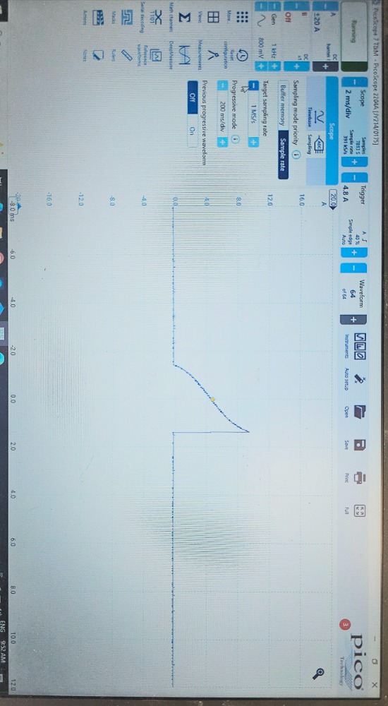

Hi please see the waveform i took a few minutes ago
2017 chevrolet malibu 4 cylinder, 1.5t
COP ignition system (4 wires)
that amp ramp looks more normal to me, that's what i was hoping to get on the motorcycle 😂😂
so now I can be 100% sure that my amp clamp is working
Any explanation on why the motorcycle waveform looks different?
Thanks for your time

please check other captures i took this morning to prove that my amp clamp is reading good
