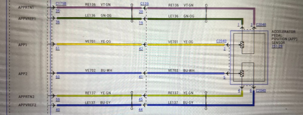

Hello everyone,Scratching my head here as I am trying to figure out an Accelerator Pedal Sensor issue on a 2017 Ford Transit 3.7L.
DTC P2122. Actual problem: reading battery voltage at one of the 2 sensors' ref wires.
Sensor 2:
APPVREF2 -> 5v when the car is running.
APPRTN2 -> tests fine when measured with the positive lead connected to power.
APP2 -> Signal reading changes when pushing the pedal
Sensor 1:
APPVREF1 -> 12v or ~14 when the car is running.
APPRTN1 -> tests fine
APP1 -> No signal when pushing the pedal
DTC is related to Sensor 1.
The above readings are consistent whether the connector at the pedal is plugged/unplugged.
I inspected the wires, everything looks clean, no corrosion from end to end. There is an intermediate connector, which I unplugged and inspected, looks good.I swapped 5v ref wires, the DTC went to Sensor 2, and the signal was working as I pressed on the pedal in sensor 1.There was a PCM lying around that I swapped, same battery voltage at the ref.
If disconnect the PCM, the battery voltage and 5v ref disappear. Same when I disconnect the connector, which I think supplies grounds and powers.Looks like I have short to power, and to me, everything is pointing to the PCM; but what are the chances of the other PCM having the same issue?

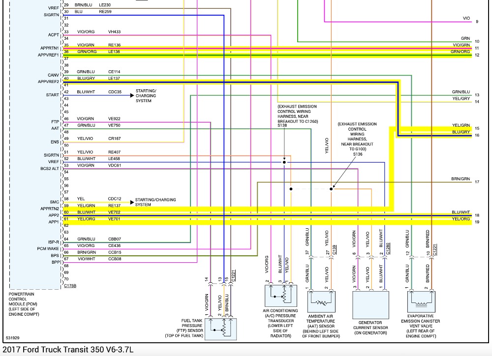

Went back and did some more digging and found the exact same issue on the A/C Pressure sensor. Same DTC description of low current, which started to make sense as that "battery voltage" is just phantom voltage. Test light is very dim.
According to the diagram, the vref is shared with the A/C pressure, Fuel Tank pressure sensor and the Alternator Current sensor. FTP has 5v, but not the A/C. The APP has a dedicated refv as you know, so kinda strange how they exhibit the same behavior while they're on different circuits.

The individual ref circuits are not as isolated as your may think by looking at the diagram. It is entirely possible that due to the internal circuitry of the PCM that a short on one 5v ref circuit will effect a seemingly different sensor circuit. Like in my attached scope capture, the app 1 5v ref should be its own dedicated 5v ref circuit according to the diagram. We can see that by shorting the 5v ref for the fuel tank pressure sensor to voltage on the vent valve circuit power feed, that it must share some part of the circuit in the PCM, or it would remain uneffected. On the other hand, the green channel on the scope is connected to the battery current sensor 5v ref feed and is entirely uneffected by the short to power on the fuel tank pressure sensor circuit. Essentially what I'm getting at is, we down know exactly how the PCM is regulating the 5v reference and distributing it through out the van, regardless of what service information would have us believe.

I agree that we don’t really know how the PCM regulates voltage, because the A/C pressure sensor shares the same vref as the the Alternator current sensor, which works fine. There has to be some back feed from another sensor, but I think I should’ve gotten 5v when I removed all fuses and relays. I’d imagine voltage could probably leak internally, but I am 100% sure the PCM is functional, because I installed it in a different van and worked fine.
What I find interesting about this issue is that even when the ignition is off, APP1 and A/C sensor vref measure battery voltage. I know this could be fed through a constant B+, but again, as I mentioned before, there is almost no current, as the the test light is very dim; so I still doubt there is short to positive; otherwise, test light would be bright. I am leaning towards a back feed from some sensor or some splice.
See attached part of the diagram, ignore highlighted lines. There is a note about that vref: (EXHAUST EMISSION CONTROL WIRING HARNESS, NEAR BREAKOUT TO C1260) S138
I will check there and post back.
