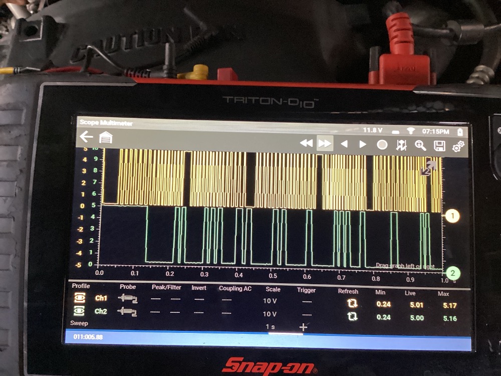

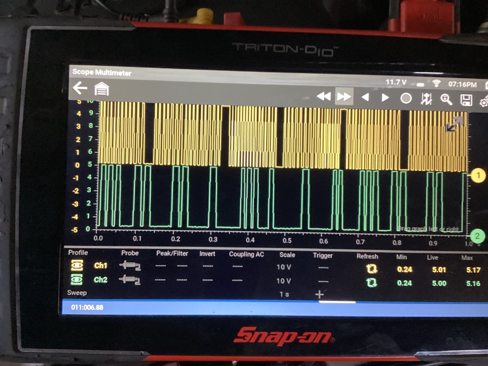

    Vehicle was brought in not starting due to a hole in the piston. After engine was replaced with a good engine vehicle still does not start. Has new fuel pump, switched PCM for another one yet still does not start. Wish it gave code for something but no codes for PCM. I am having issues with this truck not starting like stated previously have no codes of to where it can point me in a direction to start. Thanks in advance.

Do you have spark, injector pulse, and good fuel pressure while cranking?
The title of you post is a little confusing.  Are you saying that it will start if you press the accelerator pedal to the floor?
