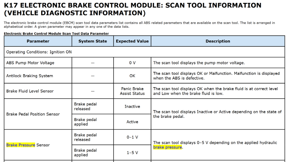

Sorry for taking so long to reply. So there's no data on the scan tool for brake system pressure and i don't have any gauges to hook up to the caliper to check it manually but im guessing that's my best bet. I guess ill have to get some. and as far as i know nobody has replaced anything on this car. my guess is master cylinder but i want to be sure. and with all the other stuff it could be i don't know how to pinpoint this one down exactly. im thrown off by it going no communication when its happening too. what do you think about that Tyler?
No offense meant, but you're certain there's no brake pressure sensor PID in the EBCM? Service info says there is, but that wouldn't be the first time SI lied.

None taken my friend. I meant there’s no actual system pressure pid that displays system pressure in psi. My thoughts were even if the pedals released it may have residual system pressure even if it’s not displaying voltage. I did reference that in the original post saying I’m showing .49v with pedal released and it does go up with pedal application and back down to .49 when released. Spec from SI is 0-1 normal release and 1-5 when applied.
