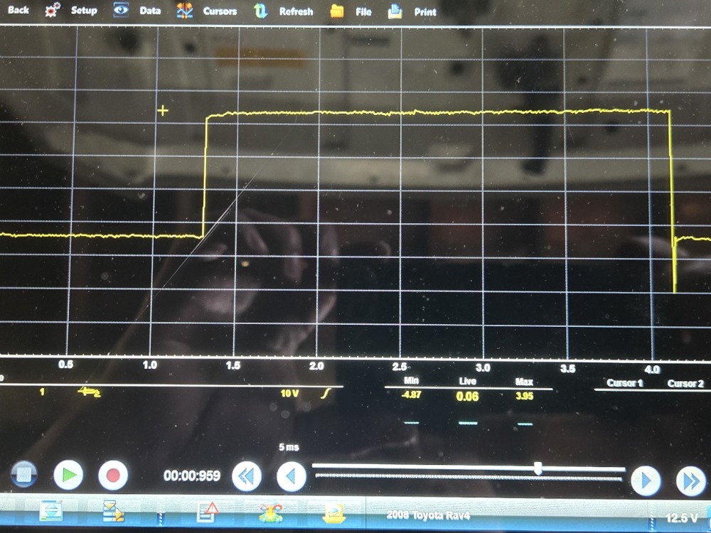

5 months 2 weeks ago #92960 by cmitusa
2008 toyota rav4 v6 IGT question was created by cmitusa
hello does anyone know about a toyota IGT system i know is a square wave 0 to 5v but when looking at the oscilloscope at high RPM the square wave drops to -4.87 so i wonder is this normal anyone feedback would be appreciated thanks
2008 toyota rav4 v6 with a p0301 is it normal for the IGT signal wire to drop as low as -4.87v??
new spark plug
new injector
powers and grounds check out
voltage drop checks out
IGF is good
relative compression is good with even peaks
coil fire nice and strong
5 months 2 weeks ago #92961 by Noah
Replied by Noah on topic 2008 toyota rav4 v6 IGT question
Are you taking about that downward tail at the the of the square?
Try checking one on another coil for a cylinder that doesn't set a misfire code.
