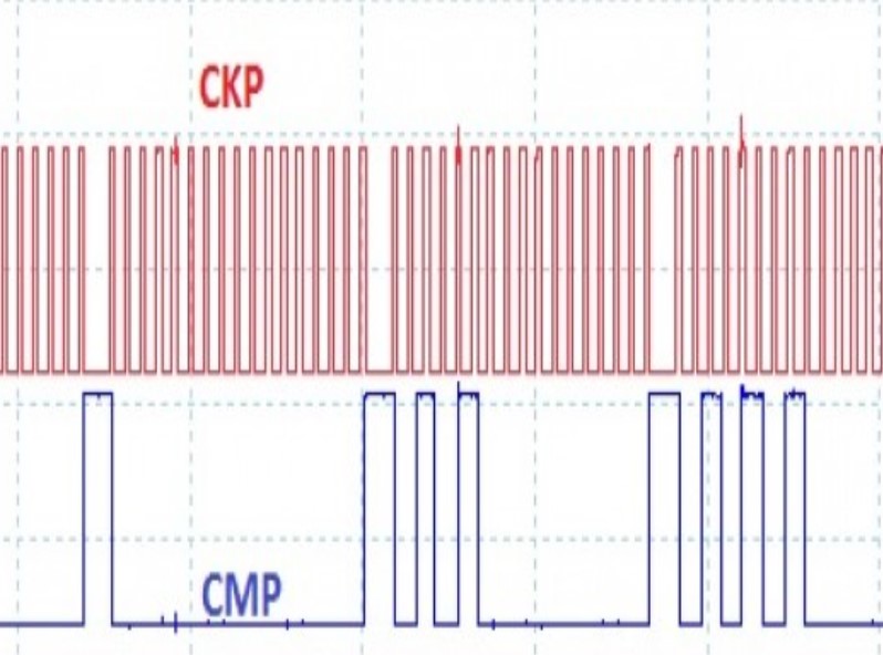

I'm working on a 2001 Nissan Almera N16 with a permanent P0335 CKP Sensor Circuit. The CKP sensor has been replaced. Wiring checks have been done in accordance with Paul's teaching and the ECU has been replaced. Signal, Power and ground all check satisfactory with Picoscope. Still the P0335 persists. Does anyone have a direction I can take from here.

5 months 1 week ago - 5 months 1 week ago #92982 by Chad
Replied by Chad on topic 2001 Nissan Almera P0335
Hi, Francis.
Welcome to the forum.
When you say "permanent P0335", are you referring to Mode 10 Permanent Codes?
Or, are you referring to a persistent, currently active code? Is the CEL illuminated?
Do you have any noticeable performance issues? No start, hard start, misfires...?
I'd like to see a waveform of the crank position signal, captured from the ECM connector.

5 months 6 days ago #92990 by advautoserv
Replied by advautoserv on topic 2001 Nissan Almera P0335
Hi Chad,
Thanks for your input. You are right it's a persistent code with MIL on all the time. No starting, missing or other driveability issues.
I will attach the waveform taken with my Picoscope.

5 months 6 days ago #92993 by Chad
It looks like the signal is not pulling all the way down.
Make sure that your crank sensor has a good ground.
Can you share the .psdata file, via google drive link?

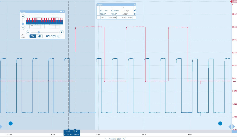

Nissan_Almera_2001_Gas_20260602-0002_PA3246.psdata
Hi Chad, Here's the CKP/CMP waveform.

5 months 1 day ago #93010 by Chad
I just realized that my CKP waveform has 17 peaks when all the waveforms on the forum for the same make model vehicle have 16.
I believe the difference is the engine size. You, probably, have the 1.5L. Here, is a link to a 1.5L KG:
rotkee.com/en/wavebase/good-timing-ckp-c...Yjh8ZI8D7CN8AWmlspbC
I believe the 1.8L has 16 teeth.
5 months 1 day ago - 5 months 1 day ago #93011 by Chad
It looks, to me, like the wide finger of the Cam should straddle the Sync-notch of the crank.
Your Cam is 4° retarded.
The wheel of the Crank is 36-2 teeth. Each tooth of the crank signal is 10°
I don't know how tight Nissan specifications are but, I have never seen 4° cause an instant code.
Does this vehicle have a Cam/Crank relearn routine in the PCM?
Last edit: 5 months 1 day ago by Chad.
