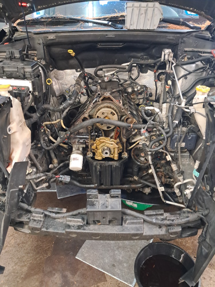

I work for a shop that deals almost exclusively with other repair shops. We specialize in dealer level programming, ADAS set up, electrical and driveability diagnostics which often times ends up with us doing repairs other shops aren't comfortable handling in house.
This particular case involves a 2013 Jeep Grand Cherokee with a 5.7l Hemi engine and a P0303: misfire cylinder 3.
The customer shop did plugs, coils and injectors and the misfire persists.

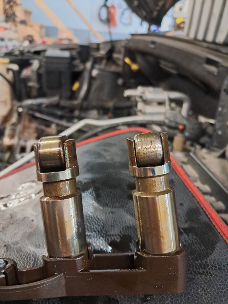

I'm sure we've all been down this path with this engine platform and can make an educated guess as to where this going. Surprisingly, relative compression and in cylinder testing didn't reveal much, but with the odd numbered bank valve cover removed, it's obvious the #3 intake valve is not actuating.
The customer elected to go ahead with engine repairs and we ordered from the dealer OEM lifters, head gaskets, head bolts and a camshaft.
Like most of you I'm sure, I am no stranger to this job. However, when I started the engine it ran VERY poorly! Clanging, misfiring , loading up the cat. It was bad...

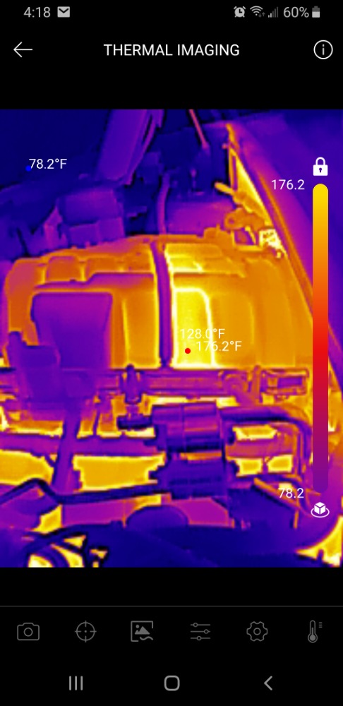

I noticed the intake runner for cylinder #5 was too hot to touch.
A quick relative compression and cam crank correlation showed the timing was correct, but using the sync notch in the crank pattern to index the relative compression pattern, it was obvious there was no compression in cylinder number 5.

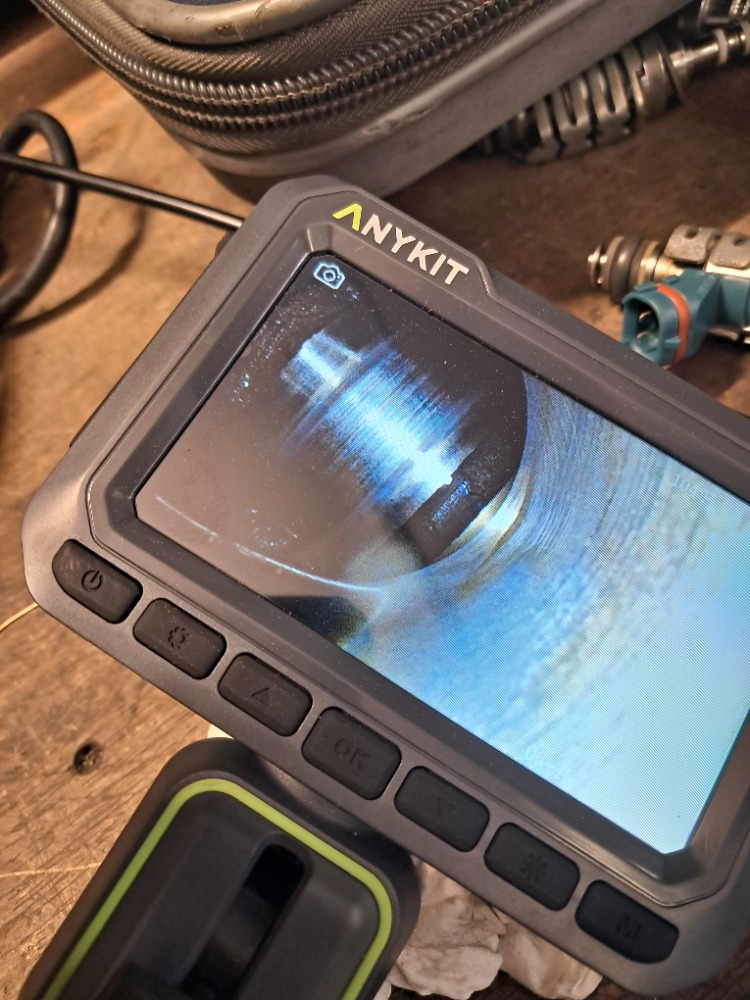

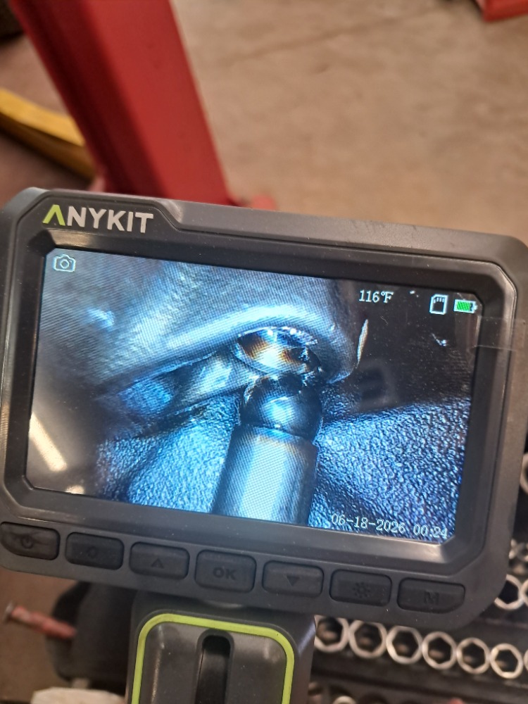

First thing this morning I pulled a spark plug on #5 and put my boroscope in the cylinder. As luck would have it, the piston was at the bottom of the power stroke. No marks on the piston. Flipped the camera up to inspect the valves, fully seated.
Then I began to inspect the rocker arms and found where I had gone wrong. The intake pushrod was not seated in the rocker arm cup, so the edge of the rocker was actuating the pushrod, adding to the stroke and duration of the intake valve, creating overlap which allowed exhaust and combustion gasses to enter the intake manifold.
