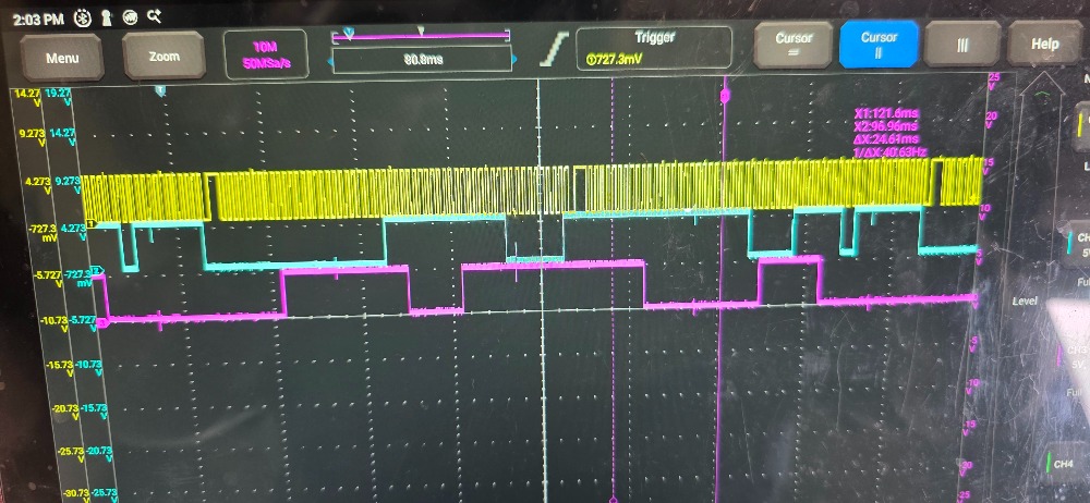

Hello gentleman, need some input with this issue and yes all relevant parts have been check and replace timing chain cam and ck sensors timing alignment check 3 times with 2 different tool kits volts +&- and signals also valvetronic calibration was performed with snap on scanner ,still showing the code at first few revolutions of cranking put a scope to check please let me know what's wrong with this pic check attachment thank you

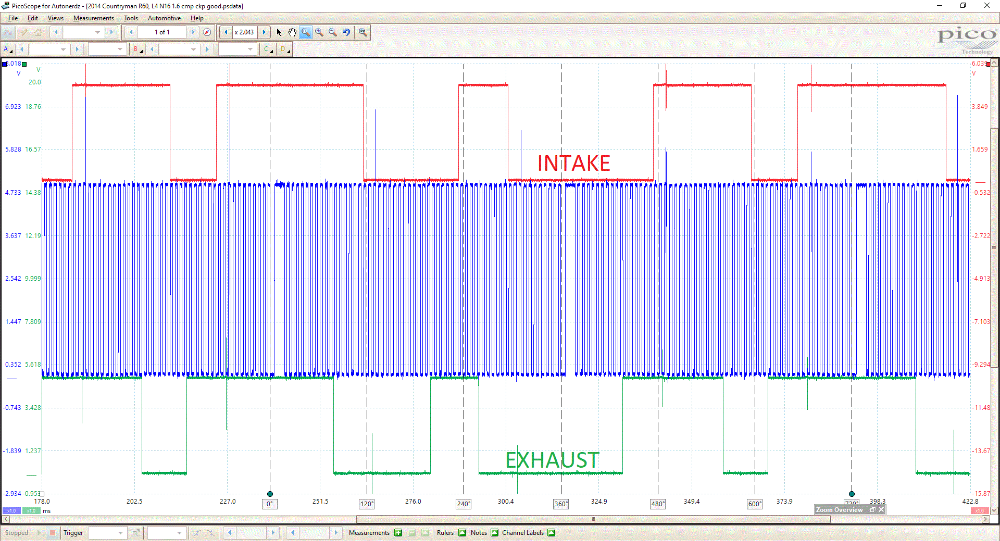

To answer your question "what's wrong with this pic", without a known good example to compare, there's no way to know.
Here is an example I pulled from Diag.net
This is not my image and I do not claim ownership.

good evening , to answer your question yes the parts
are listed as follow
cam sensors I&E replace
timing chain complete with phasers replace
cranck sensor replace , also the 2 solenoids
the picture you have and one i acquired from a non-good example are the same, ground and signal and 5 v are ok, the vehicle runs with no problems other than the code in question , i also try to manipulate the intake cam by moving it a bit and the signal change a bit but not good enough after the first timing change was replace the car was taken to the dealer was send back with the notation that the timing was off that was a wrench in the machine whent back and check the timing 3 times after that just in case look at tone rings cams and crank in details for abnormality's non was found remove and replace the eccentric shaft sensor. no change, note i was wondering if the ECM could be curbing this timing, at this point i recommended the engine to be replaced ,i can only work with what i have we, don't have a lot of access to technology for this particular brand our scanners are limited that's Wy the cavemen approach, with the R&R, the car initially came in with this code p0340 the tech that work on it the first time notice low oil level and not to much of slack on chain, we used Cloye chain kit on this and was throwing the possibility of a defect after it was pass on to me.
