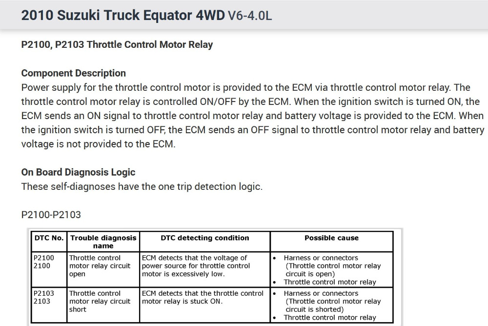

P2100 tps relay no signal
Snap on modis shows throttle relay is off Cannot locate a relay For it? I believe this is my problem
Vehicle starts and runs only idles Gas pedal does not respond when pressed
Accelerator pedal is working tested opening up on scanner I can see voltage changes
Throttle Body position sensor under hood
6 wire connector
No movement from throttle plate
Ground is good
Reference is good
Signal wire There is a signal when I open The plate. By hand No Glitches no dropouts
Question is wires 5 and 6 on my connector failed The integrity test 0 voltage or anything coming out of those 2 wires when I press the accelerator pedal

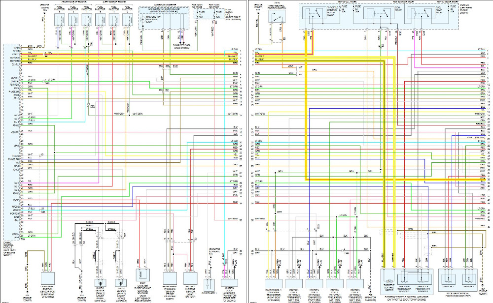

According to my understanding the accelerator pedal sends the signal to the ecm then the ECM sends the signal to the TPS 5 and 6 wires
The diagram on BBB does not show tps relay I'm at a lost please help

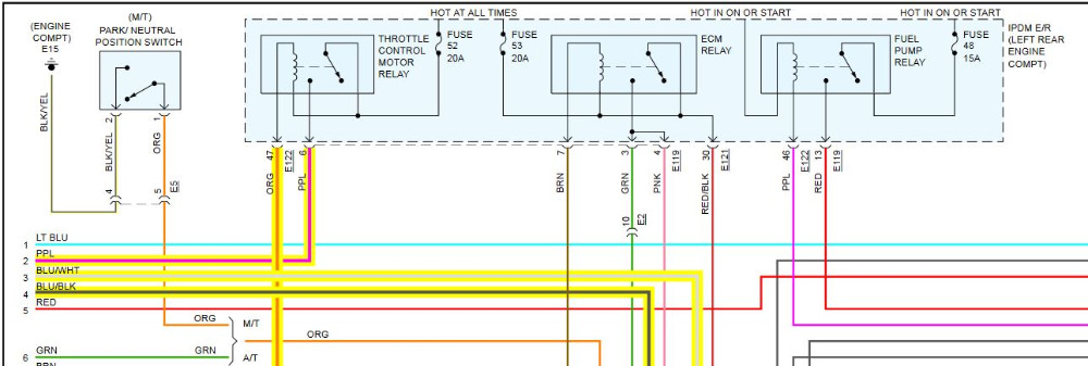

Ipdm On the left is from a Nissan exterior the one on the right is from my Suzuki equator this is the 1 the vehicle came with to my shop and was running before the ecm Went bad which I just changed
The weird part is Diagrams for 2010 Suzuki equator shows the Nissan ex IPDM on the left
Which maybe leaves me to believe the wrong one was put in from the beginning not sure it was running fine before
Sent from my SM-N960U using Tapatalk

The idpm does not have a #52 fuse, After more research it looks like I have the updated version idpm the older version had more relays and fuses , I am more so Betting that the problem is in this idpm in the circuit board
I Wonder why a diagram for a 2010 Suzuki equator Doesn't show my Box
