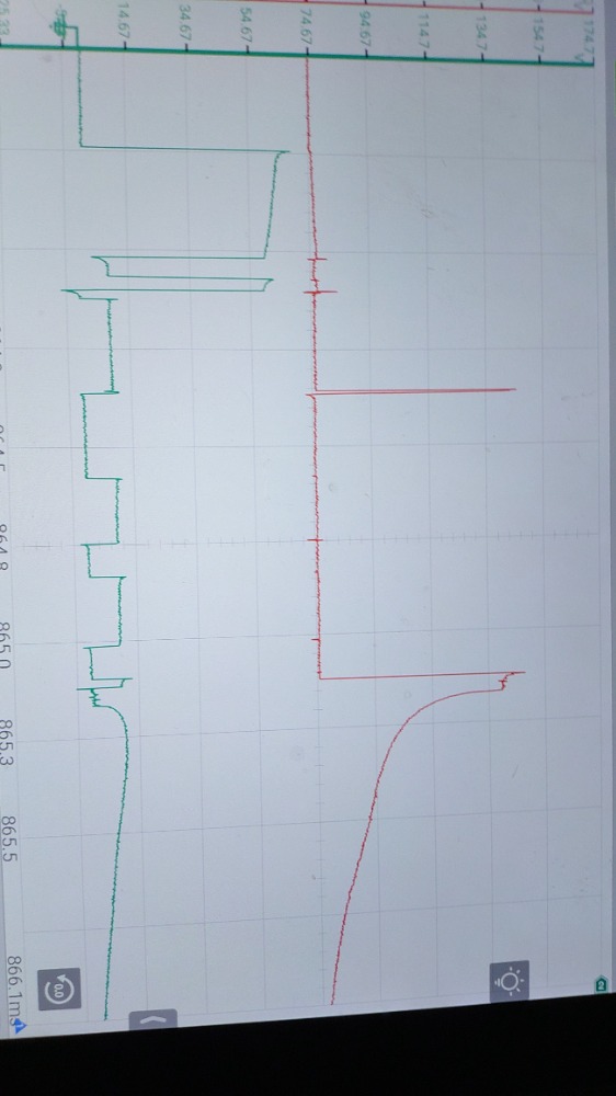

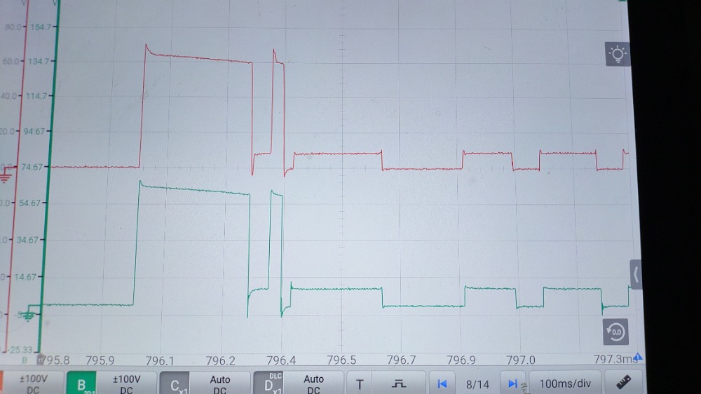

Hey folks new here and I got one that's driving me up the wall.
2013 Ford fusion 1.6 EcoBoost direct injection motor.
-Crank no start
-Spark is good
-Cam crank sync is good
-Definitely getting fuel
-Compression is 180 on all
Basically the engine turns over but seems like it's hydro locking on fuel cranks for a second then locks up cranks for a second then locks up
Does this for about 10 seconds then loses high pressure and cranks normal (still no start)
If you unplug the fuel injectors it cranks normally.
High pressure fuel desires 1500 PSI.
When you start cranking it will build 1500 quickly and then start dropping off and never rebuild pressure.
And it DOES hold high pressure fuel if you let it build and then sit.
Tried replacing high pressure fuel pump, fuel control valve, rail pressure sensor, and injectors
Here are some captures of the injectors

It really sounds to me like the balancer is not installed correctly causing the coils to fire out of time. The cam timing could be an issue, but it sounds more like a spark timing problem if it's kicking back against the starter. Maybe someone went to far and pulled the valve cover to do the timing? Then I guess the coil connectors could be swapped around?

Noah was dead on.
Solution here was simply that the harmonic balancer wasnt installed properly.
I had my suspicions but was told all the timing tools were used during install
I provided all the tools to my tech but since he has never seen a balancer that wasnt keyed that required specific clocking, he didnt think that step needed attention. No worries just a learning lesson to always read the repair procedures to the end and not just until you think you can figure out the rest.
