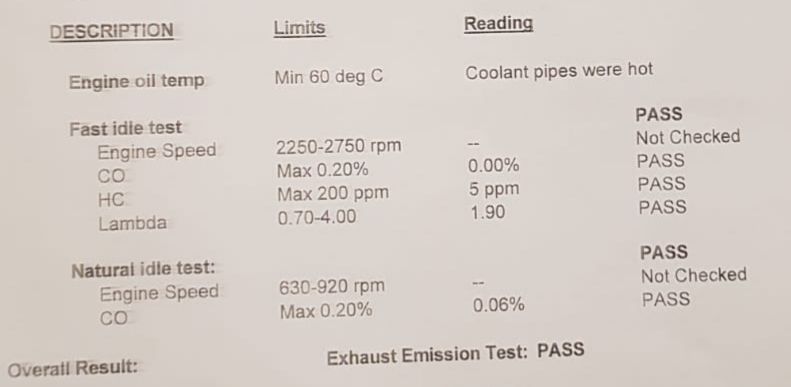

7 years 9 months ago #26505 by steve86
Replied by steve86 on topic BMW E92 02 sensor possible problem.
Hi all,
I had my MOT the other day and it passed the emissions. Attached is some info from the gas analyser.
Am I right in saying, the tests confirm a leak due to the percetage of co2 in the system?
Cheers.
Regards
Steve.
  • Landroverman1958
  • Landroverman1958's Avatar
7 years 9 months ago #26510 by Landroverman1958
Replied by Landroverman1958 on topic BMW E92 02 sensor possible problem.
The only thing i would say from the emissions read out is it does.nt show the oxygen content which would help to show if theres a problem with unburnt o2,it shows that the emssions out the tail pipe are not too rich by the low Hc,and the fact that parts per million are very low,conclusion not rich condition at tailpipe.
The lamba does suprise me that the limit is up to 4?? usually the limit is .970-1.03 lamba for a petrol car in the UK.
7 years 9 months ago #26523 by spit64
Replied by spit64 on topic BMW E92 02 sensor possible problem.
I agree the lambda is to high the engine is to lean lambda should be close to 1
7 years 9 months ago #26585 by Tyler
Replied by Tyler on topic BMW E92 02 sensor possible problem.
Landroverman1958 wrote: The lamba does suprise me that the limit is up to 4?? usually the limit is .970-1.03 lamba for a petrol car in the UK.
Agreed. :ohmy: It almost makes me wonder if the vehicle is intentionally set up to run lean under idle conditions? No vehicles that I've seen in the US work this way, but that doesn't mean anything. :lol:

7 years 9 months ago #26716 by spit64
Your brain is sharp Tyler this is BMW with stratified charge
The Direct injection allows to execute “slightly” different principle of operating:
throttle can be opened “wider”, by this reducing the tenuity in the intake manifold and also energy necessary to create it. N53, for example, allows to intake 3 .. 3,5 time more air than would be needed for fuel combustion, it means, Lambda = 3 .. 3,5;
if the nozzles inject fuel a moment before fuel ignition and in the immediate vicinity of spark plug, normal fuel ignition is possible: even if the average mixture (in all combustion chamber) is lean (with Lambda to 3 .. 3,5, it means, air “leftover” is 3 .. 3,5 times), in direct vicinity of spark plug it is “rich” enough (Lambda below 1) and ignites very well.
Stratified charge creates significant gain for N53 engine: 25% fuel economy in load of 0 .. 10%, 20% fuel economy in load of 10 .. 30%. Percentage of economy decreases to 0%, when 60% of load is reached. For example, if we drive with 90 .. 120 km/h, N53 works with load till 30%, it means 20% economy comparing to “regular” BMW engine. Fuel economy for N43 is a bit smaller, but in average it creates at least 15%.
Additionally to fuel economy, such engine can maximize performance in area of middle load – in each cycle fuel is injected in 2 .. 3 portions, each portion being injected in it’s own – more optimal injection moment.
