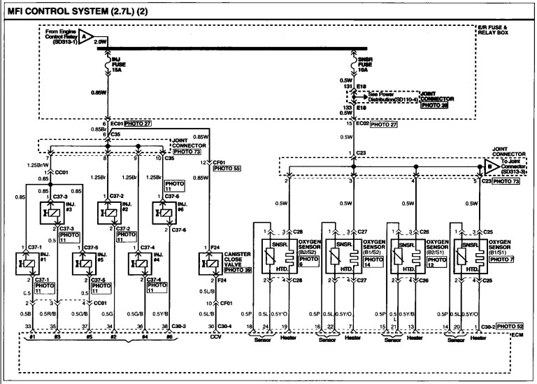

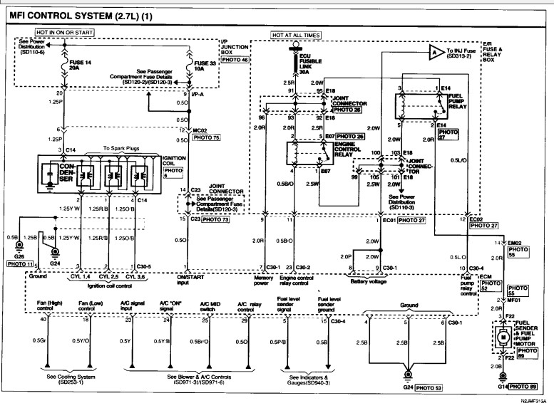

Hello. So the car has no codes. It cranks good but won’t fire. I have spark and fuel. The only thing I’ve noticed so far is the control side of the fuel pump relay and a fuel injector read 4.1 volts. When the computer grounds them they drop to zero. Not sure if that’s normal. On one fuel injector is being pulsed at 1.1 hz. Not sure where else to look. Any ideas ?
7 years 9 months ago - 7 years 9 months ago #26536 by Paul P.
Replied by Paul P. on topic 2006 Hyundai Tuscon 2.7 crank but no start
The 4.1 volts doesn't sound so good, was this measurement taken at pin 3 or 5 of the Fuel Pump Relay? Is there a difference at these two pins when It is KOEO and KOECranking?
Very curious as to why 4.1 volts.
Fuel Pump Relay(FPR) Control Side:
-Pin 3 FPR is the ECM GND CTRL wire
-Pin 5 FPR is 12V from Engine Control Relay
May have to test what is happening when the contacts close on the Engine Control Relay, you've got some serious voltage drop somewhere.
I've attached diagrams for you.
Attachment not found

It was taken at pin 3. Pin 5 shows battery voltage when the main relay turns on. As soon as the ecm grounds pin 3 it drops to zero. It almost seems normal.

7 years 9 months ago #26547 by Paul P.
Replied by Paul P. on topic Re:2006 Hyundai Tuscon 2.7 crank but no start
If thats the case your losing ~8v inside the Fuel Pump Relay, there should be 12 volts on pin 3 and 5 before the ECM grounds pin 3!
A little trick you can do is wrap a strand of wire of sufficient length around pin 3 and 5 and install the relay so you can put your meter on the strands.
You measurements indicate a bad Fuel Pump Relay.
Try swapping around relays with another that isn't required for starting.
