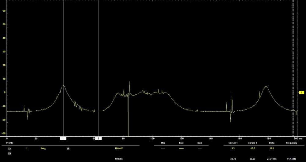

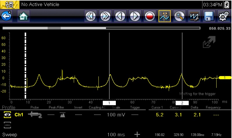

Oldsmobile Alero, 3.4L, misfire complaint, audible compression problem during cranking :lol: I take the opportunity to break out the in-cylinder transducer and get a running waveform:
I *think* I'm looking at an intake valve stuck closed. Yeah, it's low compression, but it's also going into deep vacuum in the expansion pocket and the intake stroke. No way we're going into that kind of vacuum with a burned valve or a hole in the piston.
I also see a very gradual slope coming off the exhaust stroke and into the intake stroke. Usually, it's a pretty sharp change in pressure when the intake valve opens, and this is much more gradual.
What say you? Am I on the right track? I'm pulling the valve cover off tomorrow, so we'll find out anyway, but I'm mostly interested to know if you think my interpretation of the waveform is correct. Thanks!

I see what you're saying about the massive vacuum, and that certainly supports a stuck closed valve. Just trying to tie the low compression into that..
What is the voltage to pressure conversion?
Curious to see how this one shapes up, keep us posted!

Don't own a transducer yet so hope I'm not wasting people's time too much but could it be a worn cam lobe or collapsed lifter? Is it feasible the lack of air in is enough to limit the compression pressure that much?

Noah wrote: I see what you're saying about the massive vacuum, and that certainly supports a stuck closed valve. Just trying to tie the low compression into that..
Oh crap, my bad! The conversion is 1mV per PSI.
As for the low compression, I'm thinking along the same lines as Matt:
Agreed, I think it's the lack of an intake stroke that's preventing compression. Worn cam lobe or lifter problem is on my mind, but my money is on...

Would it be wise to do a leakdown test before disassembly. If it's low comp but little leakdown then that proves our theory. Obviously if it has huge losses then there's other issues. Just typing that though a leaking cylinder may not be able to pull such a large vacuum though?
Nice thinking, sir! I actually did do a leakdown test after getting the in-cylinder waveform. Partly to confirm the theory, partly to get more ammunition for pulling the valve cover. Came out at 10-15% leakage.
If it turns out that it is an intake valve problem, then I'll feel more confident in connecting the high vacuum with low cylinder leakage B)

No worries! I honestly didn't know what to make of this waveform at first. I was convinced there had to be a leak, but couldn't explain why the exhaust valve opening was so clearly defined. I'm still a long way off from feeling truly confident with the pressure transducer :blush:

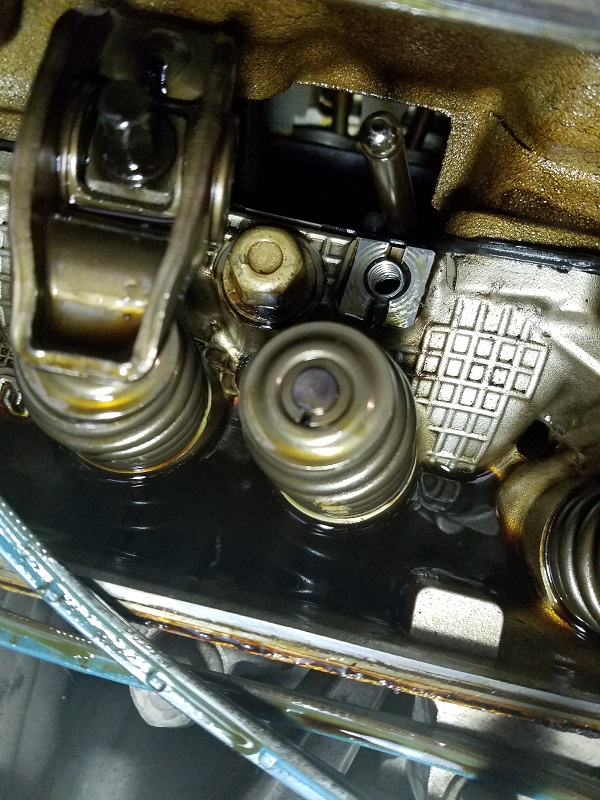

Sorry for the delay, but finally tore into this one Friday morning...
drive.google.com/file/d/0BwIz-f3J815JeVl...UVk/view?usp=sharing
Yup, pulled those threads right out :lol: A thread insert and some Loctite later, and it's back to making compression. How long 'till another rocker gives up? Who knows.
Thanks for your thoughts and input, everyone!
