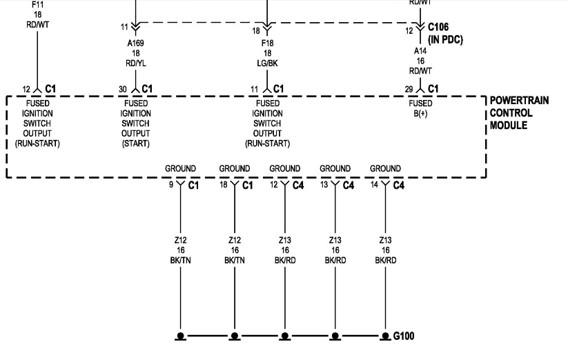

10 years 3 months ago #359 by Tyler
Thanks for getting back to us, sir!
So I totally struck out on the 5V reference circuit, was totally expecting you to find none. Oops!
It's awesome that you've already done PCM power/ground checks, those were the exact pins that I was going to suggest testing on. busjockey is right, though, voltage drop testing with backprobes is the best way to be certain in these cases. Either that, or substitute a load for those wires using a tail light bulb.
5V ref is there, powers and grounds looking good, doesn't bode well for the PCM! Poking around on the BBB Industries site, I actually found a different power/ground diagram with some additional pins. Take this with a grain of salt, as I'm not positive that this is the correct diagram. Just don't want to miss anything before calling a module.
Thought about a Chrysler 8V CKP/CMP/VSS circuit, but the diagram says these hall effects use the 5V reference instead. Still, might be worth checking either the cam or the crank sensor for a reference voltage. Finding zero would suggest that there IS a separate reference circuit.

10 years 3 months ago #464 by Noah
Last I checked, I could not communicate with the PCM through my scanner. And everything was plugged in. My meter did not die, just showed 0 RPM while cranking.
I'm still confused by this. I'm not nitpicking here, but if you can't communicate, what are you looking at for an RPM pid?
I may be biased, but I don;t have problem with used PCMs from the salvage yard. Sometimes a good used factory part is better than a brand new Made In China unit.
10 years 3 months ago - 10 years 3 months ago #465 by Noah
Attachment not found
Are you using a diagram or pinout to ID the pin numbers?
This would be disconnected, front probed....
I think...
definitely check the colors of the wires to be sure.
I've got 4.47 volts between pins 1 & 2. 5.17 between 1 & 3. and .72 between 2 & 3.
So with 1 being signal and 2 being sensor ground, 4.47v seems high, but plausible.
1 being signal and 3 being 5v supply 5.17v I cant quite make sense of that yet
2 being ground and 3 being 5v supply, .72v says red flag
Just check them all with the negative lead of your meter on the negative post of the battery, and if you think of it, post the readings with the wire colors please.
Last edit: 10 years 3 months ago by Noah.
10 years 3 months ago #466 by Noah
Also could someone post a schematic of this Pci Bus system? I don't have one but if someone could post it I might be able to help with this. I have quite a bit of experience working with no Comm issues on Buses. This might be a little different, but the concepts still apply here.
This is all I could get BusJockey
