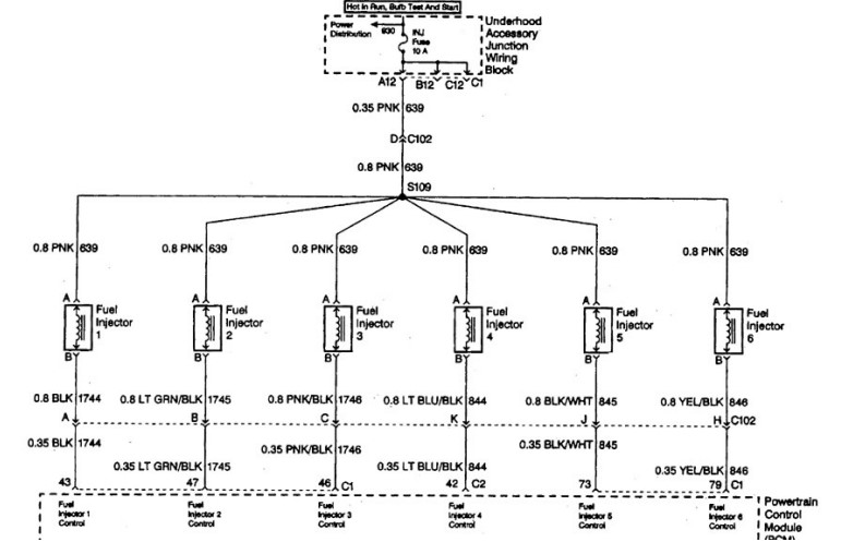

99 Montana Pontiac 3400 v6 motor / mini van. Stalled out while driving turns over fine but will not start. Watched the How to test a GM ignition module (crank sensor bypass test) which was helpful but have some other issues which confuse.
Could not trick the module to fire/spark with the T pin test on the crank sensor input wire & test light (like the video)
And continued to diagnose and found the power input connector measures ground on both wires ign on.
So have diagnosed the problem thus far as the ign module not being properly powered up when the key is on. So makes sense I would be in a no spark situation here.
Ign relays and fuses appear to be fine
With an external separate connector wired to battery and ground plugged to the power input of the ign control module restores spark while cranking. So believe the module and coils are fine based on that. But am still in a no start situation. even with the module "hot wired" to power.
From what I can see while operating the module with the fly leads to power it, the fuel pump does cycle when the key/ignition is turned on. And I am getting fuel pressure.. So assume now I am not getting fuel and something related to or that shares the Ign module power input maybe effecting injectors/fueling
Looking for a suggestion of where to look next in a situation like this where both power wires power to the ignition module seems to be grounded.
Only module code is a P0043 Evap Emission System purge control valve circuit. Don't know if that would point in any direction. might mean something if power for that was also shared by the Ign control module but figured worth mention

wcarrothres, I see that you've jumped direct B+ to the pink wire at the ICM, correct? Where are your other jumpers connected, exactly? You mention both power wires at the ICM being 'grounded', but there's only one power feed that I'm aware of.
For our info, what are you using to do your testing? A Power Probe?
When you said you checked the fuses and found them good, how did you check them? I ask because the ELEK IGN (which is the ICM power feed), INJ, TCC, IGN 1 U/H and A/C CLU are all powered by the IGN MAIN relay. It'd be valuable to know if all those fuses are powered with the key on. Sorry if you've checked this, just wanna be clear! :cheer:

7 years 8 months ago #26963 by Tyler
Replied by Tyler on topic No spark Montana
wcarrothres wrote: So when testing the A and B power input to the IGN controller (pink isa and black wires) they both test to ground with a digital test lamp. And if I use a standard meter black to pink I measure 0 voltage when key on.
When I'm describing powering the unit my self, I'm doing that with a separate connector plugged into the Ign control power input plug with the wires alligator clipped to battery and ground. Doing this to verify I'm getting spark when turning over the motor.
So the pink and black connector in the wire harness was disconnected during this test.
So you depinned the ICM connector and inserted your own jumpers into the pin cavities for the main ICM power and ground? No problem if this is what you did, just wanna be certain.
Fuses were checked visually and with test lamp but. I did hop around the fuses in your list with key on with the test lamp and from memory don't recall anything weird.
I believe the IGN relay is functioning properly when key on but will add your list of items to my list to double check
No problem, let me know what you find. :) I like the IGN MAIN relay theory, since it neatly explains your symptoms. But, I could be way off. :silly:
But something related to no power to IGN module is probably causing me at this point to have no injector pulses (I have not verified injector signals but it's on my list)
my original thought was I had no spark but also turns out I probably have no spark and no fuel.
Pump is running but need to check fuel pressure. poping the fuel valve on the rail looks like I have plenty of pressure but understand is a crude way to verify that.
This is why I suspect an IGN MAIN relay issue, as the same relay supplies the power for the fuel injectors. That'd account for the (seemingly) good fuel pressure but no start.
The power distribution diagram might help anyone following along. The fuses we're after are on page #2:
File Attachment:
File Name: montanapow...tion.pdf
File Size:581 KB
If those fuses check out for power with the key on, then I'd suggest moving to C102 to check for injector power and control. For clarity:
C102 is the bulk connector that contains all six injector control wires, plus the injector power feed. C102 is usually on the firewall side of the upper intake plenum, near the alternator. Find the solid pink wire (pin D), and check it for power KOEO and backprobed.
