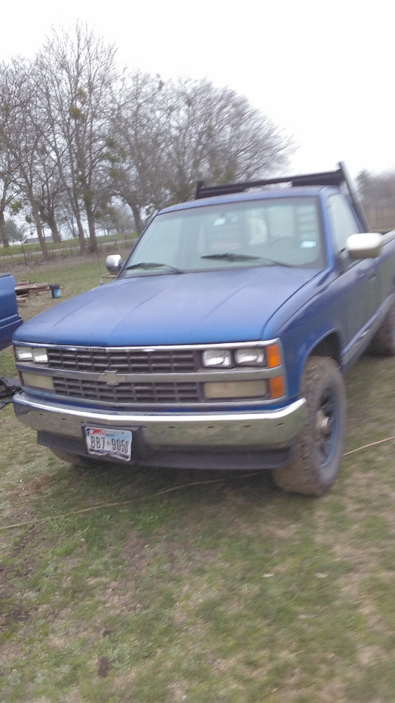

89 Chevy Silverado issues.

Somehow I missed a couple of your messages. The way you described the surging even when cold would make that map sensor much more suspect. I think you’ll see that signal moving around. Look very closely at the vacuume line,it may be collapsing on you or some crap in it. Use vacuum rated line on it only.

I checked the timing with the engine running, the pointer is moving back and forth abt 1/2 inch. I tested the MAP, the signal voltage is all over the place, fluctuating from 0.88 vdc to 2.55 vdc. its fluctuating so fast, you can hardly read the numbers. it has the 5 volt refrence on the other wire, and a good path to ground on the remaining wire. I removed the map sensor to get a good look at it. the backside looks like it has melted sone in the corner. I dont know if this is from an internal problem or if it was heat from the outside near the engine. it sits on a bracket well off of the engine.. im thinking the MAp is the culprit. I would think that the timing moving around is due to the map being bad and the ignition module is just doing what its signaled to do when the map signals it.
Im going to get a new sensor tommorow and see if that fixes it. the sensor should not have a hot melt spot on it, and I dont think the voltage should be fluctuating that fast or that much. probably 5 different values a second. like a confused calculator.

7 years 8 months ago #27453 by Rockyroad
Replied by Rockyroad on topic Re:89 Chevy Silverado issues.
Congratulations, I knew you’d find it. I know exactly what you mean on the Murphy’s law and apparently the old German lady did too. I’d also have to pass any thanks on to Paul as well. On the fuel mapping and what the ecm is thinking start at MOATES.NET and poke around and then EFI LIVE. I think you’ll find them interesting.
Also, I’m not positive, but I think the voltage swing max to min should only be about 1.5v on these map’s. If you had something like a mityvac hand pump to apply a steady 19 or 20” of vac, you could remove the variable of fluctuating engine vac. For future reference.

did some research and the map does control fuel and spark, so I see why the ignition is moving around. would also explain the occasional backfire. the engine is a confused mess..... signal jumping around, idle jumping around. if the map controls timing and fuel, I wonder how it interacts with the TPS. THE TPS is also sending a signal voltage to the ECM. Im thinking that once engine is off idle the tps may take over the fuel parameters and the MAP sends signal to the ecm to advance timing thru ignition module.. just a guess. but they both cant be controlling fuel and timing> these years dont have crank or camshaft ref sensors.
