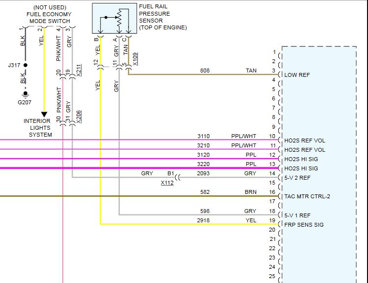

I have a problem in a chevrolet Equinox 2010, The code set on scanner
P0228D and P0089
With reduced engine Power
Any help please?

Replied by Chad on topic Chevrolet Equinox Set A Code p228D and p0089 Reduced Engine Power
I would look into your fuel pressure sensor.

I like pole71's suggestion to investigate the rail pressure sensor. A quick check is to run the low pressure pump, observe the low pressure sensor, and compare to the rail pressure sensor. They should match within a few PSI.
Similarly, if you use the bidirectional test to bleed rail pressure, then the rail pressure sensor should read zero.

Replied by aboudehsayed on topic Chevrolet Equinox Set A Code p228D and p0089 Reduced Engine Power
Thank you so much guys, for your interest, i use all the data you gave to me, my problem has been solved when i unplug the Fuel pressure sensor located underneath the vehicle on the fuel line from the fuel pump all the way to the engine , and everything is ok, i will do circuit integrity test before replacing the sensor
