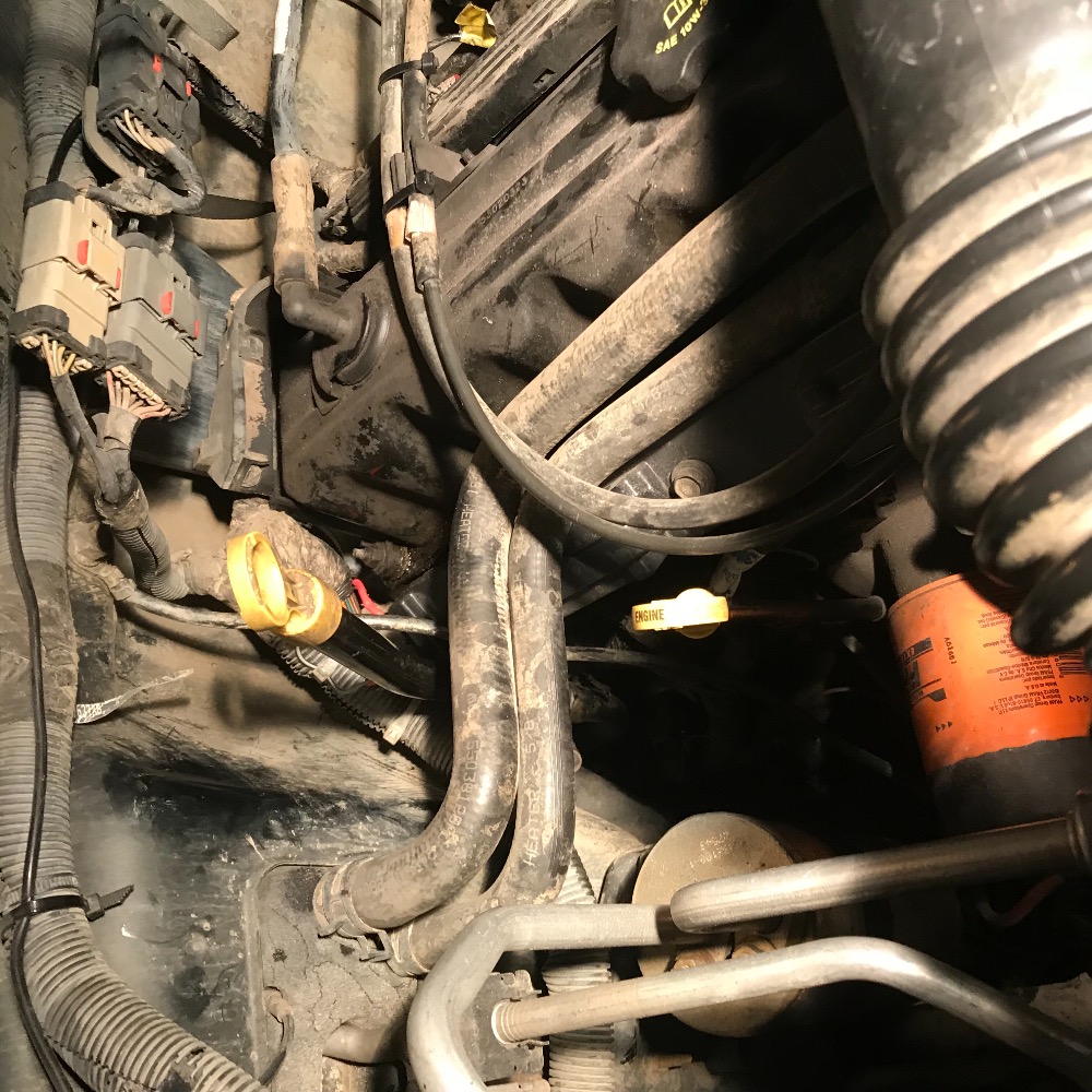

Picture of engine bay wiring harness around the rear of the valve cover rubs and i did find one wire broken and i have repair it cam and crank corelation issue when cold

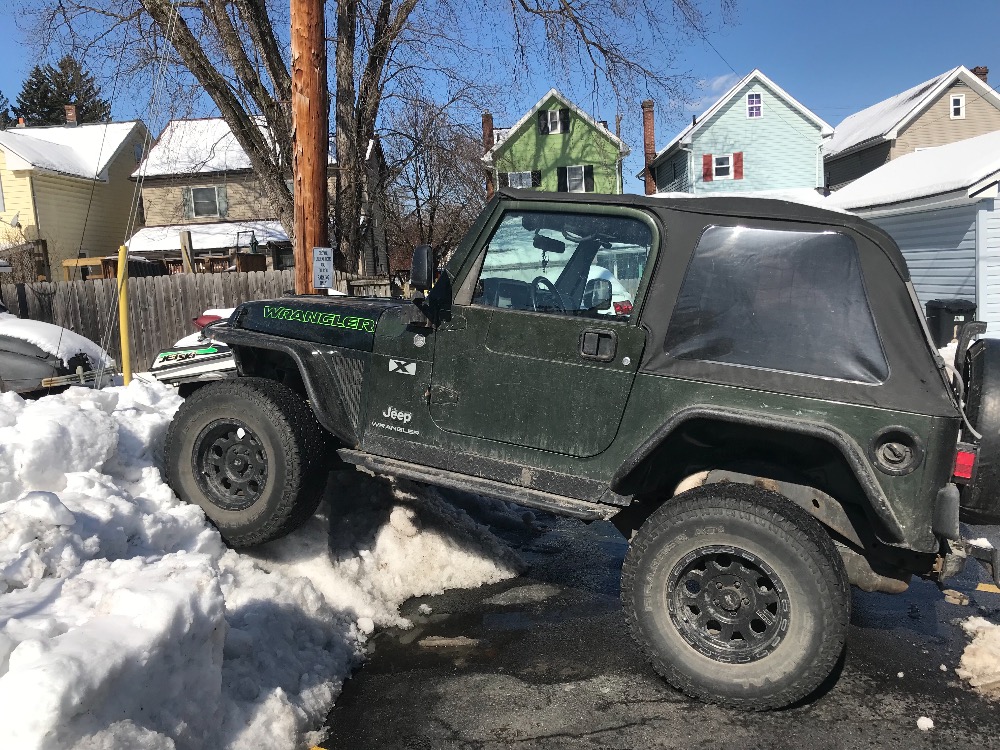

Wrangler tj 2005 4.0l auto with abs ac cruise control

Yes i did while posting my issues lol and problem solved i did danners #1 rule wrong and changed just about everything on the jeep a ended up right back at the cam sensor i had replaced it 3 times with all bad cam sensors from autozone my signal wire would read correctly when the sensor was hot but not when it sat outside for a few hours so i tested the cam sensor when warm good then waited two three hours when temp on engine was cold not signal coming from cam sensor replaced it with one from carquest repeated test same way 100% fixed for past two weeks then checked the two i took off over past year all did excactly same thing autozone junk!!!!!! If id of done this sooner i would have saved money on transmision limp mode kit, all tranny sensors on valve body speed sensors cam sensors crank sensor tranny fluid atf+4 and alot of my time!!!! Luckily it my own personal vehical so chalking it up to lesson learned the hard way and perventive maintance since the 4.0l only has 116,000 miles thank you for responding (Dont buy autozone!!!)
