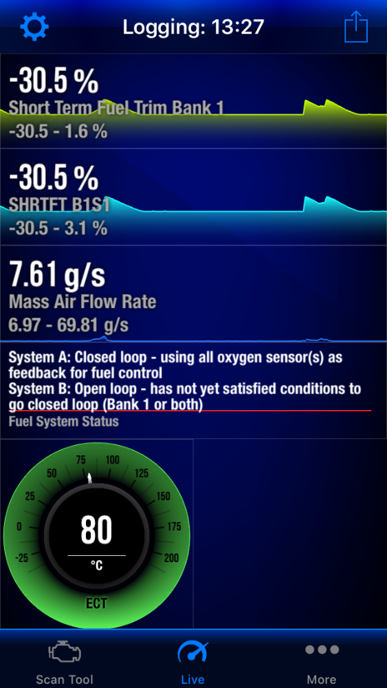

1997 Chevy 5.7 vortec
- Nick67410
- Posts: 1
7 years 8 months ago #27440
by Nick67410
1997 Chevy 5.7 vortec was created by Nick67410

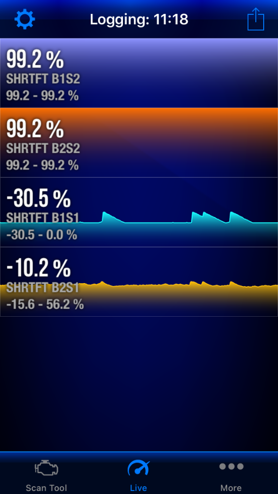

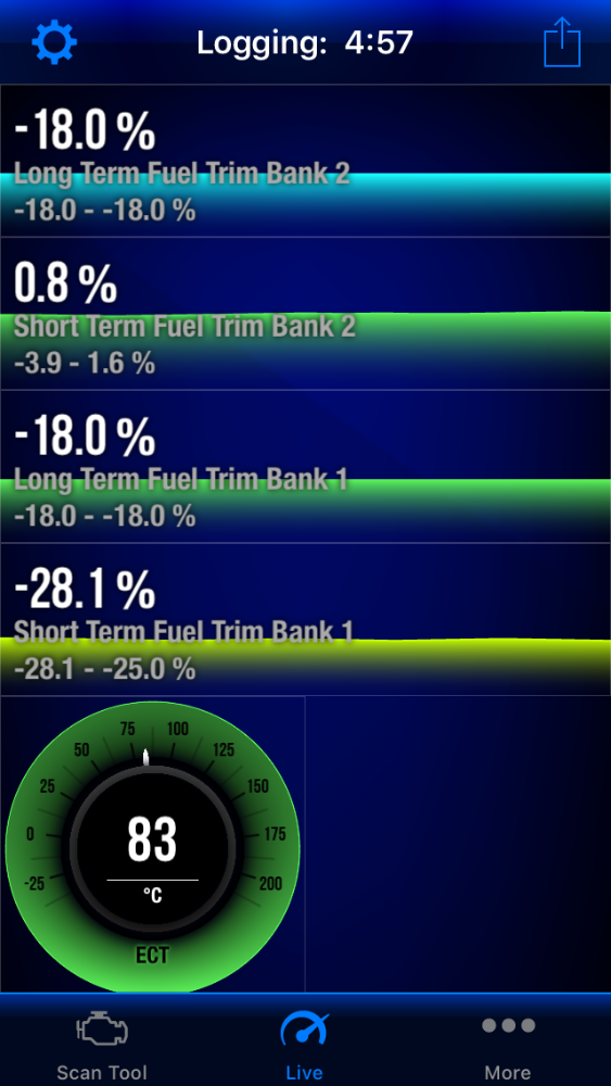

any o2 sensor readings? could have a stuck rich one on bank 1

Is this at idle? Maf reading looks high. I don’t help people who use metric units.
Just kidding...about 180°f for those without an conversion table

Both, bank 1 and 2 are running rich (at least for PCM). PCM is subtracting fuel in bank 1 faster than in bank 2 (acumulated percentage in bank 1 is bigger).
7.6 g/s is normal according to past readings i have made in one of those engines. At 80 degrees system should be in closed loop.
Please post O2 readings for better undestanding.
