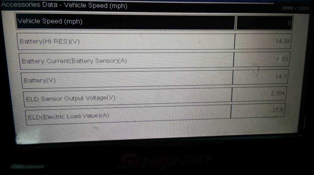

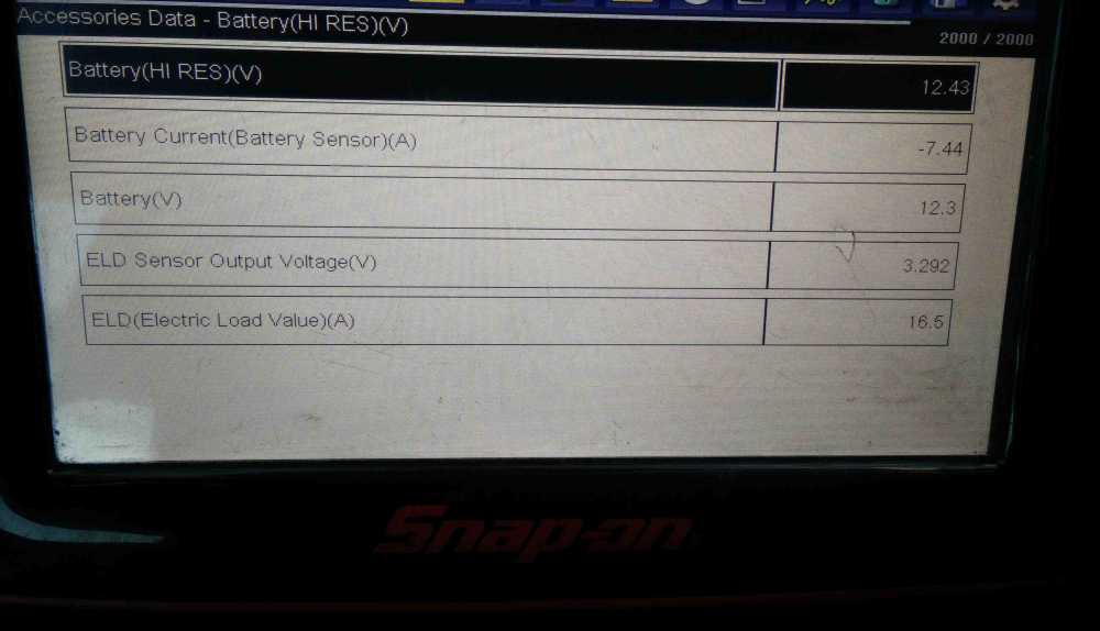

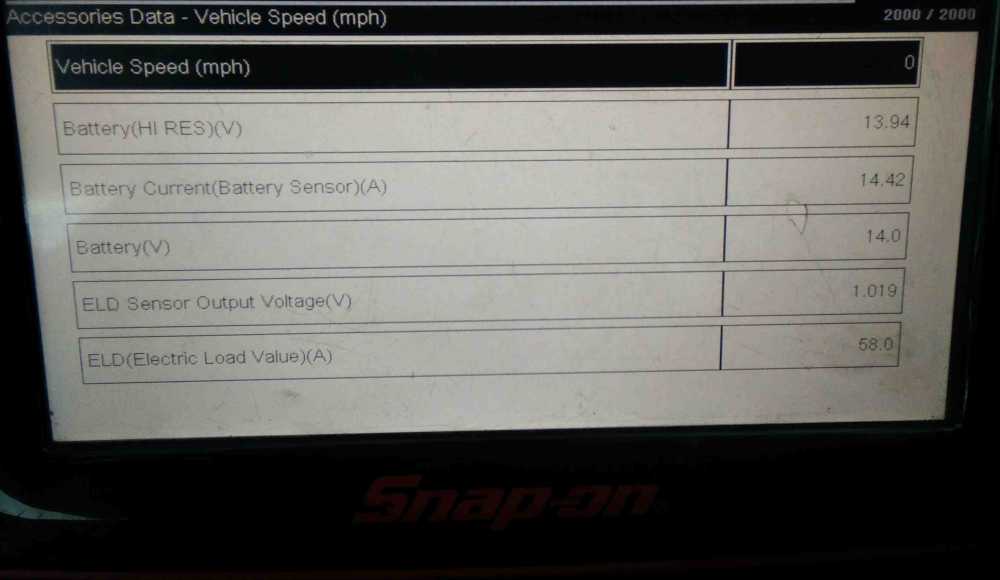

9 years 11 months ago - 9 years 11 months ago #3494 by jaivs26
Replied by jaivs26 on topic 2014 Honda Civic charging issue!
hey tyler!
this problem started 3 months ago and is was not all the times i'm going to only happened 6 or 7 times in those 3 months.
the owner told me that last monday the car started ok in the morning he drove for 20 minutes and then he stopped to the post office, 10 minutes later the engine didn't want to start , at that time he had to use the jump starter to make it home which was 2 block away
he installed and refurbished alternator and that alternator is not charging at any RPM or load
i installed the old (the original ) back and that alternator sometime is charging under load and sometimes is not
today i went to the autoparts and i got a another refurbished alternator as a warranty i installed and it seems to be working ok now
i'm going to let them drive it for a few days to see what happens..
i'll post any update
here are some pics of my last test drive

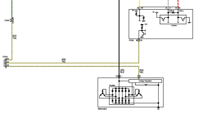

Nice scan data shots, thanks sir! Looks like it's got the good ol' ELD and a battery current sensor... Both look to be producing rational readings :huh:
For anyone else interested, I looked up the diagram for this one. I'm used to the four wire control system that Honda used for years, so I was surprised to see this:
The grey and red wires going to the PCM are CAN network lines. The yellow wire, I'm not really sure. For your own diagnostic purposes (and my curiosity ;) ), it might be good to get a voltage reading on that wire with the system charging. That way, you have a known good basis if you catch it not charging again B)

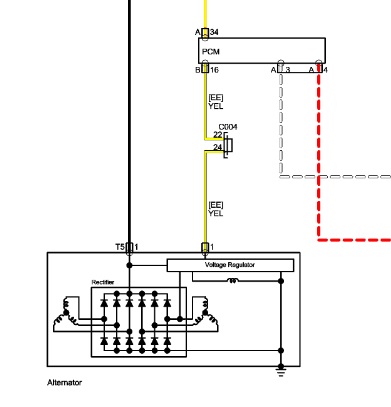

So, I did some more digging on this one, curious about the control circuit. Ended up finding a different diagram for this Civic - the first one didn't include a Battery Current Sensor, but we know that your Civic has one based on the scan data. This new diagram does include the sensor, check it out:
The yellow wire that goes to C014 goes up to the signal wire from the Battery Current Sensor (which has three wires total, power - ground - signal). So, the PCM provides 12V to the sensor AND the alternator, but can also ground the signal at times?
Now I'm really interested to see what you find :cheer:
