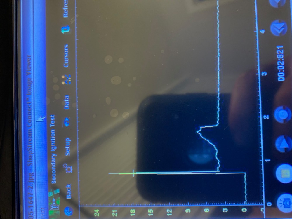

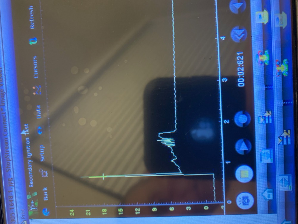

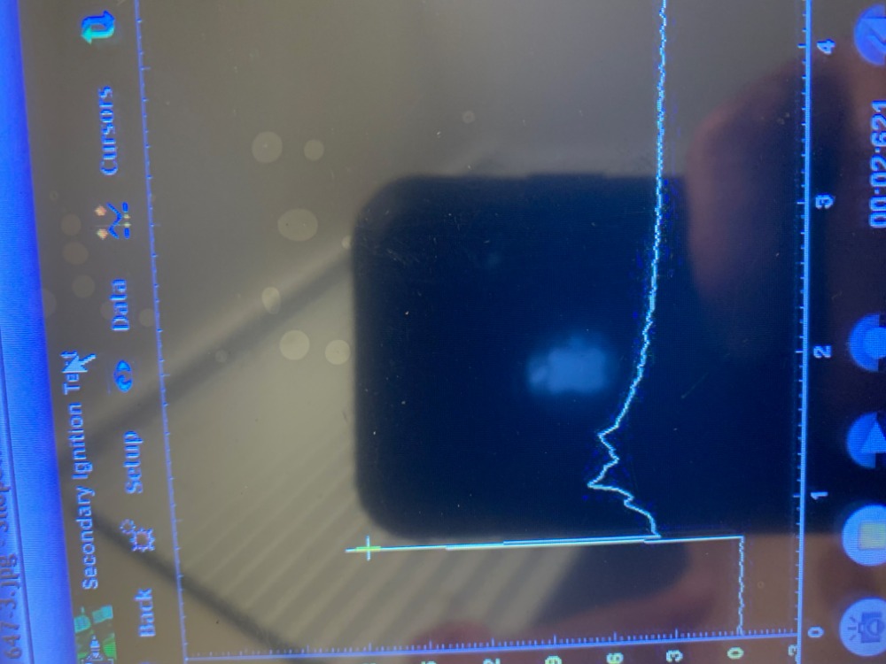

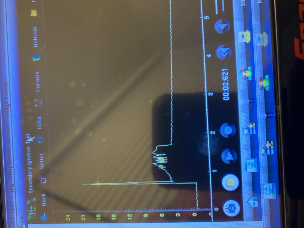

Good evening,
So I am back in the automotive field after being out of it since 2012. I was working on a 2002 Chevy S10 with the big V6 4.3L. It had a P0300 (Random Misfire), P0341 (CMP Sensor Circuit Out of Range), and P1345 (CKP/CMP Correlation Problem). After scanning the vehicle I checked the retard and it was 0 degrees (I remember the gear on the distributor would always go bad and the retard would be roughly 20 degrees). I went to the fuel trims and they were in range. I pulled up the misfire monitors and saw cylinder number 3 was missing and all the other cylinders were not. I pulled out my Verus and checked the secondary ignition waveform and was noticing a lot of turbulence in the firing line. At first, I was thinking fuel so I checked fuel pressure and it was good. I did the fuel injector balance test and all my pressures were the same so that ruled out an injector (I remember these injectors always going bad). My firing line was good so I ruled out a secondary ignition problem. The only two things I can think of are a possible worn cam lobe or a leaking valve. The misfire happens at random times while the engine is hot (DTC freeze frame data showed 194 degrees), but I have not checked it cold yet. One last thing, I through a vacuum gauge on it and the needle was steady at 20 in.hg. if that is any help (not an expert with a vacuum gauge), but I thought maybe it would help me if there is a valve seating issue or worn cam lobe. Any help anyone can provide me is greatly appreciated as I have lost a lot of my diagnostic abilities these last few years. The pictures attached are from this truck while snapping the throttle.

Thanks Doc! I did check my power, ground, and signal wires at the CKP and CMP sensor. Also, I did scope the signals on both and as the engine was misfiring, there were no drop outs in the signal. I was just curious why there was so much turbulence in the secondary ignition wave forms I captured. I am going to do a running compression test, but the customer will not be back until after Spring Break so I still have time.

So that vacuum gauge was steady at 20 in. hg., even while misfiring. I did not do a relative compression check, but that is probably the first thing I should have done. I guess I didn't think about it because it was an intermittent misfire and only did it while the engine was hot. However, I did do a running compression check on it and the snap throttle and cylinder number 3 was significantly lower at idle and the snap throttle. So, I pulled the valve cover off and noticed the valve spring was breaking. Thanks for everyone's help! I am still curious about the secondary ignition waveform though. I guess I will have to research that to see if that was the cause of all the turbulence on the firing line.
