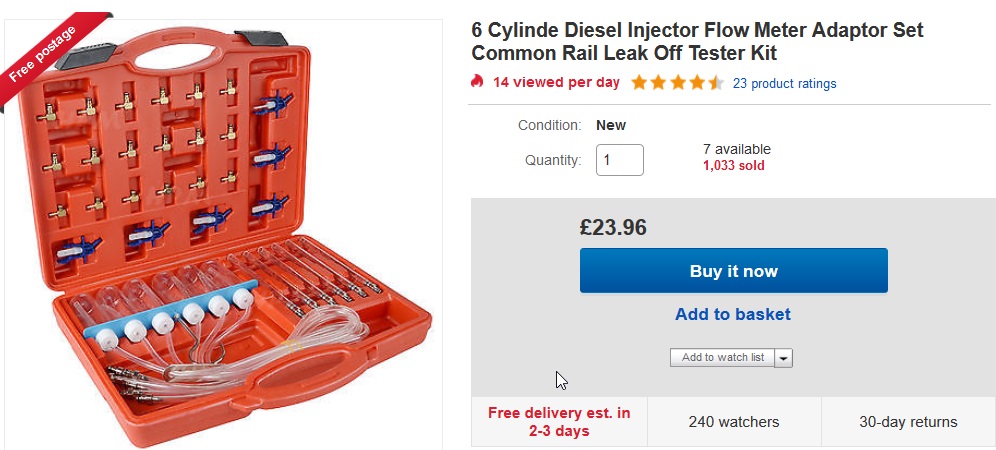

However as diesel age the leak off becomes excessive and I strongly suspect this is your problem. The injector correction value pids may give you a clue to this but I would actually measure the injector leakage. You can improvise the kit required to do this test but the kits to do it are quite cheap on ebay.

I have one of those kits Andy, bought it but never used it.......Yet!
