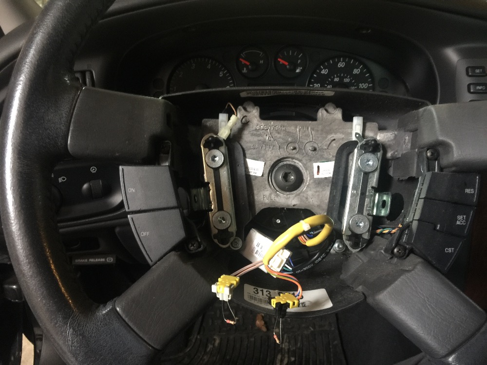

Hi guys this is related to my other thread Re: the airbag on this car.
To do the tests recommended in the other thread, I need to remove steering wheel to gain access to airbag module and clockspring and wiring. I have removed the upper and lower clamshell around the emergency flasher switch and ignition lock cylinder. But I still do not see how to gain access to the steering whee bolts.
Advice?
Thx pop
Advice?
Thx pop

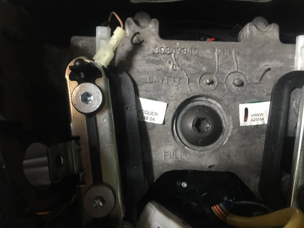

Yes, I got it off and ran my first resistance test with the 2.2 ohm resistors across both the primary and secondary inflator wires. Computer still flashing low resistance code, so have to pull shell to get at clockspring.
Looks like to rx bolt has to come out, and then I need to attach a puller at the points marked PULL. Of course will have to disconnect some wires first.

Can you get to the clockspring connector by pulling off the lower column shell? That'd allow you to confirm a shorted clockspring.
Definitely try pulling the wheel off by hand first if you don't have a puller around. Applying pressure with your knees while wiggling back and forth with your hands has occasionally worked for me.

Re pulling the steering wheel ---- to prevent injury as it can come away from column suddenly and smack yo on the face ( guess how I know !) just slacken the centre bolt off enough to leave 1/4" of threads exposed. Then pull at one side of the wheel while smacking the the back of diagonally opposite side with the side of you fist or a rubber mallet.

OK, Got steering wheel off yesterday, (I carefully used a two-jaw puller) and I have to admit I am now stuck about how to take the clockspring off. Looked but can't find any good how-to's on it. I don't want to just pull on it as I don't want to break it, especially if it is not the problem. Looks like I might need to remove the dash kick-panel piece to access the clockspring-harness connectors. Once I do that, it seems to me I need to connect the 2.2 ohm resistors to the connector holes that correspond to the appropriate wires on the clockspring that ultimately lead to the connections on the removed airbag and then turn ignition key to ON and see what airbag light does.
Any pointers for this step appreciated!
