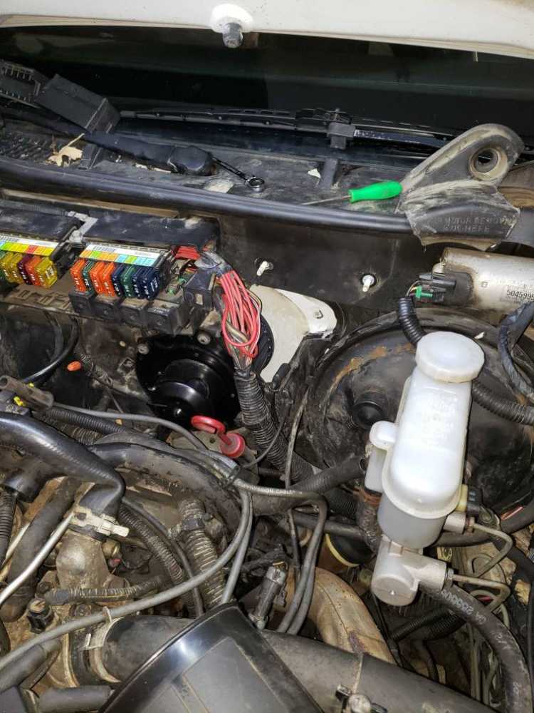

I've dug and dug online and no luck. Helping a friend out. This Deville has the 4.9 Engine, it's not the Northstar engine.
Anyways the blower motor went out. I've searched 92 Cadillac Deville blower motor replacement and other search queries and no luck. I've seen 93 Devilles with a more flat profile motor. I did see in one place online where it said to cut the box of the motor mount housing then I went and looked at it and there was some lines there drawn on the outside.
Am I supposed to use a saw and cut both lines and just bend the metal to get it in there or how does that work?

Replied by Noah on topic 1992 Cadillac Deville 122,700 miles , blower motor replacement
www.justanswer.com/car/1au0y-1992-cadill...ower-motor-cuts.html
According to this, the "cut here" area is so you can remove the blower assembly without having to take the fan off inside the box (really GM?)....
So I think you have the right idea, cut and bend up.

by Dtnel
Replied by Dtnel on topic Re:1992 Cadillac Deville 122,700 miles , blower motor replacement
Now there will be a thread for a 92 Cadillac DeVille blower motor replacement and I will even add a couple pictures.
There was no bending it the part you cut. If you note where I put the circles on the housing that's where a bolt fastens it to the firewall.
One thing I did have to do was remove the nut off the motor shaft and remove the squirrel cage.
Once I got the squirrel cage in there I added the motor then was able to do the reach around and fasten the nut to the squirrel cage.
Note it was easier to make the cut with a oscillating tool by Rockwell tools. Make sure you use a old cutting bit as you'll ruin it by the time you're done.
Also I removed the fuse/circuit breaker housing as it takes 2 , 10mm nuts to unfasten and it leans forward. IF you have a 2nd person and you're the DIY at home then by all means use them as they can ensure you don't nick the wiring.
I did have to make multiple adjustments of the blade to different positions on the oscillating tool to get it to fit right.
