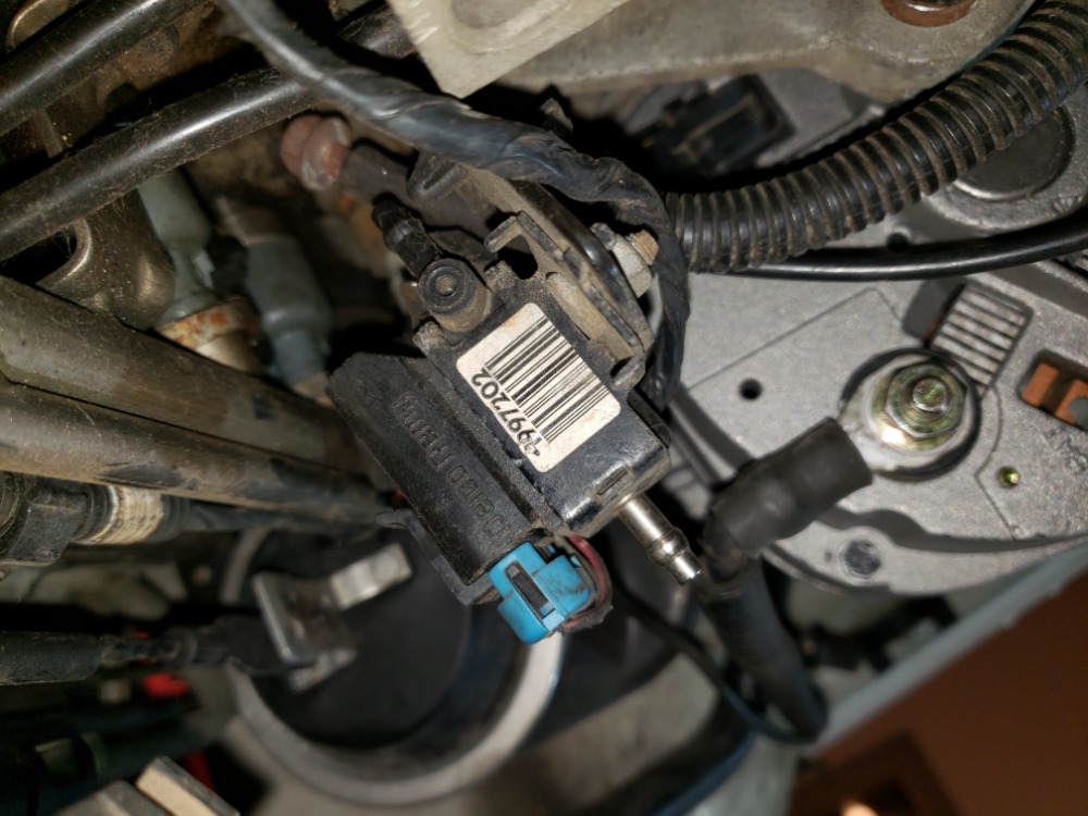

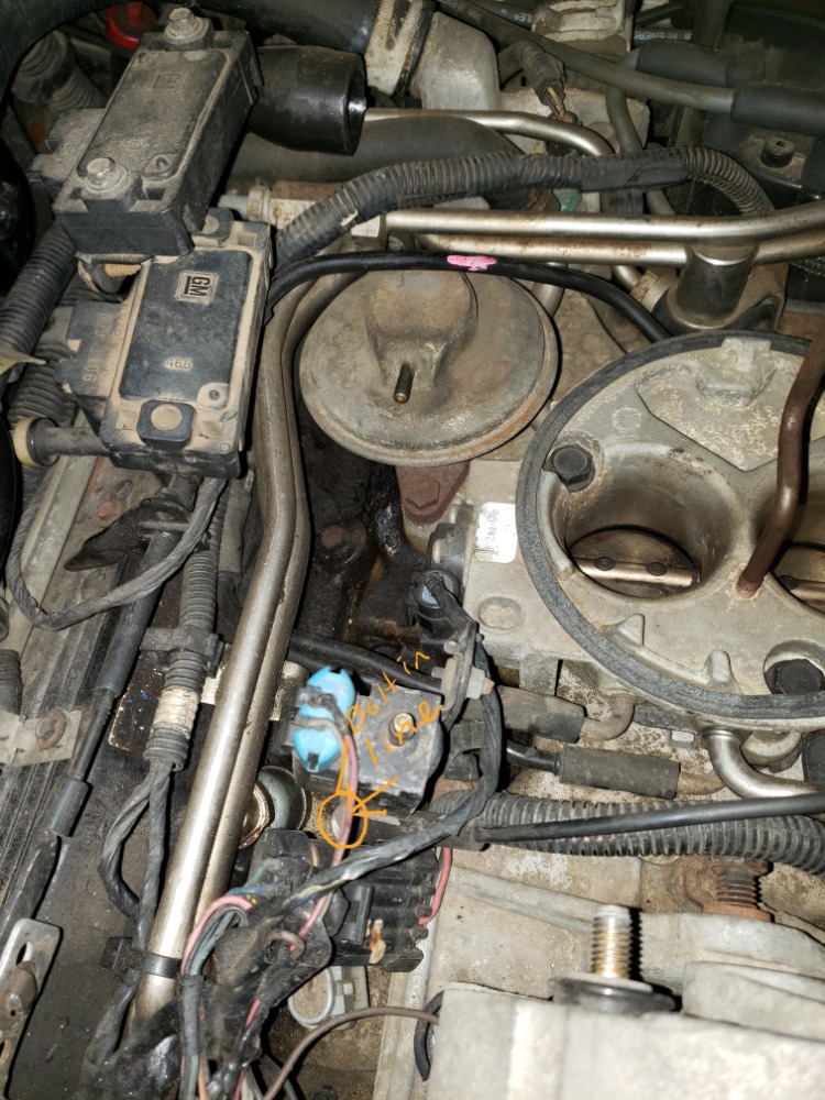

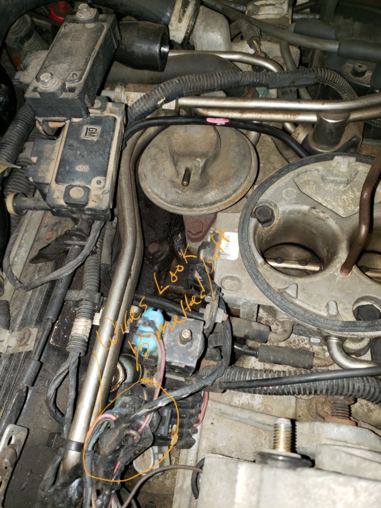

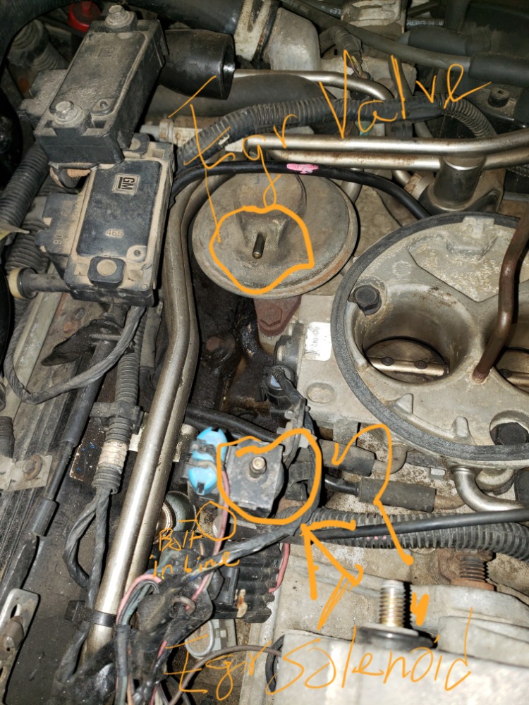

7 years 7 months ago #27805 by Dtnel

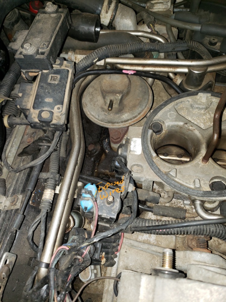

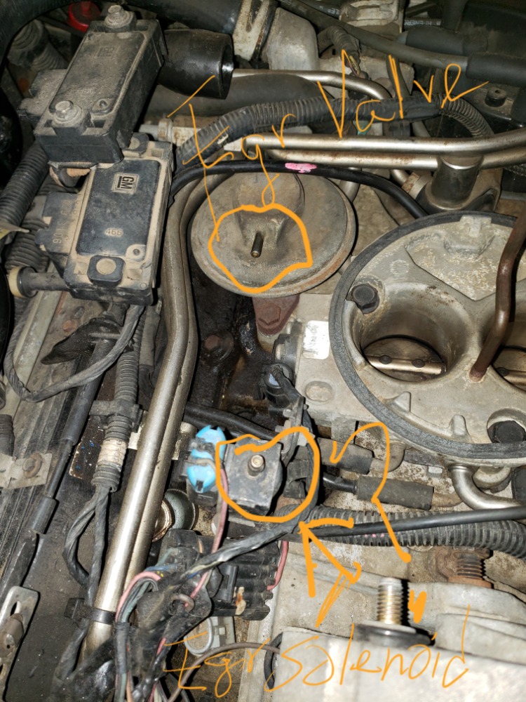

This Deville has the 4.9 Engine, it's not the Northstar engine.
Runs rough the more you accelerate according to my friend who's been driving it as it's his older mother's car a shop put all new injectors in recently but I don't get their reasoning except either $$$ or the parts cannon as I was looking at it less than 5 minutes and noticed the EGR and EGR solenoid appeared to have had a line in the past that went to them, maybe from the solenoid to the valve?
On these engines is there a way to use a vacuum pump to test the EGR valve? I haven't did EGR work thus far but I do have a vacuum pump with gauge, multimeter and labscope. I'm sure there's got to be a way to check the electrical on the solenoid and check the EGR valve test wise and visual inspection?
The guy did say there's a strong odor of gas as well and the higher the speed the more it seems to stumble when it does. I briefly looked at this one a year or so ago but then the vehicle was gone as he got another one to drive but I don't think that'll be the case this time as on his Ford Ranger he cracked the number 3 piston which they tried to tell me he needed a starter replacement on but I found the starter was operating just fine after removing and bench testing it and back on the vehicle as well.
Also there's another line, maybe vacuum type or something that goes 4-5 inches and has a bolt in it and does nowhere.
I will add photos as those are the best evidence. I haven't pulled any codes yet as he was so sure he wanted his alternator replaced and his blower motor that he went and bought the parts and they were there. He was even pissed enough that he took a drill and drilled a 3/16 hole right into the blower motor back side because he was pissed that it quit working. I don't understand some people's logic but this is a special type of person so I just go with the flow at times as I'm just trying to help a friend out and sometimes he realizes that he screwed up we will see once I get the vehicle running again as I change the alternator already and I'm winning to get this blower motor wrapped up. In the meantime while doing the blower motor I noticed these other things I was also doing alternator when I noticed them as well.
Please see the attached pictures and you will see what I am referring to.
Oh, I might want to add I pulled the dipstick for the oil and there's no oil level reading but he does want me to change the oil on it so I'm thinking about pulling the plug for him because I'm curious to see what I will find inside the drain pan. It's kind of like that mystery meat you get at McDonald's or Arby's and you just kind of wonder about.

7 years 7 months ago #27830 by wacoeagle
EGR probably disconnected because its bad., if its leaking air into the engine could be a problem . you can take it off and make a block off plate out of an aluminum can to seal it off. ... those melted looking wires might go to the coolant temp sensor, if the coolant temp sensor thinks the engine is running cold it gives too much fuel!!! look for any vacuum leaks you can find and fix them. a coolant thermostat sticking open can fool the coolant sensor too.
carburetor clean those throttle butter flies.

7 years 7 months ago #27833 by wacoeagle
think of an EGR system as an engine parasite. it does NOTHING to make the engine run better. all it does is when engine gets to higher speeds, it opens a portal from the exhaust system, sucks some of the ALREADY BURNED fumes from the exhaust, and routes them back into the intake system of the car to try and reburn any unburned fuel, (which doesnt exist).. this was a big bullshit the car manufactures did to try and apppease govt tree huggers in the 80s. its like this.. you are a jogger and run behind a line of big diesel trucks trying to breathe, and you have to breathe all of thier exhaust gas.. EGR = engine getting robbed!!
An engine likes oxygen rich air to burn with fuel , not already burned fumes. some would argue you get better gas mileage with EGR, I never saw any proof of that. if u make a block off plate and forget abt it thats one less problem your going to ever have to worry abt on the car.. just my opinion. some states u might fail emissions if they see it.
