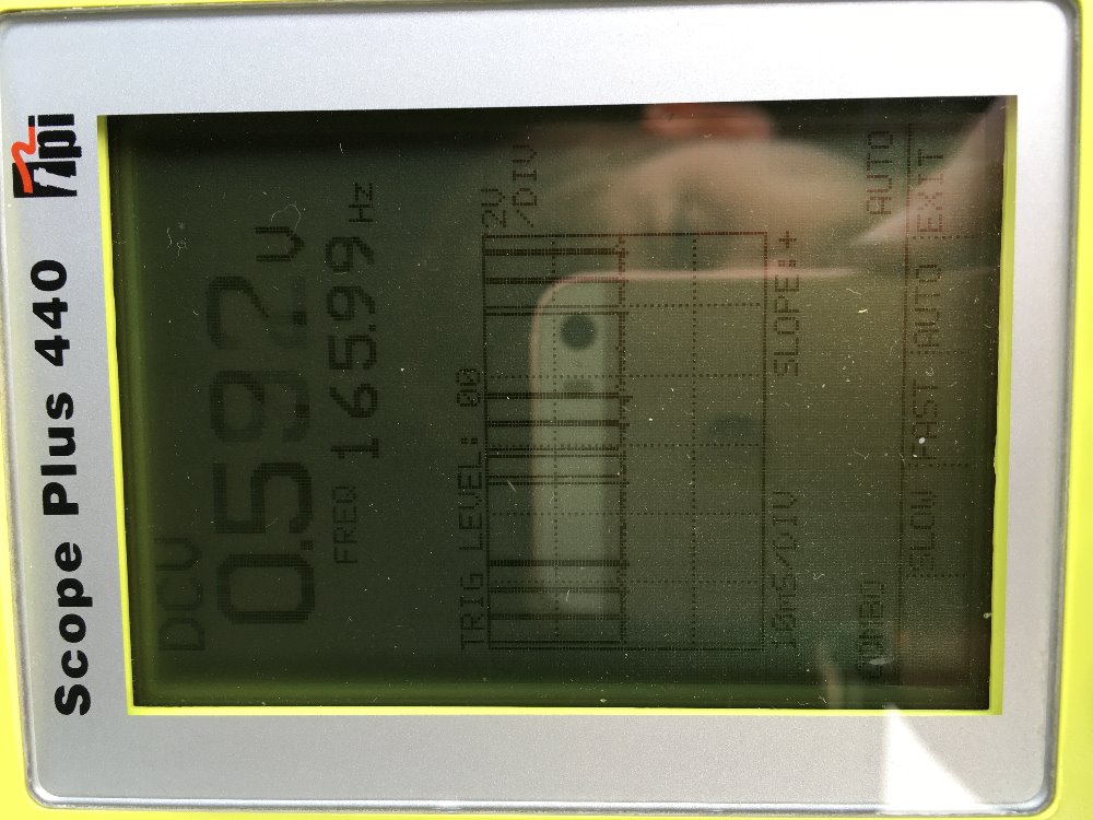

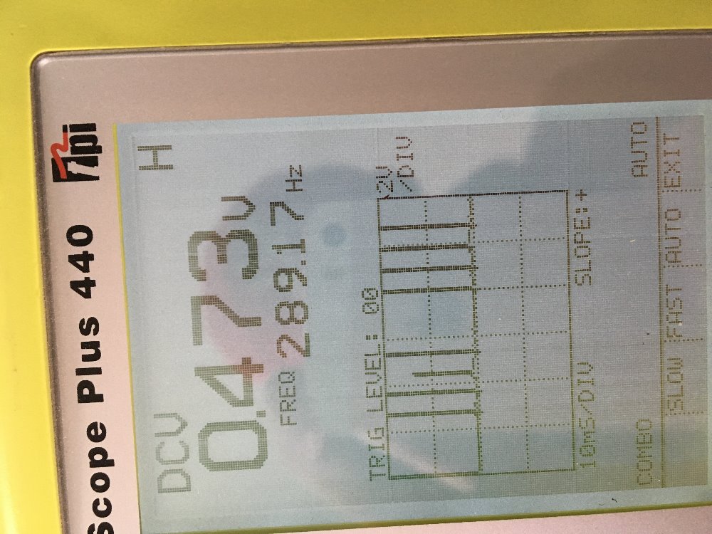

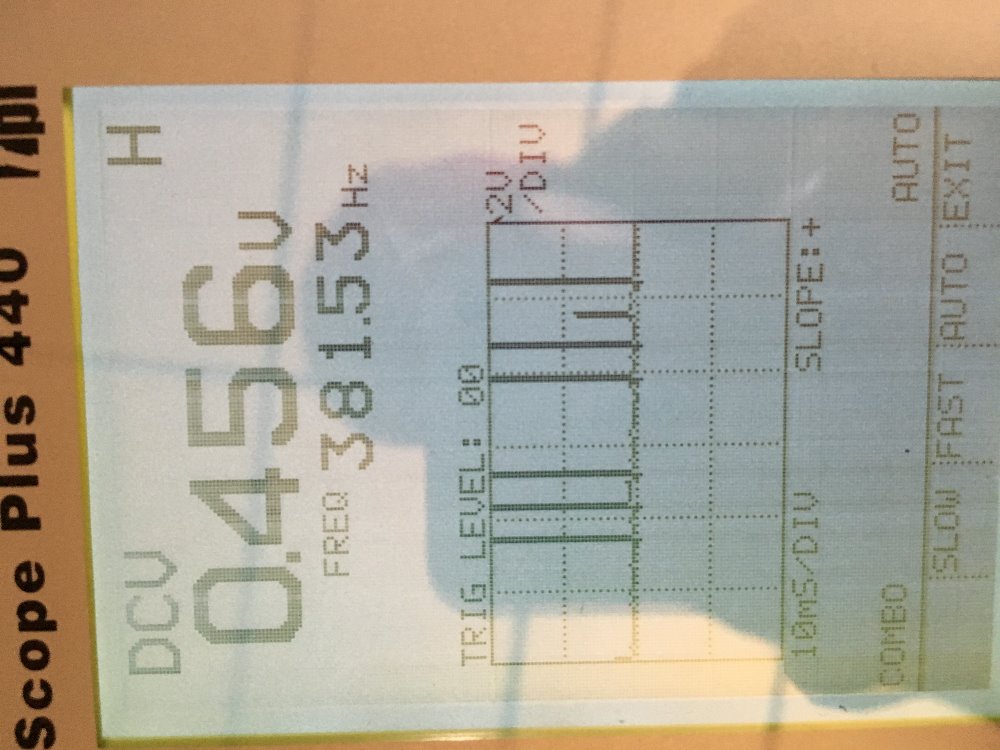

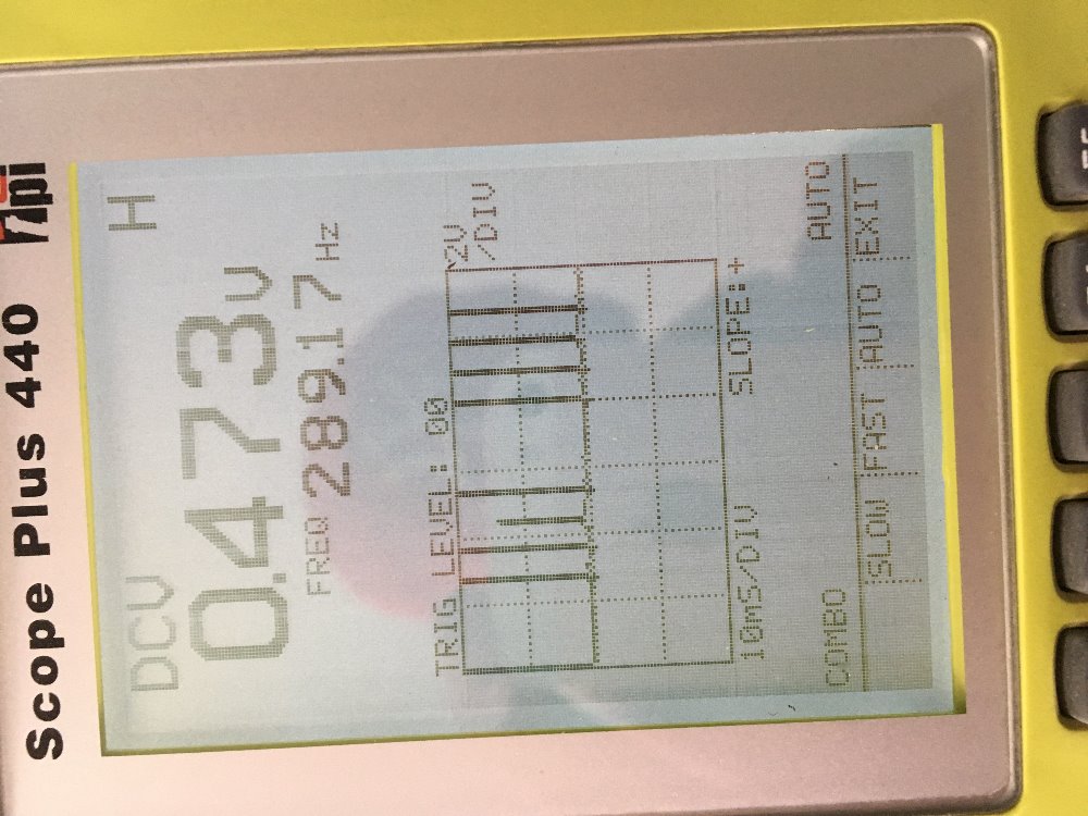

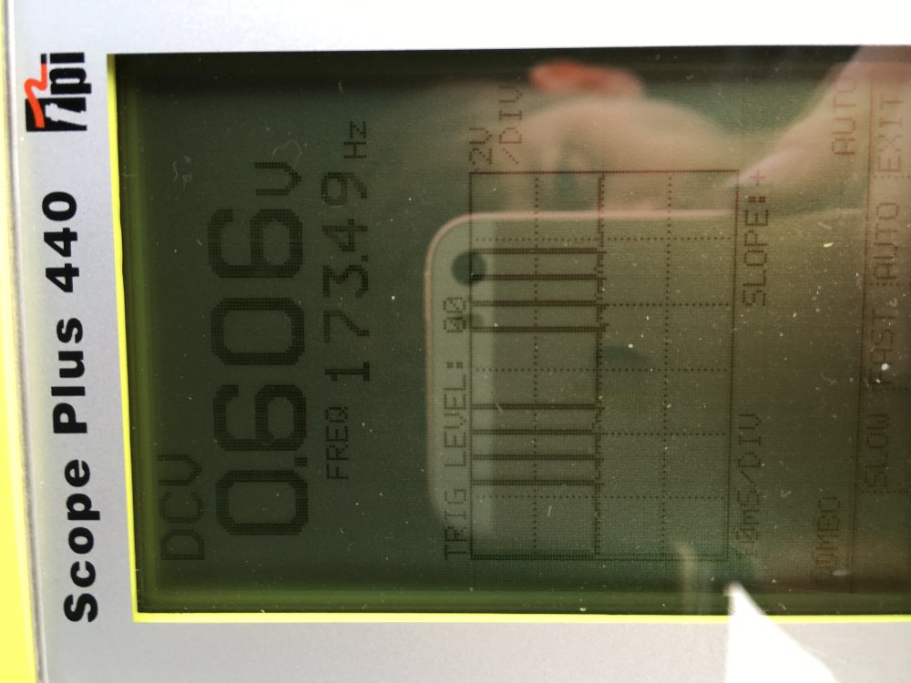

is my crank sensor going bad. this is what my scope meter shows. some 3 lines some half line some are four lines like they are suppose to be. my jeep has a stalling problem an has a little miss. here are some photographs of what they look like. ]

What you're seeing there could be a sampling rate issue. As in, the scope you're using isn't quite fast enough to pick up every pulse of the crank sensor. If possible, change the time base to something faster. Maybe 5ms/div.
If the missing pulses remain, then there's still other possibilities. Damage to the flexplate is one, usually due to someone using the crank sensor windows as pry points to turn the engine over while removing/installing torque converter bolts. This'll usually result in a waveform glitch that's repeatable.
Air gap is another, especially if the crank sensor has been removed and installed recently.
Lastly, weird as it sounds, but a malfunctioning alternator can cause glitches in the crank sensor waveform. :silly: Easiest way to eliminate this is to disconnect the alternator and recheck the waveform.

just to give you some more info. I swap my motor like 4-5 years ago. never had a problem with it stalling till now. I even pulled my crank sensor before ever pulling the engine. so I did not break it from separating the engine from the bellhousing. I did not use the flex plate to rotate the engine to remove the torque convertor bolts. I had someone rotate the engine by using the crankshaft pulley bolt. I have never touched this sensor since putting the engine in. if I increase my time base on my scope its hard to read the signal. on another note I do get some that are four but most are 3. I even increased my time base to 5ms then I rev the engine an I still got mostly 3 lines. my frequency even went up when I rev the engine. so my scope saw that the engine speed did change that's what I am thinking. "hope this info help"

crank position sensor was bad after all. my scope was able to see it was bad. when I replaced it with a duralast crank position sensor my scope was able to show groups of 4. "problem fixed"
