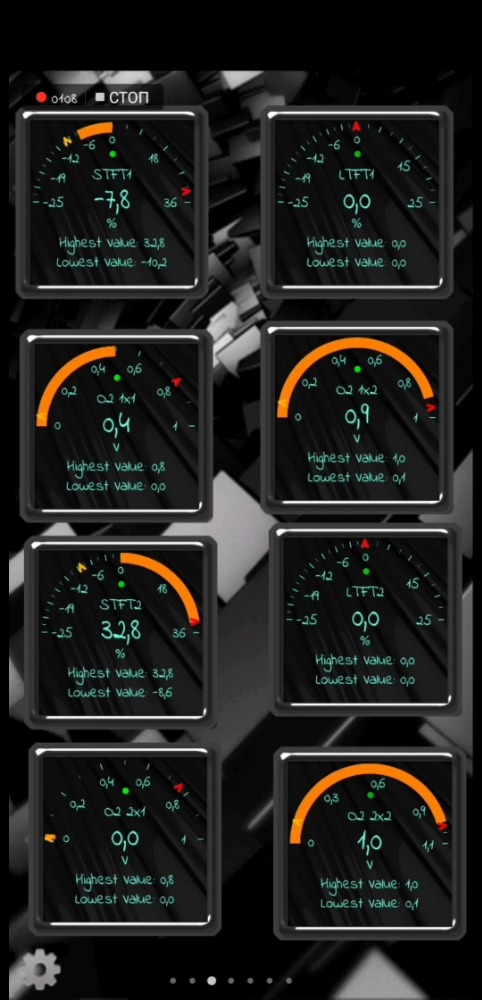

7 years 7 months ago #28223 by dundy
Yes I would be very grateful
7 years 7 months ago #28269 by Tyler
dundy wrote: There is a lack of power while driving. There is a break in the engine. I forgot to say the fuel filter was changed. Long term change Little when moving
I think a fuel pressure test is your next best move. If at all possible, rig the gauge onto the windshield so you can monitor the fuel pressure during a test drive.
I'm not positive what the specification is, but I seem to remember 40 PSI. :unsure: If it's low at idle and gets lower under load, you're on the right track for a fuel delivery issue.
7 years 7 months ago #28278 by dundy
I cleaned the petrol injectors a day Ago. And I noticed something strange when running O2 sensor Bank 2 drops to 0 volts and remains so. Long End short trim is rising to 32%. As on bank 2 The lower sensor changes the indicators from 0% to 32%, and the top does not move from 32%. After the test the revolutions ranged from 670 to 580. A before the test were stable at 660
