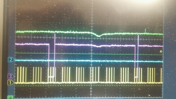

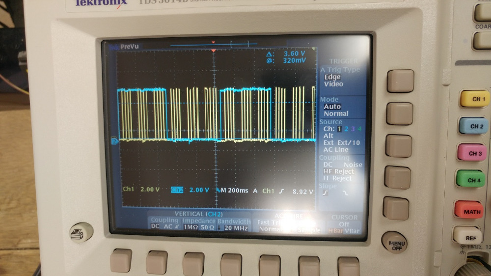

I'm out of ideas and looking for help. I have a 2000 Jeep Cherokee that was gifted to me with the 4.0L Inline 6 motor removed (engine ran fine before removal) and all the components for a 4.6L stroker. I had the block machined and I assembled everything in the garage. I've spent many weeks checking and double checking everything I can think of to check but the Jeep won't start. The 2000 Cherokee uses one coil rail over all 6 plugs so I don't have plug wires I can connect sensors onto. The coil rail is known good because I swapped the rail from my other working Jeep into the project.
I checked compression on all 6 cylinders and they were all within 105-120 psi (new machined block, pistons, and rings). I have checked the cam alignment with TDC of cylinder 1 on the compression stroke and it's aligned mechanically. I also used the scope to check the alignment of the cam and crank sensors, they look good (Cam Crank.jpg) to me. Measurements taken by back probing at the PCM connector. Yellow is the crank sensor and blue is the cam sensor.
At that time the crank sensor was a new cheap parts store sensor. That resulted in the large pulse once every 3rd set and caused spark to be erratic and timing off (Bad Spark.jpg). Again, all measurements taken by back probing at the PCM connectors. Yellow is the crank sensor and the other 3 signals are the PCM outputs to coils 1, 2, and 3. As seen, spark is out of time.
After reading a similar issue with the crank signal on this forum I replaced the crank sensor with a Mopar sensor. The stronger magnet cleaned up the signal (Good Spark.jpg). I look at that and assume the spark event happens at each one of those positive voltage spikes. Since the trailing edge of the 4th crank pulse corresponds to 4* before TDC, that appears to be properly timed. With hope the Jeep would start we installed fuel relay, cranked, and it still failed to start.
Thinking spark is good we moved onto fuel. We tried spraying a little starter fluid into the engine and it didn't start. We measured the injector pulses of the 6 cylinders along with the coil output from the PCM (Injector 1-6.jpg)(Injector 2-5.jpg). We did it for all 3 sets but I only took pictures of the first 2 sets. The last set not pictured look the same as injectors 2 and 5. I believe the probe on the "Injector 1-6.jpg" picture wasn't properly seated on that crank, later the coil signal was back to as shown in the other pictures (what I believe is normal). I believe the injectors "fire" when the PCM pulls the voltage down to 0. Looking at the injector pulses and they appear to be timed a little over 360* out of phase with spark for that cylinder. That would correspond to a little before the intake stroke and in my mind that's correct.
So I'm looking at an engine that has decent compression, correct spark timing from the PCM, and correct injector timing from the PCM. But the engine fails to start. The next through was that the PCM is sending out good signals but that doesn't mean it's actually sparking or injecting fuel. Pulled the coil rail and plugs from the Jeep to find all plugs completely coated in fuel. Not good for spark but tells me the injectors are actually firing. With the rail off the block but electrically connected, plugged in all 6 new plugs, connected a wire to ground each one, and cranked the engine. All 6 plugs spark fire in pairs and appear good. As I see it has spark that's timed and injectors spraying at the right time. Even with brand new plugs installed, it still fails to start. Any ideas or help is appreciated because I'm out of ideas.

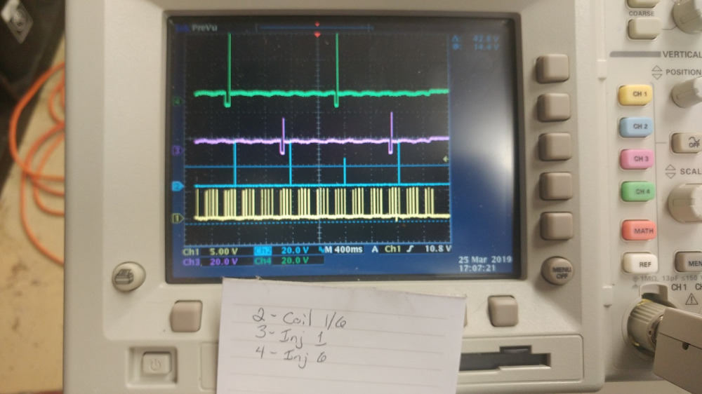

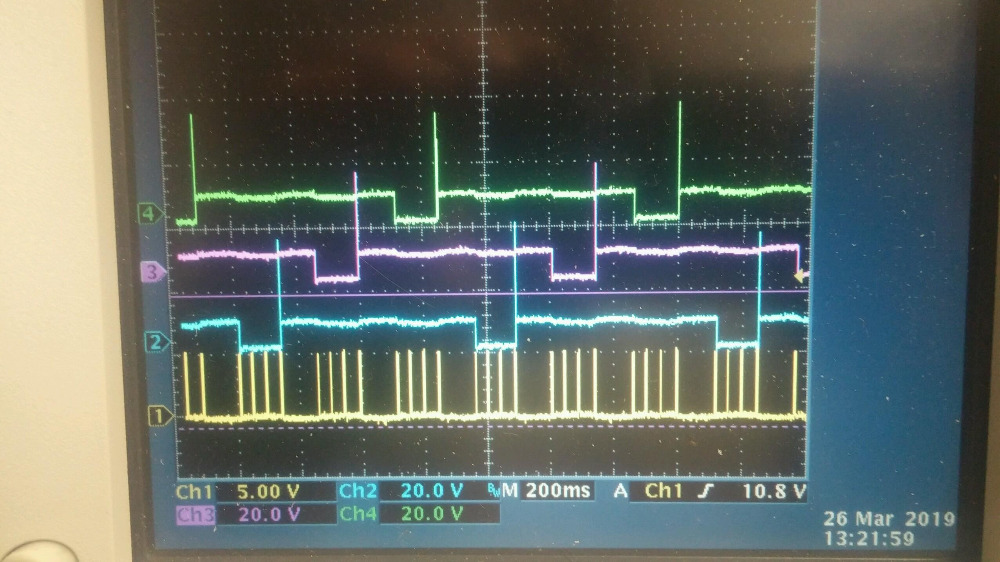

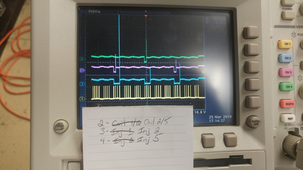

7 years 7 months ago #28329 by JeepMe
Replied by JeepMe on topic 2000 Cherokee Crank but no Start
guafa wrote: I still don't have amp clamp, then i pick up signal from battery voltage drops knowing that voltage is inverse to current, then you should observe valleys instead of humps.
You can also pick up secondary ignition signal from a in plug coil system by turning a wire around plug cap (4 turns is enough) and the proper attenauted lead probe.
About back pressure, (after cat means cat is plugged?) you must unplug cat (is this the one which gets clogged). Also you can just unplug upstream O2 sensor.
While I only had plug 1 installed I picked up battery voltage, crank sensor output, injector 1, and coil 1. I didn't get a picture with all channels properly connected but everything seemed to correspond where I think it should fall (I also don't have a known good signal so I'm just going off what I think makes logical sense). The attached file shows the battery voltage (green), crank sensor (yellow), injector 1 (purple), and coil 1 was supposed to be blue but I didn't have the probe in the connector far enough. Once I did get a good connection it was the same signal shape as posted earlier and the rise from 0V to 12V corresponded to the dip in battery voltage.
What I'm seeing is spark happening at maximum compression and injector firing a little over 1 crank revolution before spark/max compression. When thinking about it, I believe that's properly timed.

7 years 7 months ago #28333 by guafa
Replied by guafa on topic 2000 Cherokee Crank but no Start
Hi JeepMe.
My understand is you should see at TDC a falling edge (12v to 0v) in primary ignition control line. That is the point where driver ends coil charge.
I'm going to study a little bit more circuit and let you know.
Just let's wait until expert guys here second my opinion.

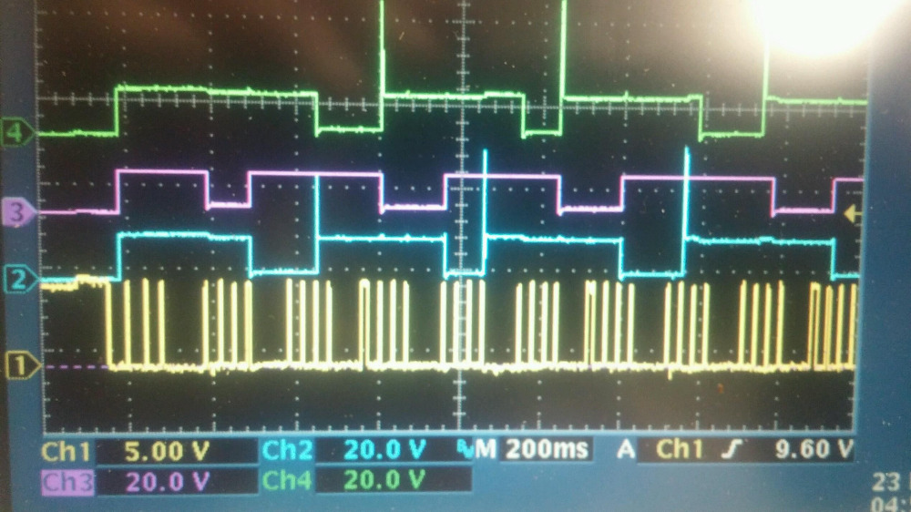

  • JeepMe
  • JeepMe's Avatar Topic Author
7 years 7 months ago #28339 by JeepMe
guafa wrote: Hi JeepMe.
Here is my thoughts and what I've worked out (not saying it's correct, just my thoughts).
I'm taking readings at the PCM connector. The circuit goes from battery to the coil rail (there's one 12V line on the connector). Inside the rail that line splits to the 3 coils, positive side. The negative of each coil goes out the connector and to the PCM. Essential the PCM is a switch on the ground side of the circuit.
With the key in the on position the coil rail is getting a constant 12V through the 12V line on the connector. That 12V potential stays on the wire through the coil and to the PCM. But the PCM is acting as an open switch so there's no ground path, an incomplete circuit, and no current is flowing. So without a ground path, the pin at the PCM should read 12V (but if you were to measure current it's 0A).
But when the PCM closes the switch, that pin drops to 0V since it's shorted to ground. Now that there's a complete circuit there's 12V into the coil rail, the coil provides the resistance of the circuit so one side is 12V and the other is 0V. The ground side leaves the rail, goes to the PCM where it's been connected to ground. With a complete circuit, current is flowing and the magnetic field in the primary coil builds.
Once the PCM switches from a closed switch back to open, the circuit is no longer complete and current stops flowing. The pin at the PCM jumps to 12V just like in the original paragraph. But once current in the primary stops, the field collapses in the primary, builds the secondary, and then discharges through the spark plug. So spark ocurrs when the voltage of the primary coil (when measured at the PCM) jumps from 0V to 12V.
  • juergen.scholl
  • juergen.scholl's Avatar
  • Active partschanger
7 years 7 months ago - 7 years 7 months ago #28341 by juergen.scholl
Replied by juergen.scholl on topic 2000 Cherokee Crank but no Start
Jeepme,
something IS wrong with your engine. You have to do some CONCLUSIVE testing in order to discard or confirm problems.
For example on the ignition side: How good is your spark? What's the amperage the coils consume, will the spark jump a gap that requires 20 kv? It's not good enough just "to have spark"....
A plugged exhaust still is a possibility (you say exhaust was cut AFTER the cat), what does the map sensor show while cranking, any change at all ?
70 rpm while cranking is a very low reading it should be at least 150, better 200ish with a good starter and a well charged battery? Does the engine spin freely or could something be binding?
Your Bluetooth scanner and the torque app will provide enough data to assist you a long way in this diagnostic quest, you just have to test at crucial points, not guess.
HTH

7 years 7 months ago #28342 by juergen.scholl
JeepMe wrote: So spark ocurrs when the voltage of the primary coil (when measured at the PCM) jumps from 0V to 12V.
That's right!

7 years 7 months ago #28343 by juergen.scholl
guafa wrote: Hi
That's wrong!
The falling edge shows the beginning of the coil charging, primary circuit is now completed, current starts to flow and the magnetic field is built up. As soon as the ground is removed from the primary, the inductive kick - or flyback voltage - indicates the collapse of the magnetic field and this is when the spark actually occurs.
7 years 7 months ago #28344 by guafa
Nice!! I'm clear now. Thanks.
That means for me that with all signal synchronized and withfuel in cylinders, you have a breathing issue.
