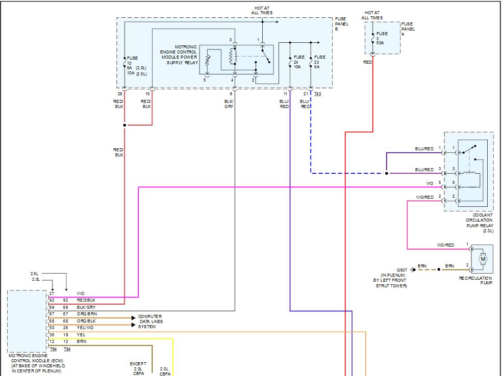

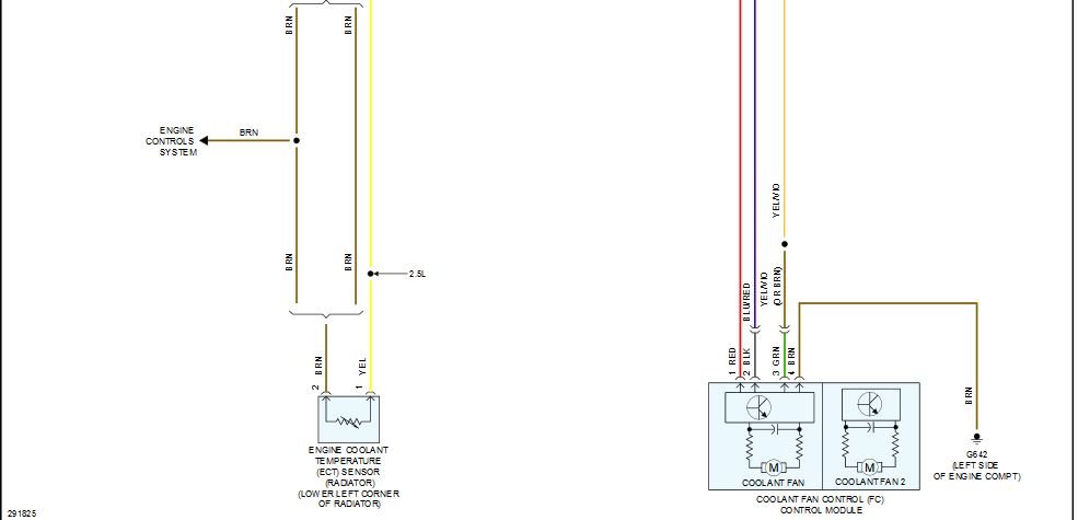

With this code I would check the connection to the cooling fan.
When you say you supplied power to the fan was that both power and ground? or just ground?
According to the wiring diagrams there are 4 wires that run to it.
Yellow/Violet = ECM should
Blue/Red = 10A fuse 24 on panel B which also runs to a relay back to ECM relay
Red = 50A fuse 3 panel A
Check all 3 of the above for voltage using the brown wire as your ground in the 4 pin connector. The Yellow/Violet wire should be checked with the engine warmed up. Then check the above 3 wires with a good known ground.
Brown = ground
Brown = ground

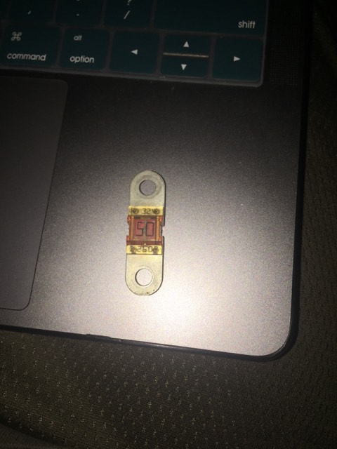

Thank you to everyone who replied. Sorry that it has taken me a while to reply. So I think I found the culprit. It is a 50amp fuse(strip) that is on the fuse box next to the battery. I have attached a pic.
I used a test light at the connection to the radiator fans. The test light did not light up. So I verified that it was attached to the negative post of the battery and tested it with my starter. The test light lit up. So my test light works. I tried testing again at the connection and nothing.
So I went to the fuse box and check that I was getting power at the fuses and the test light did not light when I checked the bottom post of the fuse strip. Then I took it off of the fuse box and visually inspected it. And thats when I saw a crack on the filament inside the fuse.
I don't believe my local auto parts store carries this type of fuse link so I will have to order it online and I am hoping that it resolves this problem.
